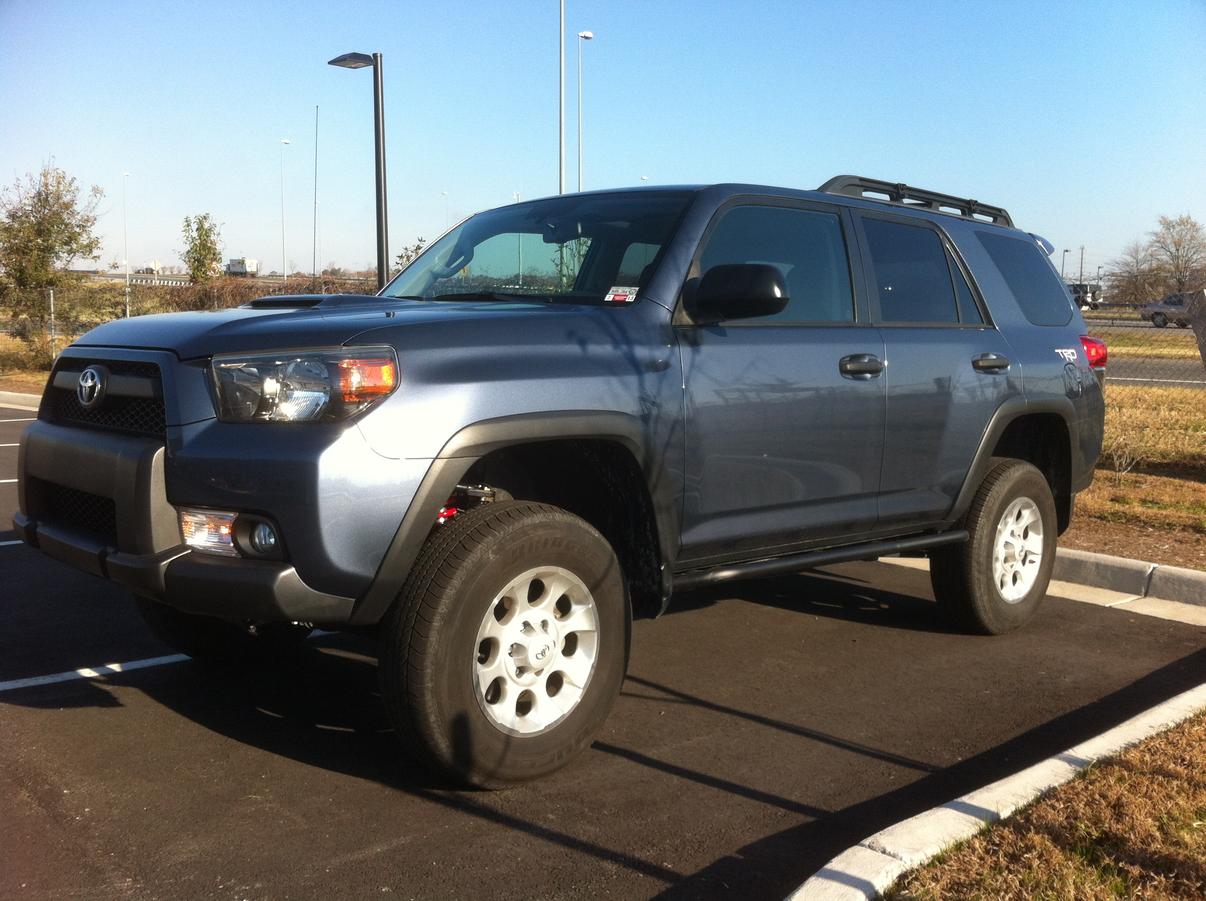

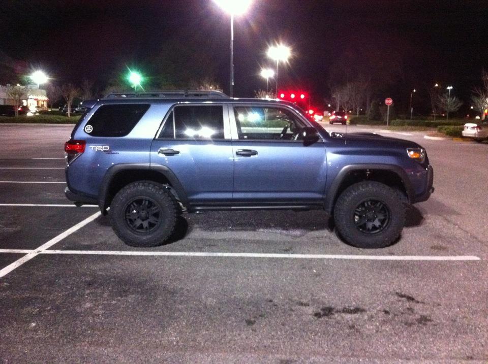

Got a couple of quick pics. Will get a few more with a better camera then my IPhone when I get the wheels and tires next week.

Trucks looking good. Real good! Did you go with the beefy sliders? And why did you decide on the Warn VR8000s? I'm thinking M8000s but am open to suggestions.
I have the ultra gauntlets and the same lift setup. to avoid rubbing at the back of the front wheels I had to set the camber to 4...that should be the max. You are going to like this setup, it looks and rides great.
I think you meant to say you had the CASTER set to 4,not the camber.Camber should be set to 0 or pretty danged close.Some put .3-.5 total difference to compensate for the crown in the road or some BS.

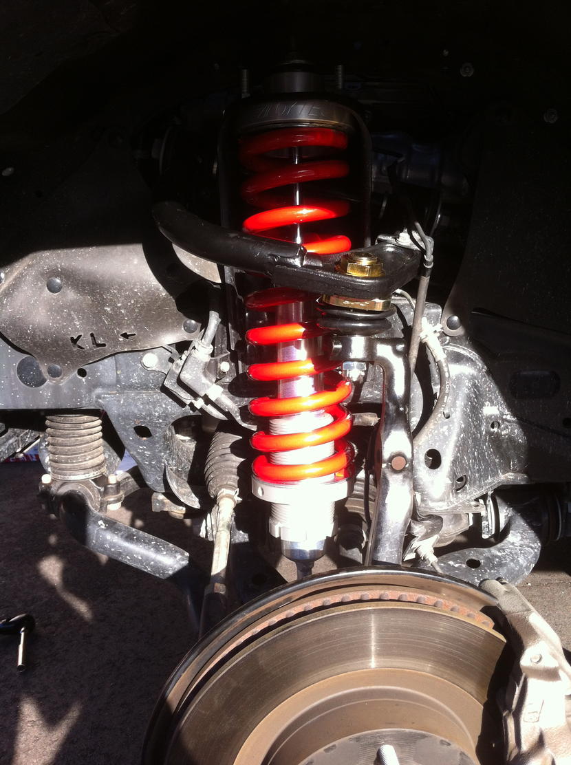

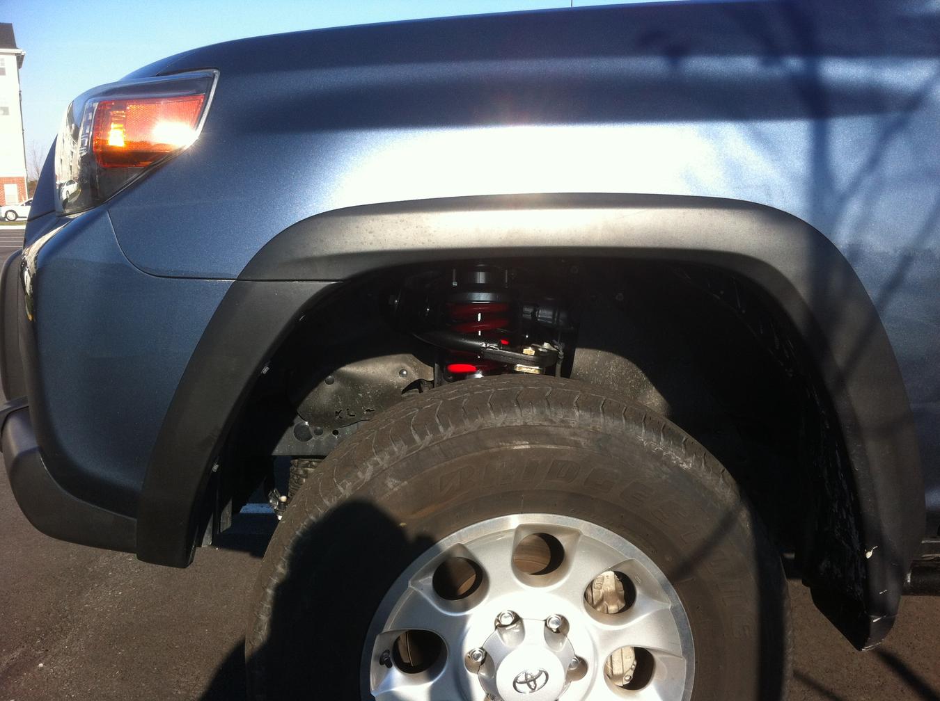

Installed the lift today. Got to say I am happy as a pig in $&!t. I am 6'5" and I have to hop up in. I will take some pics tomorrow was to dark when I finished. Now the wait till Monday for the tires and wheels to come in.
Got a question to those that have the Toytec ultimate lift with the light UCA's. What position did you put your ball joint and where on the slide on top did you set it.
You have the LR UCA's positioned correct(zero,SPC logo out) from the pics you posted . With it set a 0 it still has 2 more degrees built in then stock UCA'S.The top ball joint nut slides in and out and about 1/4"-3/8"s inward gets you in the ball park for camber before the actual alignment form a shop.

Looks good man. How was the install? I am planning on doing mine myself once I pull the trigger on the lift.
It was not to bad. I did it myself in about 5 hrs. The front gave me the most trouble when putting the sway bar back on... that damn KDSS... But not to bad.

Got the Wheels and tires put on. Here is a teaser pick for now. I freakin love the way it looks.
