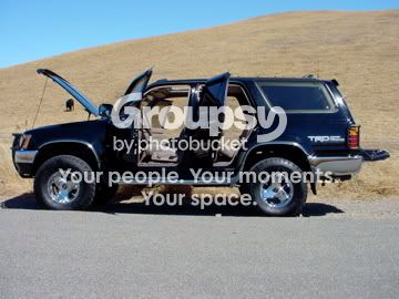

I upped that to 32s when I did my first tire change at close to 50k. Can't say for sure how that affected my mileage as I never did a comparison. The larger tires just fill the wheel well better.
Heres an old pic. New wheels & tires coming before the end of the year.
DSC00095.jpg~original
