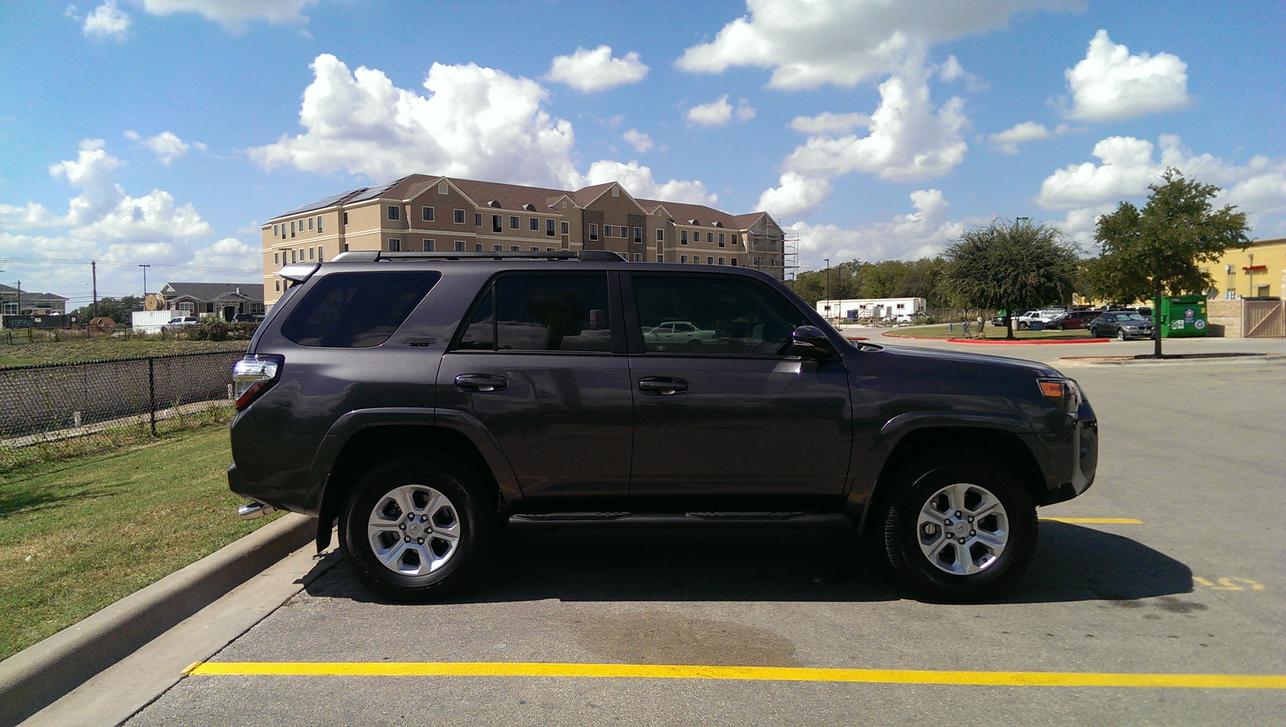

New to the forum and looking for other 2wheelers out there that have lifted their trucks.
After reading all the threads and seeing the 4x4s, I felt like I am the only 2wd. My 4Runner is more leveled now that I added the bilsteins front and rear.
I'm not sure which road I should take. I like the setup that most 4X4 guys are doing to get the 3'' lift but, if I go with the spindle lift then I can get a little bit taller tire under it. I very rarely take mine off road unless its to and from hunting spots. 4wd is not required for any of the ''off roading'' that I do. I really think I'm going to do the spindles with 5100's all around and all pro cprings for the rear. It sure does seem lonely out here for us 2wd guys. LOL

That looks good man. And don't worry you are not the only 2wd on here. But this place is a wealth of knowledge for any 4Runner owner, 2wd or 4wd. And welcome!

Looks great man! How much rubbing did you run into with that setup? Looking at yours, I dont think I need to go with the full 6'' from rough country now. Yours has the stance that I'm looking for. And did you need the wheel spacers or did the spindles push the wheels out far enough. Thanks for the reply man.

Thanks! I only had some minor rubbing... had to push fender liners forward, remove front mudflaps, and trim the front bumper just a little bit. No wheel spacers; my wheels have a 4.75 backspace and the spindles push each wheel out an additional .75"
