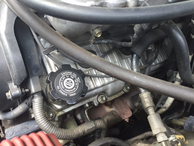

I'm planning on tackling this on Saturday. PO must have also replaced them because the driver's side VC has a cracked lobe. In the pics, you can see the cracked lobe just below the oil fill cap; it's cover in JB weld or something. Fortunately, I found a VC at the local pull-a-part for $11! However, it doesn't have the raised fins, like the VC that is currently on my vehicle. I have a 2000 4Runner and I pulled the new VC off of a 96. I thought maybe it was a pre-99 thing, but in googling around it seems that even the older 3rd gens have the raised fins. However, I did see a pic of 95 Tacoma engine bay (with a 3.4L) and the VC has no fins.
Any thoughts? I'm planning on using the pulled VC unless someone has a strong objection to it.

Oliver,
I can't say 100% but it should work. Take off the old VC and not only make sure the holes line up but that the valve covers are the same depth.
Ultra Black takes time to dry but you should be OK. I like Ultra Grey myself.
Torque the bolts to 53 in/lbs.

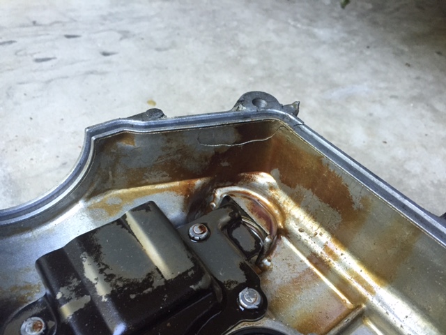

Also, here's a pic of the cracked valve cover. PO must have went out thinking he'd stop the leak by tightening the cover bolts. And he must have REALLY tightened them!
