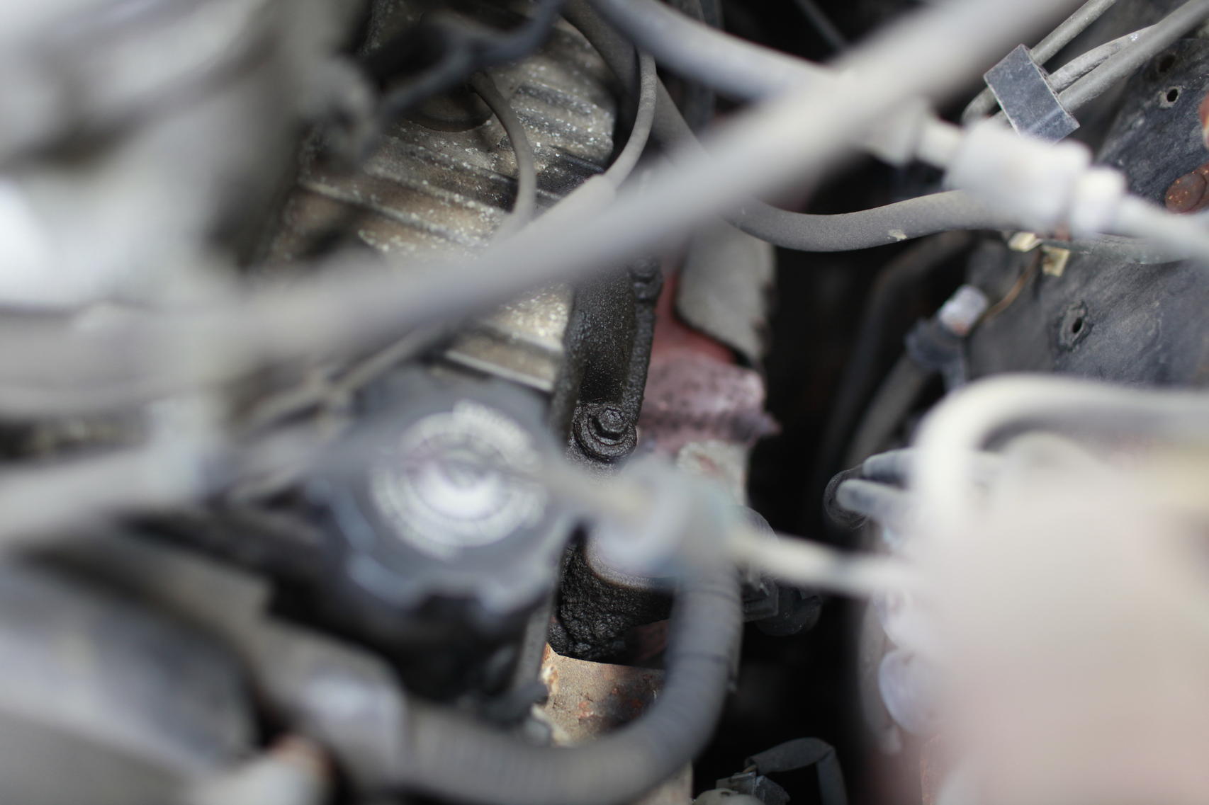

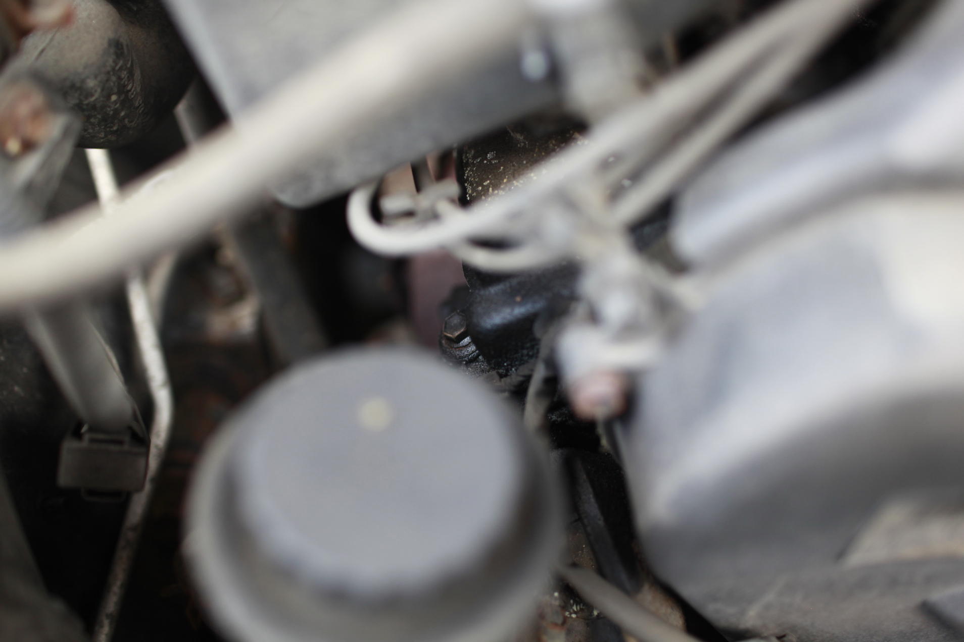

Thanks so much for this thread! Looks like this will be the first job I tackle on her as I'm 76.66% (repeating of course) this oil leak is from the VCG as it wraps around from these points down the sides (188k, original VCG):
Should aim to plugs "while I'm in there" at 188k as well?
