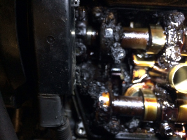

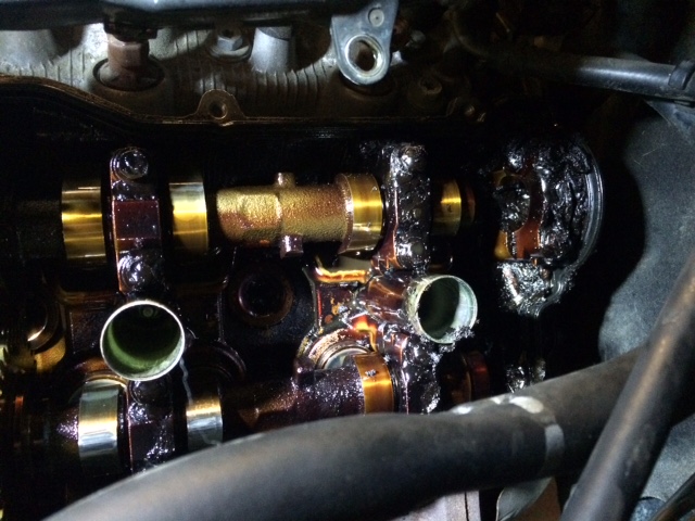

Did my valve gaskets today. Here's what my engine looked like when I took the covers off. Looks like the previous owner hadn't done an oil change in a few years. Air filter looked just as bad.
That's a bummer. When I took my covers off, I was afraid I was going to see a ton of sludge but the previous owners must have done regular oil changes on my truck because there was no sludge to be seen. Changing the oil on a regular basis is the single best way to give your engine a longer life. I don't understand how people can abuse their vehicles like this.
I'm just glad I didn't take the 4R to the dealership to do the work. They would have either charged me a ridiculous amount or not done anything inside the engine and just left it. It sucks that it's that bad, but at least it's getting fixed and should be good to go soon.
I plan on driving on it for a few weeks with some Royal Purple in it and then I'll change it again. Hopefully that clears up anything they weren't able to get.
This'll be a brand new 4Runner by the time I'm done with it.
