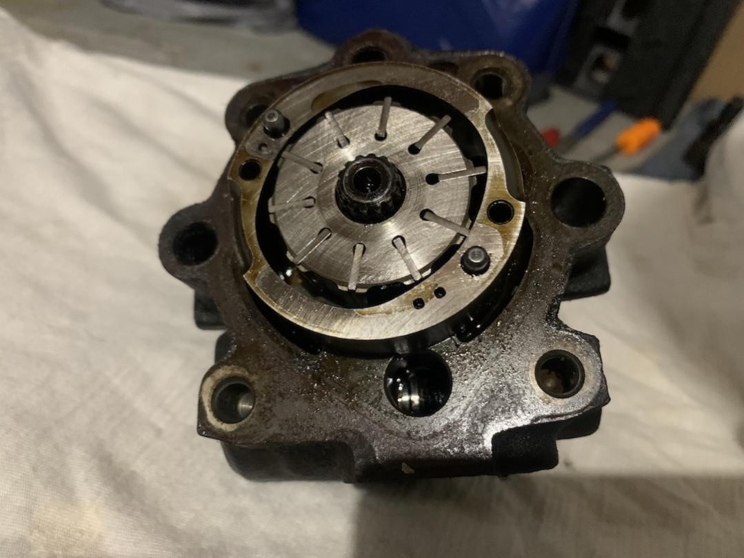

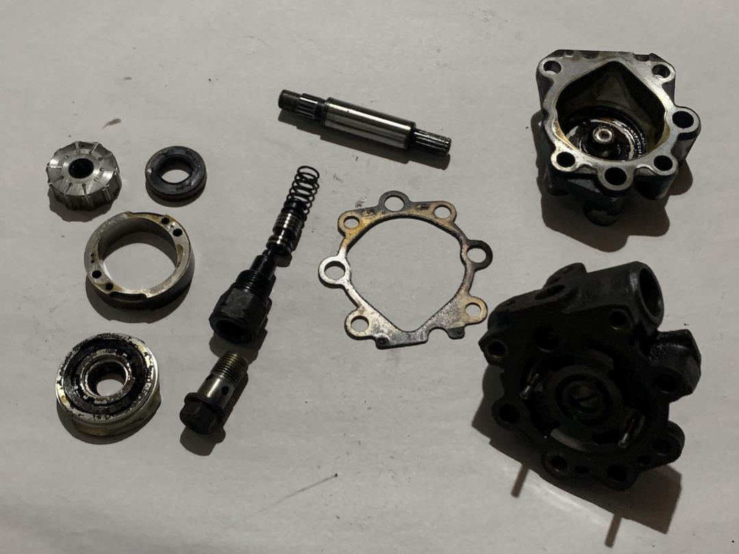

So I have the pump all torn apart ready for new seals/gaskets which are coming tomorrow (Gates 348376) and upon discovery when I was eyeing the Toyota service manual instructions on pump reassembly and looking at the inscribed marks, I actually found the rotor facing the wrong way. The service manual says to have the mark facing upward when I found it facing down. Weird but here are the pictures of it all apart.

All fixed! Rebuilt the pump yesterday and discovered o-rings dry rotted and hard. Today I jacked up the front wheels and turned the steering wheel when it was turned off and running. Following the Toyota PSP bleed procedure and on the 2nd round, all air pockets are gone. Just now topped up the reservoir to hot line and the power steering on my truck never felt great in years!
HIGHLY recommend the Gates 348376 kit to rebuild the pump. Patience is key. I think the main cause of my problem was the reservoir screen being blocked of junk. 3 cans of brake cleaner got it clean enough.
