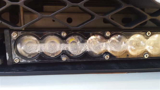

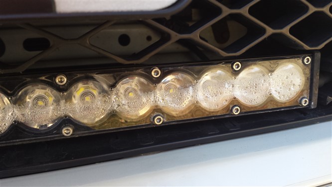

Last weekend was getting ready to head out for the day when I notice condensation in the lower 20" Stealth light bar, to say I was bummed was an understatement :puke:. Then remembered BD discontinued the Stealth line awhile back :puke:.
Upon closer inspection, noticed small cracks in lens at each mounting screw (hard to see in pictures). Possible lens became brittle over the past 4 years of use? Possible screws were overtightened ever so slightly during manufacturing, anything's possible?
I PM'ed Bailey (Baja Designs) to inquire about warranty, he responded quickly with who I needed to contact, thank you Bailey. Monday spoke with Devin @ BD, explain the situation, he informed me they had limited parts for Stealth bars (here we go). I forwarded a copy of original receipt for purchase of light bar and pictures of light bar. Devi provided an RMA, I removed light bar and packed it up to ship UPS ground.
They received yesterday, spoke to Devin today who informed me they would cover under warranty..........awesome sauce!!!!! Unfortunately, no parts were available, but they would happily swap it out for a new S8 at no charge.........awesome sauce x2!!!!
One issue that occurred to me, both my Stealth light bars have an additional wire that when applying a momentary ground dims the lights 50%, or holding ground a little longer turns on a strobe feature. The S8 does not include those features, but has a back lit LED function instead. Nice but not really interested in that at this point.
We discussed what other options were available, Devin pointed out that their OnX6 incorporates dimming and strobes............perfect! For an addition upcharge (nominal cost since it's a more expensive light), they would happily send me the OnX6.....done deal :naughty: ............. awesome sauce x3!!!!
Baja Designs offers the best light bars IMO, but what really impressed me was their customer service! Devin was friendly and easy to deal with, at no point were there any hassles or games. Could they have only offered to replace with a S8, absolutely, but they didn't. I highly recommend Baja Designs.
Wonder how some of those other companies selling LED light bars with lifetime warranties would have handled this issue?

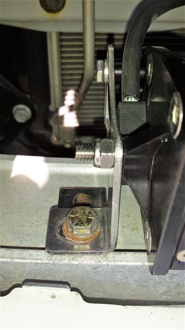

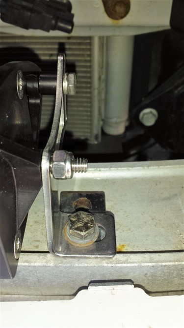

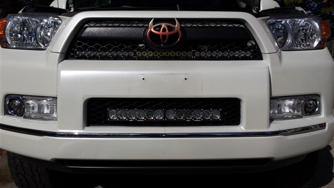

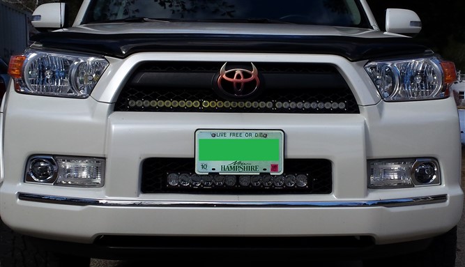

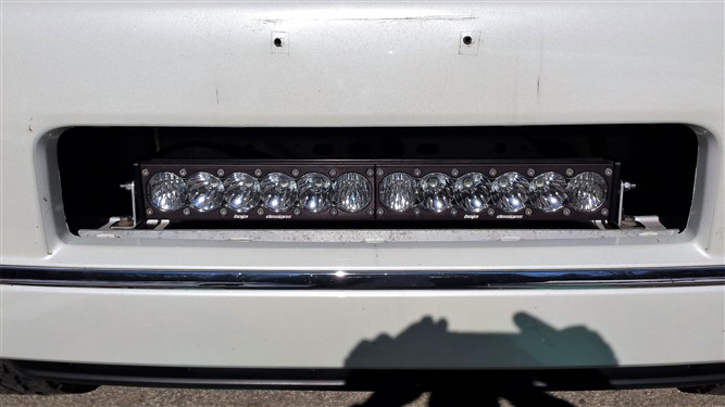

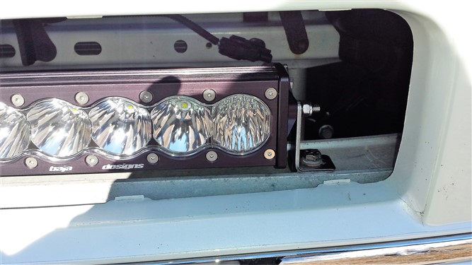

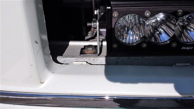

Received replacement light bar last week as promised, finally got around to installing it today. Light lined up perfectly with mounting holes so it was an easy swap. Trimmed the grille a little larger height wise to fit. Happy with how it turned out :banana:
