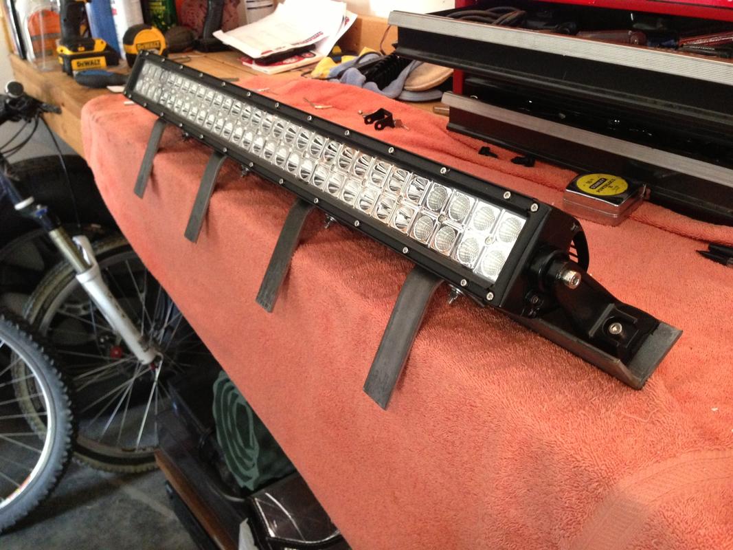

Yes that's the issue I had and why my L brackets weren't exactly 90 degrees. I have plenty of adjustments. I had planned on flipping the angle iron, but the rubber shields were already hitting and didn't want to deform them any further.

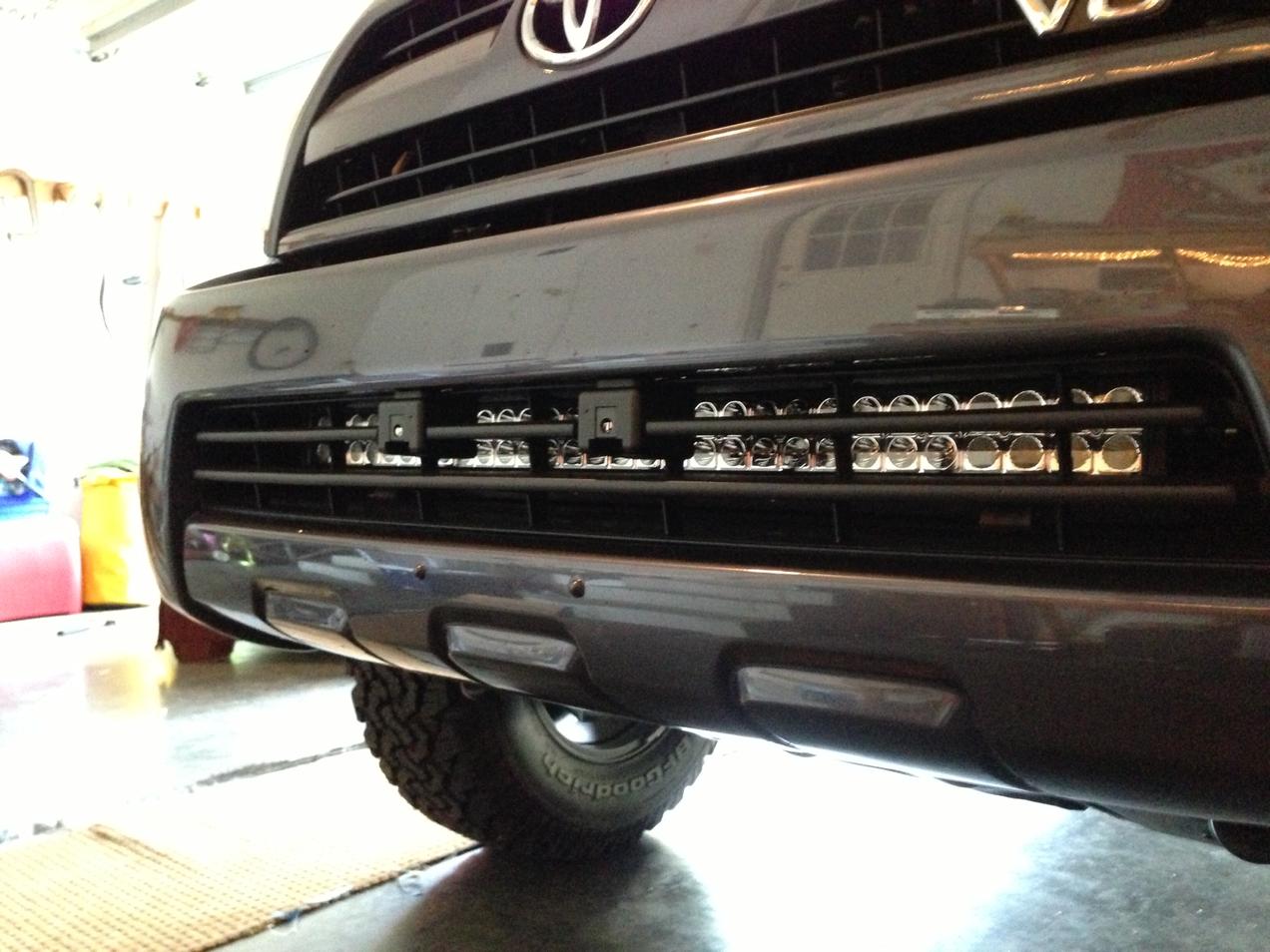

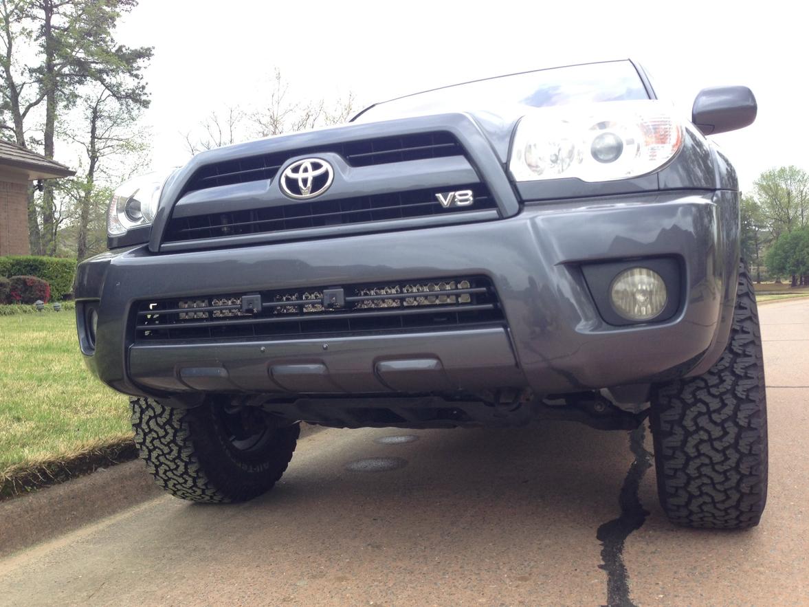

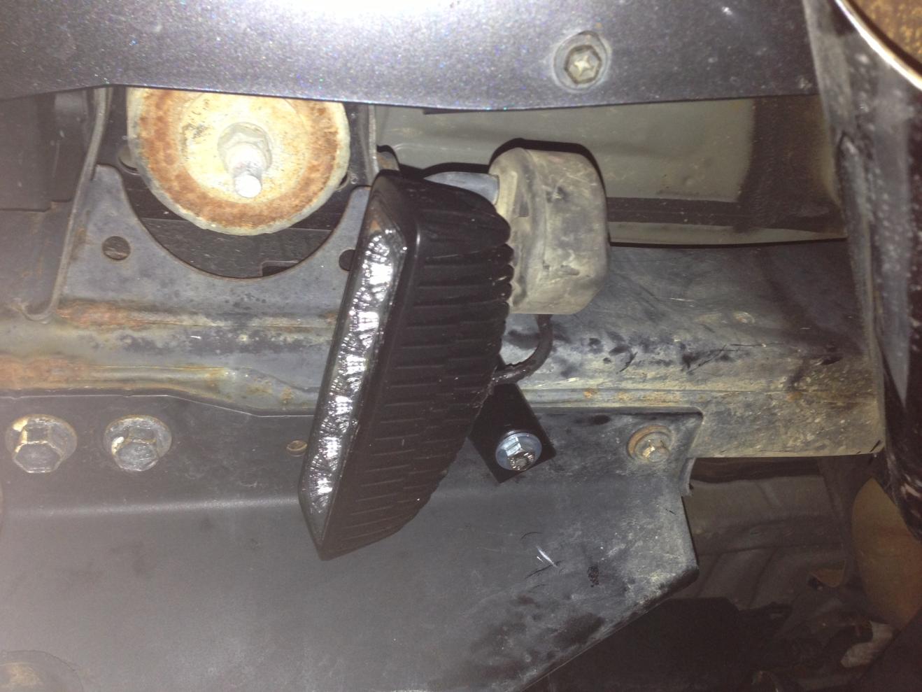

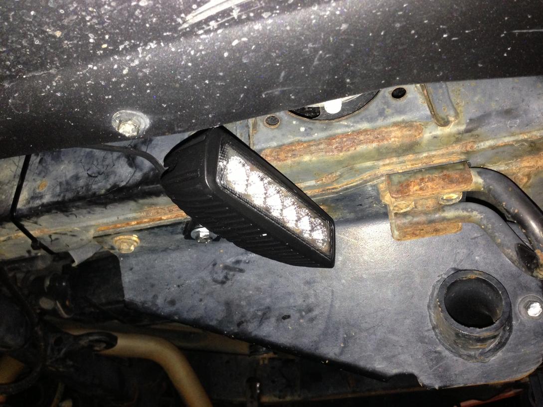

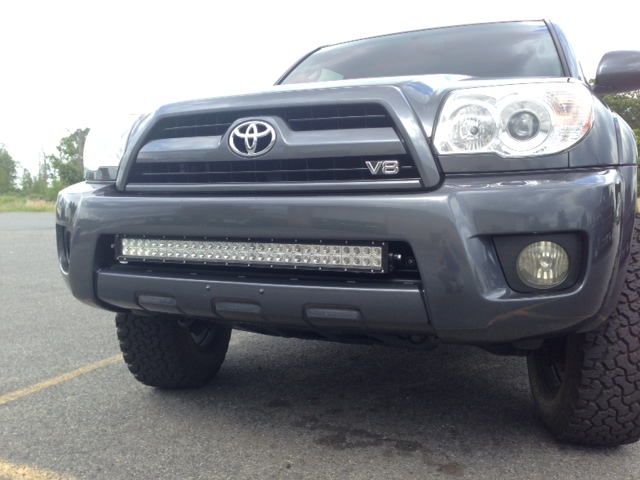

Well I finally finished my lighting project pretty much exactly to ASR's writeup using the Hanma led lights aside from my switches and their location. I spent many hours (20+) after it was all said and done. Wiring, metal work, switches, soldering and heat shrinking everything all contributed to the extended project time, but I wanted to do a clean install. I know if I went to a shop and paid for labor and used a Rigid lar bar I would have spent thousands but instead kept it under 400.
Here are a few pics of the install. I will get some output shots up later.

Turned out great!!! You should post some pics of those switches too, those were a very nice addition!

cant you take out the lower grill to get better lighting?
[MENTION=73434]Rigliner[/MENTION] removed his lower grill and said it made a noticeable difference (he said probably 25% more output). On the 06+ the lower grill unbolts and comes right off, but on the earlier models there's no way to do this from what I can tell. I'm satisfied with the output, and the whole point of this was to be bolt on with no cutting/drilling into the bumper, so I haven't cut out the lower grill. I have considered cutting it out and trying to rig up a satoshi style replacement, but again, the output is plenty for me and it defeats the purpose of this install.

here is a picture with the the lower grill out
