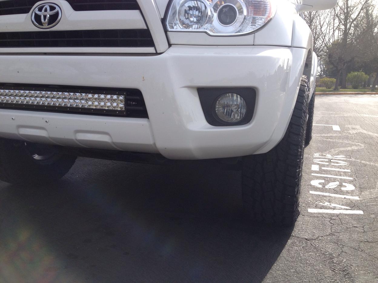

30" LED Bar Behind Lower Grill

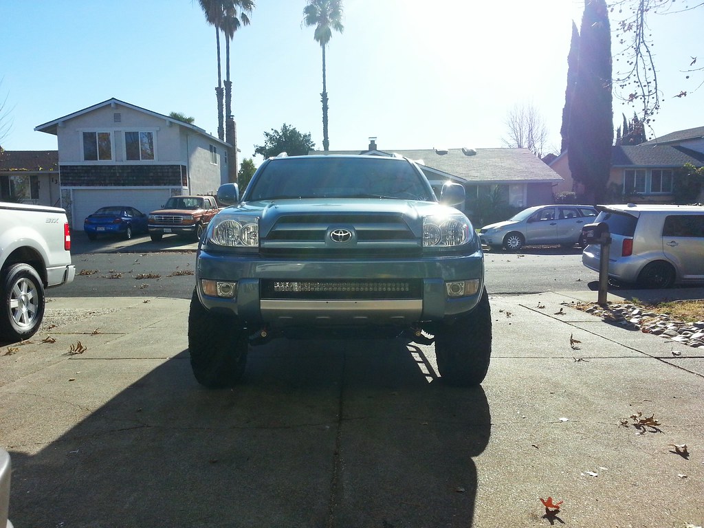

Stealth 30" single row Hamna. 80% of lower grill was removed. Mounted directly to the steel bumper.

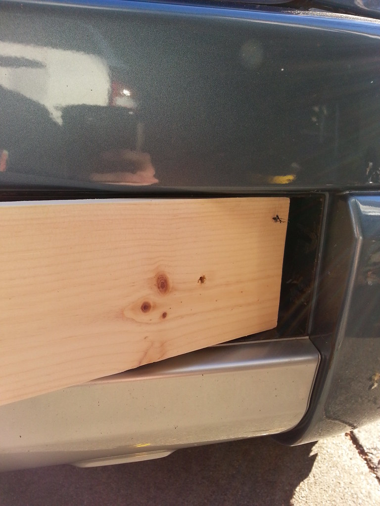

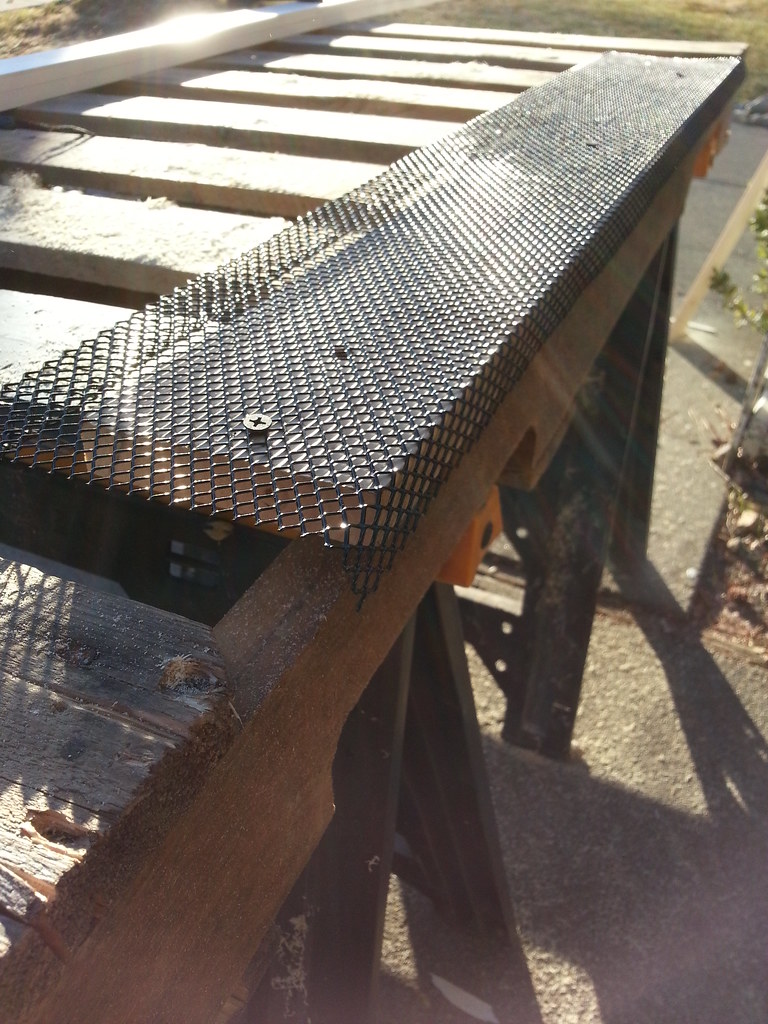

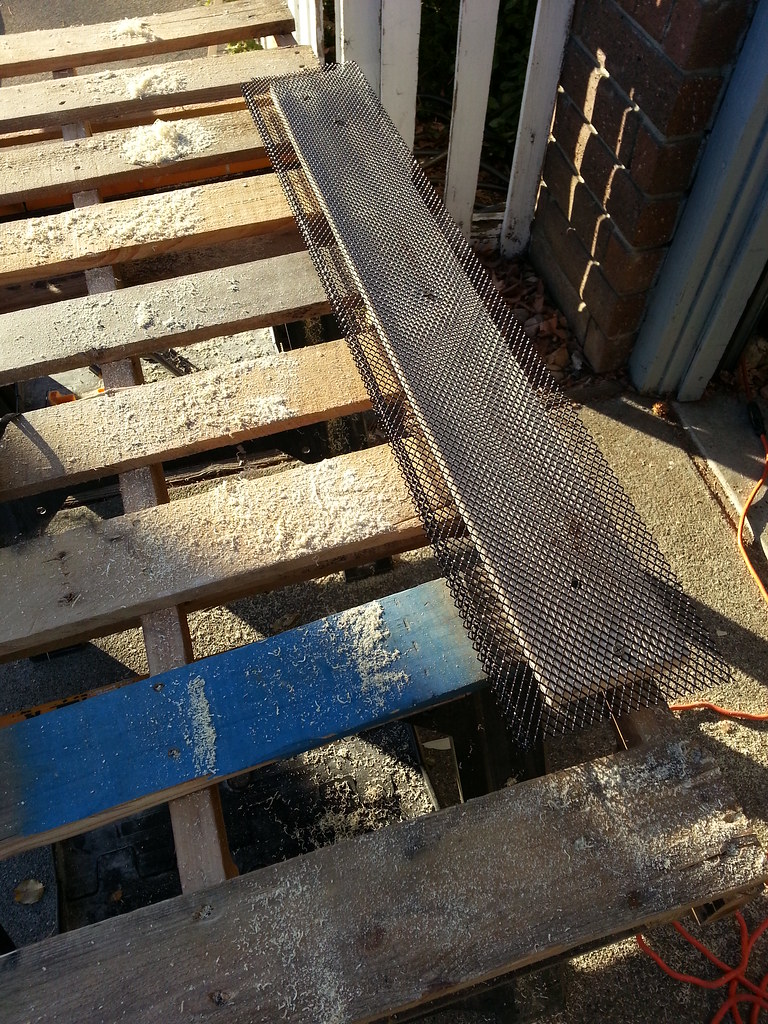

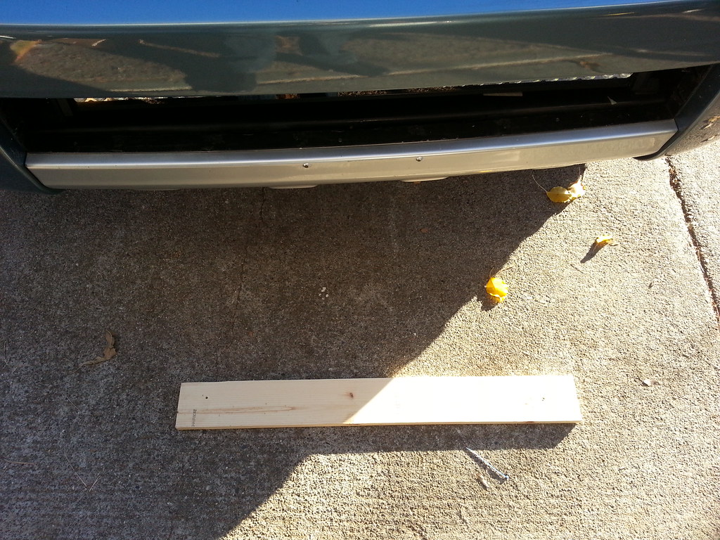

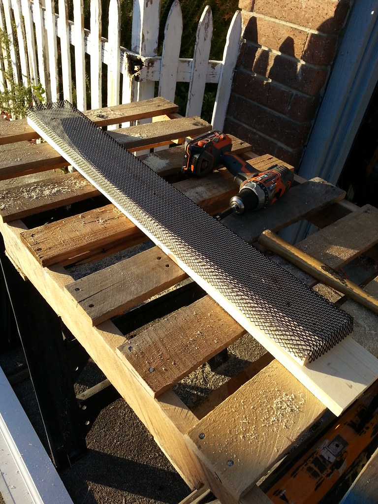

todays grille progress. I made a jig and cut to fit the board then screwed the mesh in to the board and bent the edges with a rubber mallet. Came out exactly how i wanted.

Finished the grille today, very happy of the outcome.

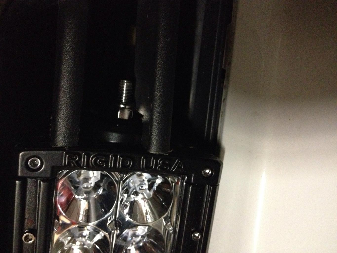

I think this has been one of my most enjoyable mods. After measuring a million times, 1/2 dozen sketches, 3 calls to Rigid techs....I finally pulled the trigger on a 30" Rigid Ind. light bar with a combo beam pattern. I decided going into this project that it would be a deal breaker if it didn't look right (to me). And if there were a chance of visible vibration in the beam as it projected to the road. Me and a buddy decided that it would be best to weld where we could to prevent this happening and it would give us the opportunity to get it set up the way I had invisioned it.
The first thing I did was measure. After ensuring the bar would fit the application, I made the $$ plung. 30" Rigid Industries combo flood spot flat bar. (Pre radius light bar introduction.)
The second part of the project was removing the lower grill. This allowed me to do a few things. 1. See how much space I was dealing with. 2. Start measuring the grill to light. I decided to use the grill as an insert and border to aesthetically frame in the light. I removed almost all of the fins inside the grill with various tool heads on a Dremel. Carefully leaving meat where I could to keep as much rigidity as possible. The 30" light bar fits almost perfectly so I kept a little of the fins on the right and left of the grill to keep a super clean look.
I cut 2 angle iron and re shaped them. We had to add 3/16 of steel to push the light forward giving me the position I wanted. We welded the angle iron to the back of the bumper. My mounting hardware mounts horizontally through the light bar mount and angle iron.
It was critical to get the right spacing not only for aesthetics but for light bar adjustment elevation. Off a little up or down, front or backwards would make it look like poo. Imo. It took about 3 hours. I did all of the pre fab before welding and did the finish detail trimming where needed before we got to welding. I couldn't be more happy with what I was looking for.
I have full articulation up and down. These bars throw a lot of light DOWN. So I have mine angled about 10-15degrees up.

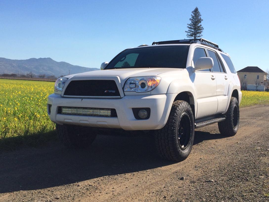

^ Looks great, like you, I was concerned with how this was going to look and if it would look like it belonged. I ended up using the custom Style B brackets made by MojaveMadMan and am very happy with the final product
20150801_174707_zpspm0k6owh.jpg~original
20150801_181041_zpsbcrp7udq.jpg~original
20150801_192751_zpsb8yzyak5.jpg~original
20150801_192819_zpsutrlgyv2.jpg~original
20150801_193248_zpspzdt81sf.jpg~original
20150801_191731_zpsdrllv4gb.jpg~original
This thread was my inspiration for wanting an LED bar, I originally wanted to go stealth like ARK did, however I like that it fills out the grille in my new painted bumper
