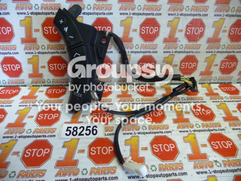

Here's the one I bought.
_57.jpg~original

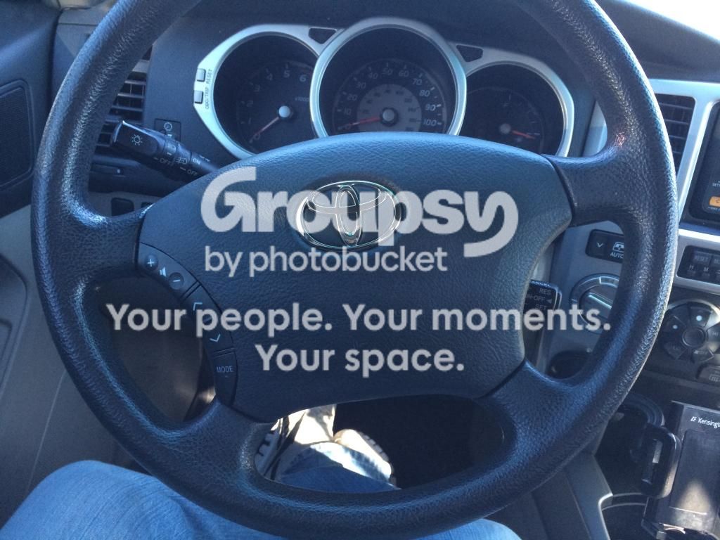

Here's some pics of the install.
IMG_4571.jpg~original

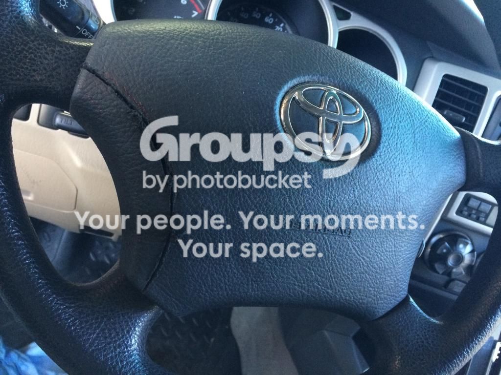

I did the cutting with a dremel. I traced the body of the controls with a piece of paper essentially and cut it out using it as a guide, and then I kinda eyeballed towards the bottom, which in retrospect was not the best idea.
IMG_4572.jpg~original
Here's the finished product. Again, its not as beautiful as if I had bought the airbag or cover, but that would have been between 115-300 bucks. And my truck is 10years old now. And she's got a couple dings here and there, so this is a little more character :trophy:. I may however cut a sliver off the block I have left and fill in those gaps. We'll see, it doesn't really bother me. But there you go.

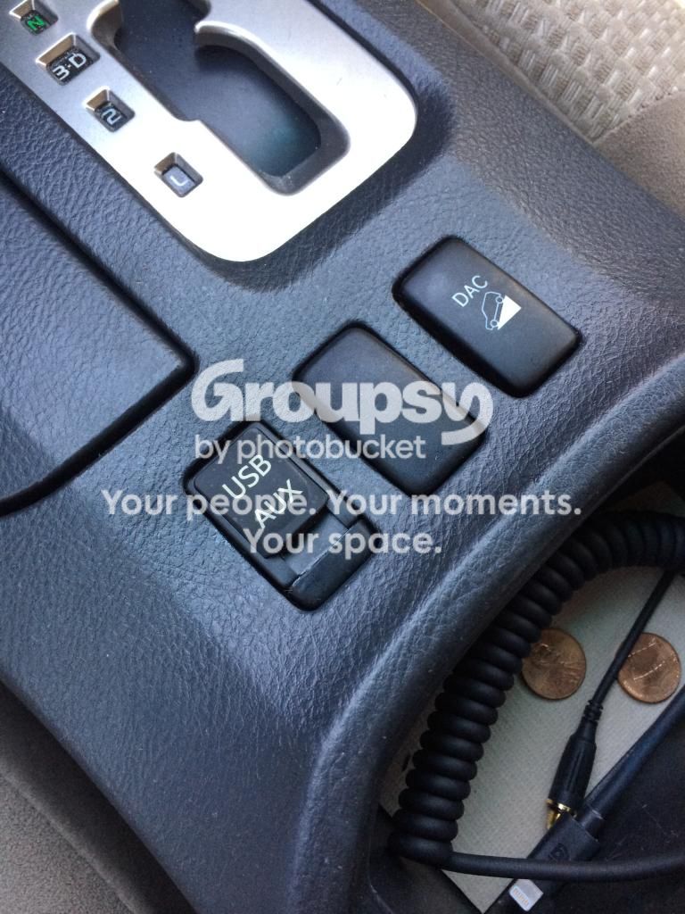

here's the usb/aux input. I cut one of the blanks, and glued the sliver with some jb weld to the end to make it fit the slot.
IMG_4530.jpg~original

Does it get cut right along that pre formed line on the cover?
No, it doesn't. Tracing the outline of the controller on a piece of paper and cutting it out is the way to do it. I then used that to draw a line on the airbag cover. I left myself a little breathing room and cut short so I didn't cut too much and then have it look terrible. Then I installed the controller and tried putting the airbag cover back on and cut slowly to make it fit. The gap in the middle is because my hand slipped with the dremel, and the bottom is because I started to rush. But really it doesn't look that bad up close.
