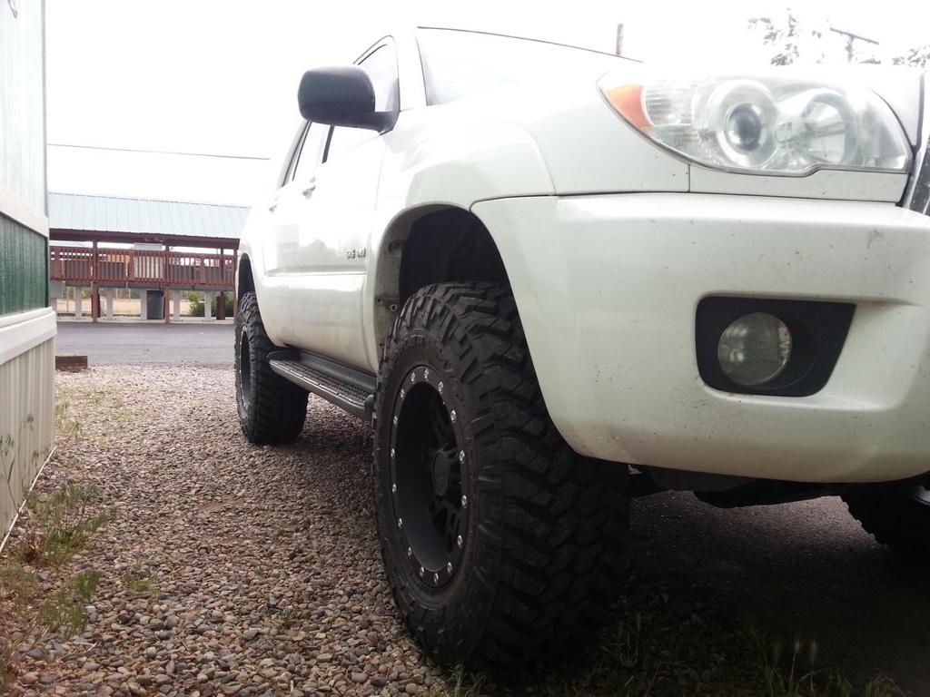

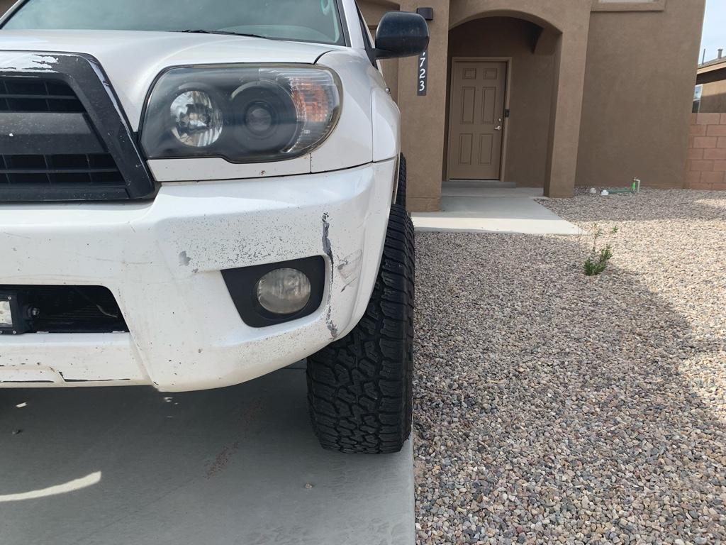

First setup was Toytec 3/2 lift, stock UCA’s, 17x8.5 -6 wheels and 285/70/17 Nitto Trailgrapplers. Only rubbed on the mount when off-road or backing up at full turn. Perfectly fine for street driving, except backing out of the grocery store parking lots I’d forget and rub pretty hard.
Current setup is Icon 3/2 lift, SPC UCA’s, BMC, 1” body lift, 17x9 -38 SCS Ray10’s and 285/70/17 Falken AT3W’s. I must barely be rubbing the mount when backing into my slopes drive because there’s a clean spot on the river side mount. I don’t hear or feel it though so must be very little.
FWIW the UCA’s are set all the way to the forward most position and caster is not great (necessary with these wheels) so she wanders a little on the highway. Nothing I haven’t gotten used to and not enough to make me go back to less aggressive wheels.
pictures of both setups.
Current (before steel bumper for comparisons sake)
Old
