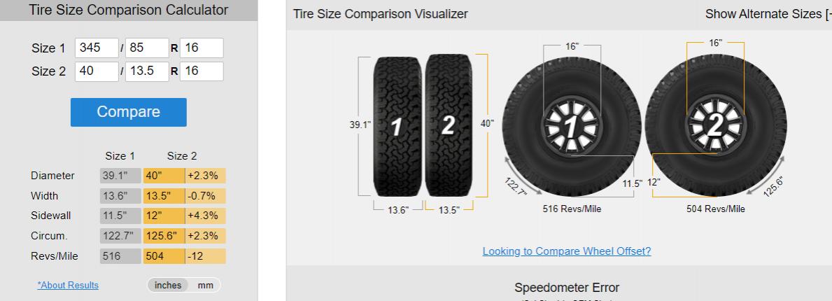

My point was (and still is) that metric equivalents which do not match the SAE size exactly are not the same. ...
Don't forget that even inch sized tire descriptions are rounded up and down to the nearest inch. Like the 40x13.5R17LT STT Pro for example. It's not 40in diameter, it's actually 39.75. But it's close enough to call it a 40. Same with metric, they round up or down to the nearest inch conversion for comparison purposes.
wow! Its hard to believe how dumb you are. First, the link you provided doesn't work, and second, did you actually look at what you typed? I guess any size tire that is round is exactly the same as any other size tire to overlanders. Which is probably perfect considering you never go off road. Since I have 33" tires, does that mean I get to say I have 35" tires just because its "close"? For your reference, here is what a 39" tire (the size you listed) looks like next to a 40 inch tire.
