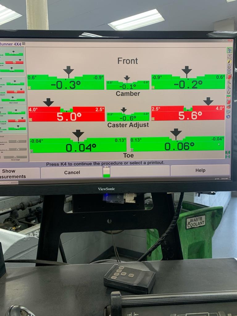

Which UCAs can push out 4-5 degrees? I always read people getting 3 maybe 4 degrees, but I always figured more was better in this case.
I may or may not do a bmc after my lift and 33s, but I always figured enough caster along with 0 offset wheels would be plenty to avoid it.
SPC adjustable UCAs should be able to.

I cleared 33s easily running a Dobinsons MRR lift, no sway bar, ICON UCAS and a caster adjustment as far forward as possible. (Usually 4 to 5 degrees forward).
Nothing else required. 34s are when it becomes required.

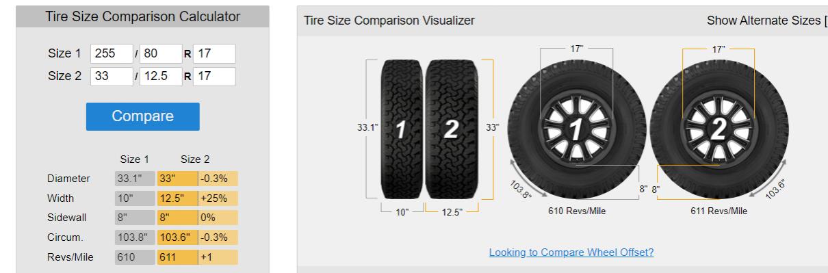

33's must be 12.5 inches wide or they are not 33's. What is so hard to understand about that concept? If they are not 12.5 inches wide they are "weenie european range rover pizza cutter tires" which is what you have. Also, 285's are STILL not 33's and you yourself mentioned that they rub and they are not even big enough to call 33's yet.
That's just ****ing stupid. Pizza cutter width or 12.5 width, they are both 33" tall, therefore 33s. Where do you get the idea they "have" to be 12.5?? Just because it's your concept doesn't make it fact. Get over yourself with that bullshit.
