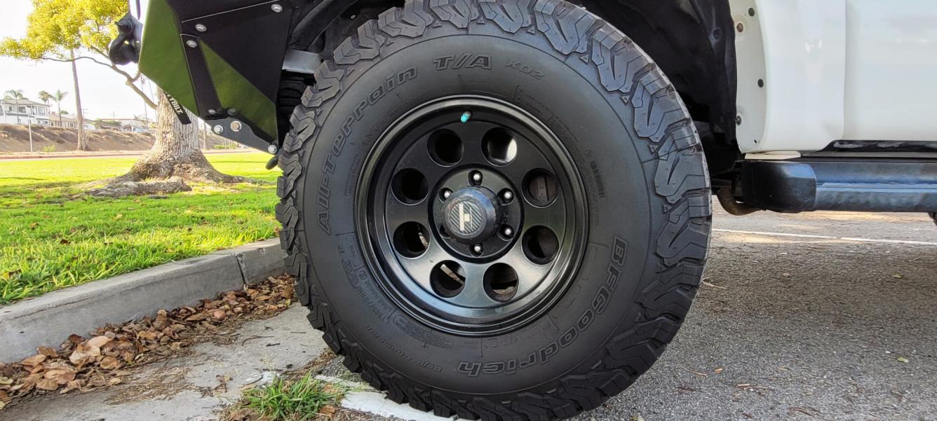

2006 SR5 running KING 2.5 lift with 285\75\16 KO2's AND Shrocworks bumper
Result - It WILL require a BMC and cutting off 1"-1.5" portion of OEM bumper cover at front lower wheel area otherwise you will definitley get a rubbing contact of the rear of the tire rubbing on the lower shock body mount. Photo isnt the best angle but the BCM did the job so that 285\75\16's work!
