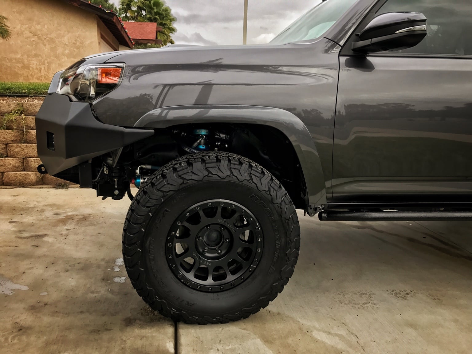

This is Manhstuh's whip on Duratrac 35s. He wheels his pretty hard. These are off his IG.
