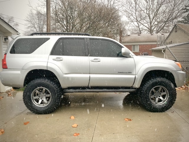

Just realized I never updated this since I got (almost) everything squared away.
Tire Size: 315/70-17.
Tire Make/Model: Goodyear Wrangler DuraTrac.
Wheels: 17x9 -38.
Body lift: Yes, 1".
Approx. Suspension lift setting over stock: ~3".
Aftermarket UCA's: Yes, SPC.
Caster correction: Yes, not sure of amount though.
Bumpers: C4 front, custom rear.
Trimming: I still need to trim more, but front bumper and fender are cut, pinch weld flattened, and liners pushed away.
Bump stop drop? Yes, 2".
Notes: This still rubs at full lock in reverse but only on the plastics, I did an NTK body mount relocation just to free up that whole area. I do not know with compression yet what it will do. Rear links are still stock so we'll see if that becomes an issue. Gears are also still stock but I think the wheel/tire combo is light enough to be okay.
