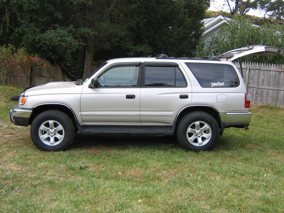

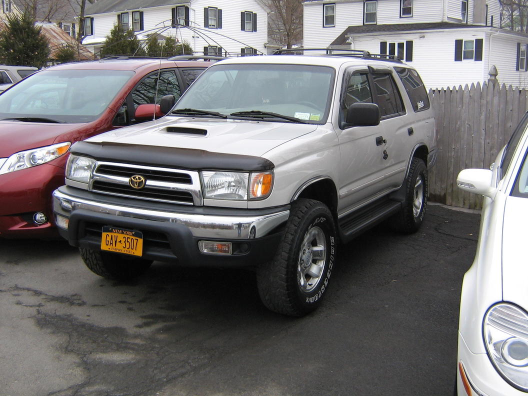

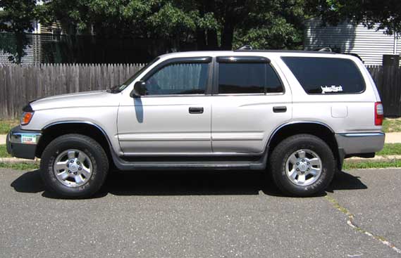

These are 275/70R16's that I had a few years back on stock 99 Talls.

I love those rims. IIRC they have a different offset than the split 3 spokes because they are from later generations.
Yea, 4th gen wheels need spacers otherwise you'll be rubbing on the UCA.
I love them too. They have a hot rod look about them.
This is incorrect, at least on mine. I have been running those same wheels on my '96 with 265/70/17 Goodyear Silent Armors for a few years now without issues or rubbing on the UCA. I do rub a little on the frame at full lock. Front springs/struts are factory with about 160k miles.
