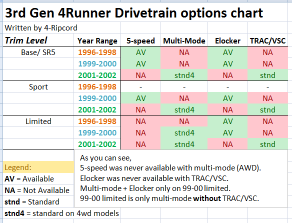

Transfer Case differences:
The 4wd t-cases in the 3rd gen 4runners varied through the years and trim models as well. ALL 4runners are 2wd vehicles (rear wheel drive) until some form of 4wd is engaged.
-Let’s start with base, SR5, and Highlander trim models. The transfer case remained the same for these models from 1996 to 2000. It was a basic J-shaped shifting configuration. This transfer case was purely mechanical, no push button components.
-The limited 4runners had a little bit different setup though. From 1996-1998, Toyota used a push button on the shifter to engage 4Hi from 2wd. The only time you actually need to shift the transfer case is to go into 4Lo.
-In ’99-’00, the limited upgraded from a standard transfer case with push button, over to a differential type transfer case (known as Multi-Mode). This type of transfer case still has a push button to engage 4wd from 2wd. A differential type t-case is different from a standard t-case in that the front and rear drive shafts could rotate independent of each other and avoid binding on high traction surfaces. Until this center differential was locked, the vehicle is essentially in all wheel drive (discussed more below).
To lock the T-case, you simply shift from 4Hi to 4Hi(L).
-In 2001 and 2002, all models gained these Multi-Mode transfer cases (including limited, now they all have the same system). But, the locking method changed from a separate shifting position to a separate push button on the dash.
http://www.toyota-4runner.org/3rd-g...rs-3rd-gens-transfer-case-awd-multi-mode.html
I HIGHLY encourage you to read this thread skillfully written by Brian2sun. It is more in depth and contains information such as recommended speeds, shifting configurations, Pictures, Uses, and more differences.
The information above is a summary of the information in his thread.

How do I choose between these?
-If you live in an area with ice covered winter roads, heavy rain, and you tend to be more of a city driver, the Multi-mode selectable AWD is going to be indispensable to you. It makes icy roads easy to tackle.
-If you tend to do more off-roading and plan to modify the 4runner for a trails vehicle, the rear e-locker is going to help you a lot with that goal.
-The '99-'00 limited 4runner had both of these if you can find one with the e-locker option.
TRAC/VSC:
To replace the E-locker that was discontinued after 2000, Toyota equipped ALL 2001 & 2002 4Runners with a few electronic systems in it's place. TRAC (traction control) & VSC (vehicle stability control).
Basically, these systems use the brakes to control vehicle stability and traction. While the normal everyday driver will not notice these systems in operation, owners who drive their vehicles in a "spirited" manner will notice interference from these systems. In low-traction road conditions (dirt roads, wet pavement, etc..), drivers may easily cause either of these systems to interfere in attempt to control the vehicle in the event of loss of traction.
Disabling TRAC/VSC:
With a few small exceptions, these systems were not able to be disabled from the factory. Many owners choose to make it possible to manually disable these systems.
-2wd 4Runners came with a factory switch to disable TRAC & VSC.
-On 4wd's, VSC is disabled when the vehicle is in 4x4 with the center differential locked. TRAC still remains on in this situation. This is the ideal setup for most off road situations, as TRAC helps in most situations by acting as a limited slip differential for all 4 wheels. Situations where it is best to also be without TRAC would include deep sand and mud
-Members on Yotatech(.com) discovered a way to add a switch to be able to turn off both TRAC & VSC at any time. Known as the Andymod 2.0.

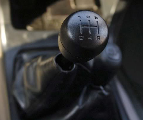

5-Speed manual transmission:
The 3rd gen 4runner was also available with a 5-speed manual transmission. The 5-speed is often preferred for its off road uses, increased fuel economy, and the lack of the Strawberry milkshake issue.
Similar to the E-locker and 4cyl engine, the 5-speed was discontinued after 2000. Also, the 5-speed was NEVER available on the Limited 4Runner.
Photo courtesy of JohnsD90.
