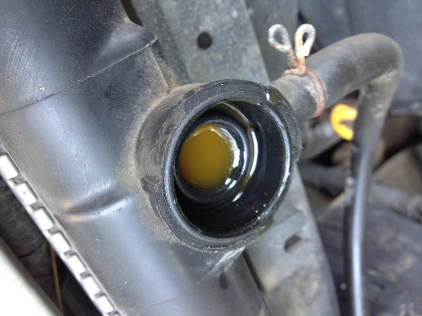

Bought a 2000 SR5 4x4 about 10 months ago in upstate NY aka ridiculous amounts of salt used in the winter --> RUST...I'll admit it was a bit of an impulse buy as I've always wanted a 3rd gen and this one was "pretty good" and in my price range. Truck currently has about 177,000 miles and I'm starting to believe it was a big mistake to buy it.
~6 months ago I fire it up and it's idling rough for about 5-20 seconds when the motor is cold...throws CEL, which has been intermittently on/off to date. CEL code is for 'random misfires'.
Since then, it does the same thing upon cold start about 90% of the time, misfires only when at a stop sign (never when accelerator is depressed), does not smoke white until about 1/4mile down the road, has never overheated, does not feel like it's lost any power, but DOES go through coolant scary fast. In addition to going through coolant, the overflow looks pretty dirty and it changes the clean yellow coolant into a dirty brown/pinkish (NOT pink milkshake pink, just kind of a tint)
*^^See attached picture of color and high level of coolant in Radiator*
Replaced plugs & wires 3mo ago and previous owner had timing belt/water pump done ~20k miles ago at Toyota dealer.
So here's the deal...
I need to make an 850 mile trip back home to Michigan from NY at the end of next month. I need input from you guys on:
a) Which dx tests should I have done (block, compression, leak down, etc.)
b) Your thoughts on driving it in this condition the 850mi since it's been holding steady symptom-wise for the past 10,000 miles
