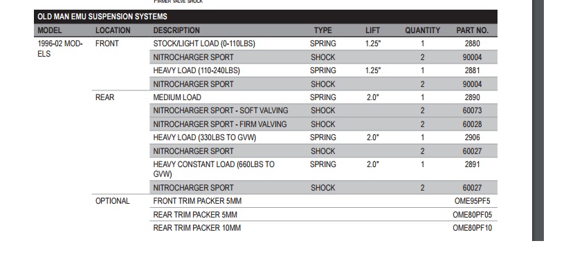

Im confused by the ARB vehicle application guide. it states the 890 as medium load. while the 906 as heavy load. both states of 2 inch lift. im highly confused on which is the right one? im only looking to have stock weight and a 2 inch lift.

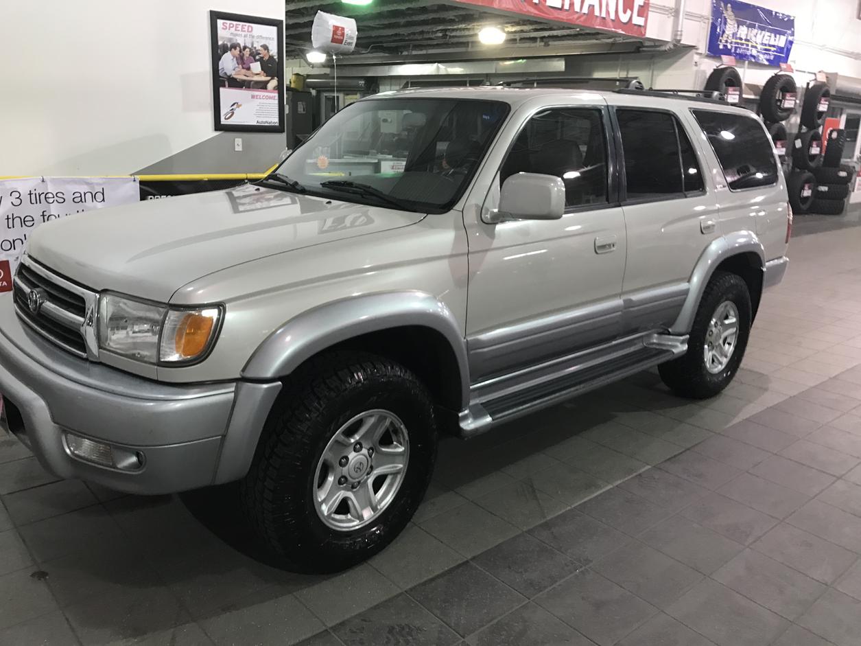

Picked this thing up back in September in Virginia, and just drove it as is until December when I moved up to Maryland. Once I got up here started studying up and stockpiling parts for my lift. Below is what I've got going on.
- Tundra 5100's on all four corners
- 3" Toytec/Eibach Front Springs
- 3.75" Toytec Superflex Rear Springs
- Fat Pat's 1" Body Lift
- 305/70/16 Toyo Open Country MT's
- 16x10" -38 Black Rock 997 Type 8 Wheels
How I purchased it..
After 5100's and Toytec Springs
After the addition of the Body Lift.. (how it currently sits)
