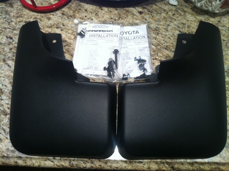

Hey everyone, does anyone know the bolt size, thread, length for the black SR5 front plastic mudflaps? These mudflaps were made by AMP industries and were discontinued a long time ago.
The original part numbers were:
PT41335966DF
PT41335966PF
Seems that a bolt comes included with the original kit to screw into the body. I've attached a picture here of what the original kits come with. If you look at the picture there is a long skinny bolt in the photo. For anyone who currently has these would you be able to share the size?
I bought the stock Toyota fronts (75$), they used 10 mm (x3) bolts and a rivet to mount on. They looked identical to these ones (these probably work but they are for Tacomas). There wasn't a long skinny bolt in the OEM kit, they were all like the ones I linked above.
PT41335966DF
PT41335966PF
That long one is supposed to go UP through the bottom fender bolt I believe.
Thanks for your help on this. Those are fender bolts that are used but are longer.
The normal lower fender bolts are size m6 x 1 bolts about 1inch long. Original Toyota Part number is 90119-06394
However, the bolts needed for the mudflaps has to be longer as it goes through the mud flap AND attaches to through the lower fender.
I sourced some M6 x 1 bolts about 1.5 inches long with washers and they worked fine.
However, my original fender bolts were so rusted it out that they snapped when trying to remove them :wow:
So I had to drill them out and retap. What a pain that was.
