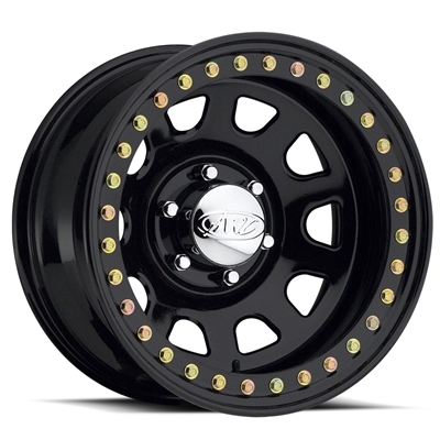

Buddy won a new set of Raceline™ forged beadlocks so he's letting me have his old set plus a spare for $400. The ones I'm getting from him are the 16x8 Daytona steel wheels and they clear the Tundra brake upgrade so I'm pretty stoked. These are the ones.....
granted, with what I have right now, I would take any rims.....and now for tires.....

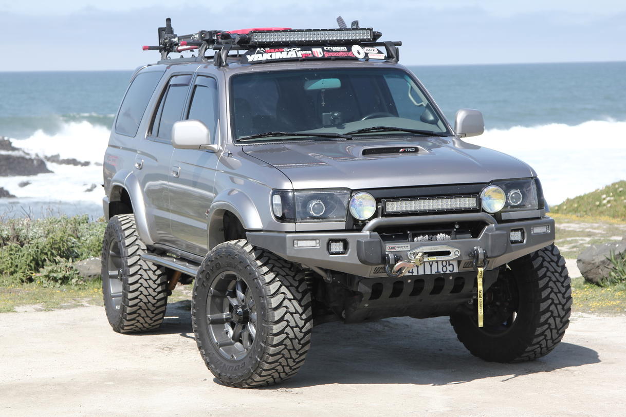

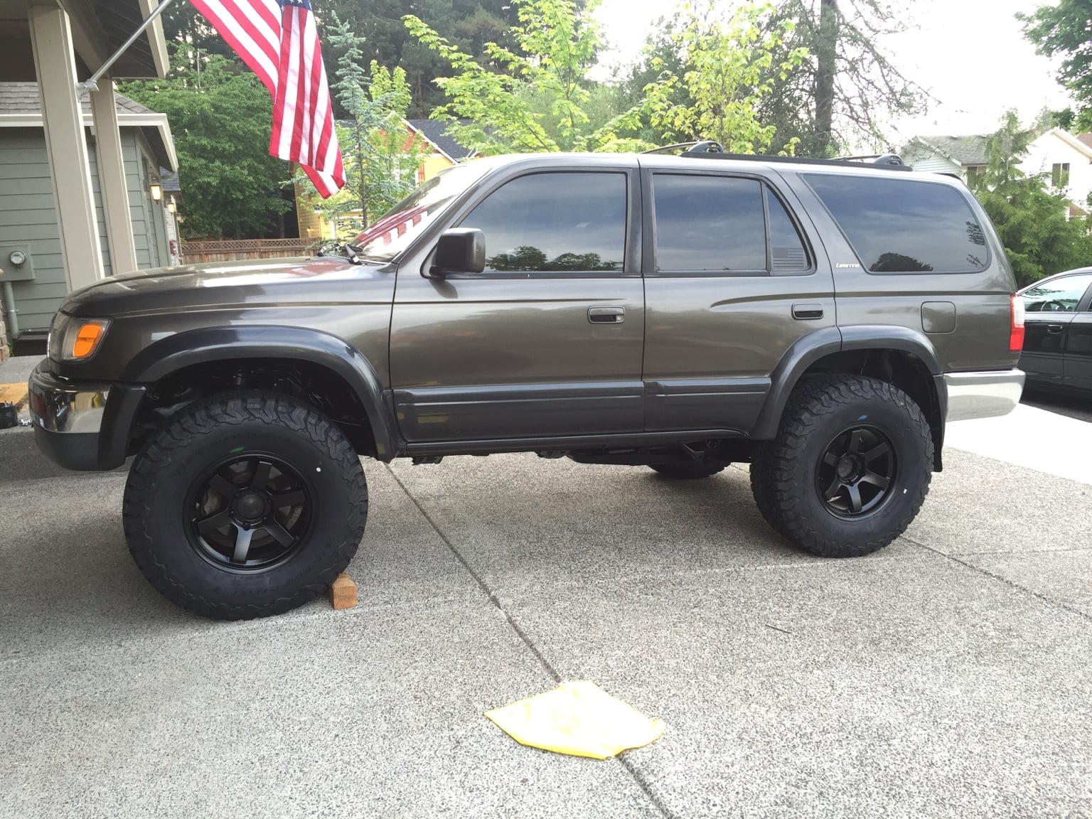

18x9 kmc xd badland with silver vein powder coat and 33x12.5x18 toyo mts.:cheers

18x9 kmc xd badland with silver vein powder coat and 33x12.5x18 toyo mts.:cheers[/QUOTE]
Nicest 4Runner on here imo really makes me wish I had a ARB and was fabbed up to look like that

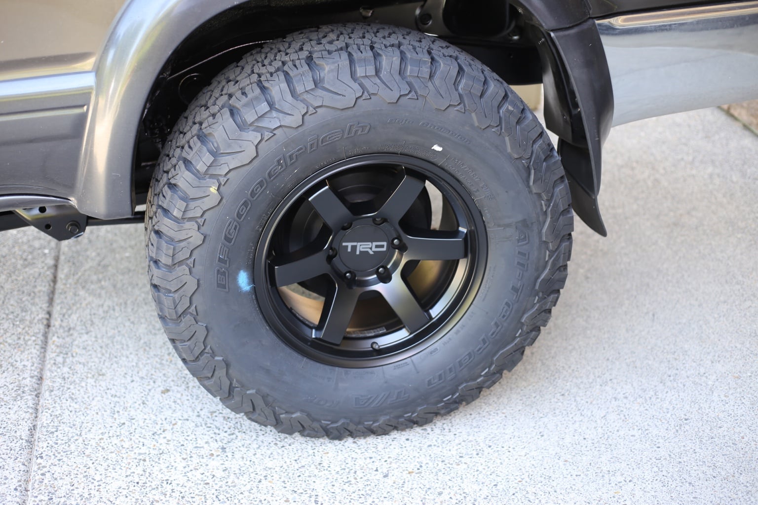

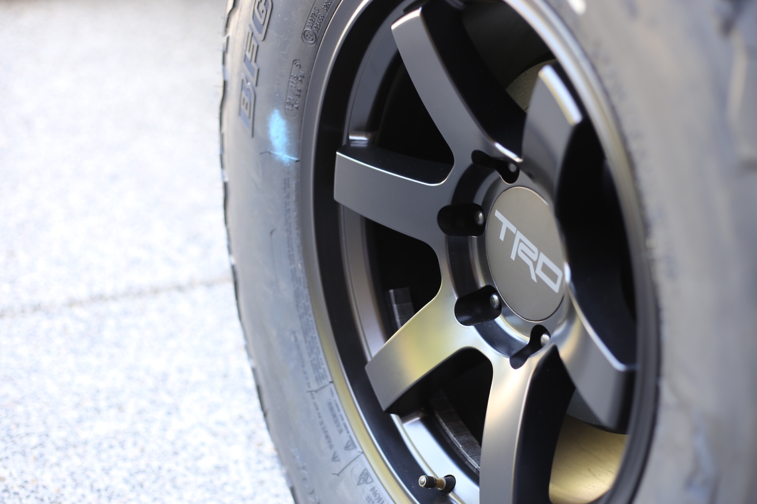

17x9 et0 (4.5"BS) Level 8 MK6 "Matte" Black
Much more satin than matte- which is a very good thing, IMO.
Tires are 315/70 BFG K02.
Where did you get those TRD center caps? Something other than the "8" always classes those MK6s up. I dig the way those look on your rig.
