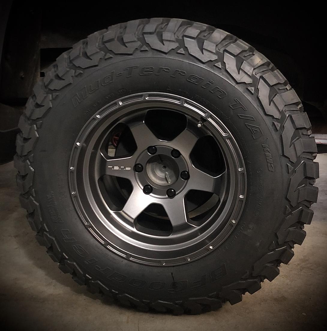

How much of a lift do you have? This the exact wheel/tire size and height I'm after. Thanks.
Member [MENTION=89230]GentryGoon[/MENTION]
SCS F-5 in Matte Jet Black
16x8
4.5" Backspacing
Hub-centric
19lbs.
Will clear Tundra calipers.
285/75/16 tires.

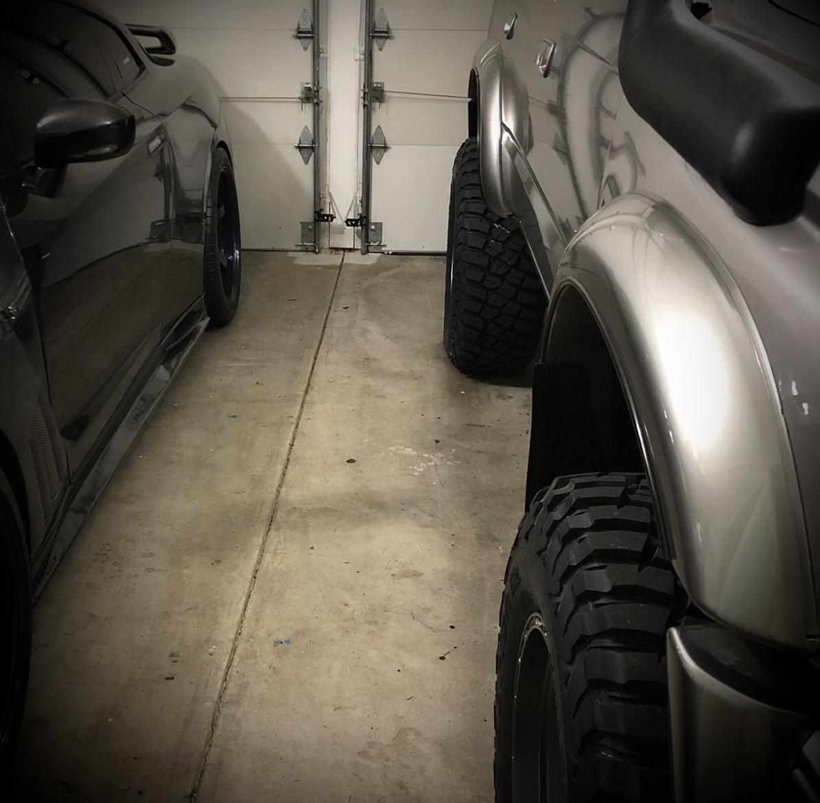

Wheels:
Fuel Shok Anthracite
17x10” offset -18
Tires:
BFG MT 285/70/17
Suspension:
Toytec 1” body lift
Toytec ultimate 3” coilovers
Rub:
Minimal edge of front bumper on full clock reverse. No rub on mud flaps. No BMC necessary.
Fix:
Trim 1 cm off bottom of front bumper within the fender.

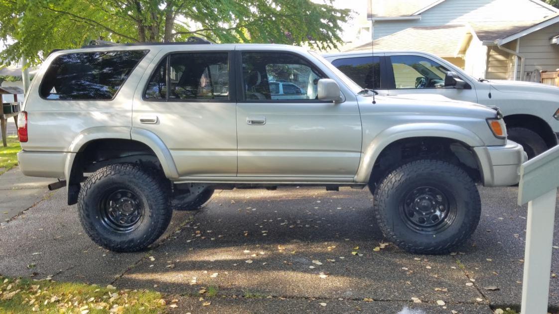

Wheels:
17X8.5 (6mm) Fuel D557 Anza Matte Black w/ Anthracite Ring
Tires:
BFG KM3 MT
285/70R17
Suspension:
Toytec AlumaSeries 3" w/ SPC UCA
Rub:
After some minor trimming, I don't experience any rub

Thanks for the info! They definitely rub in reverse (moreso on the drivers side), but I have a 1/4" strut spacer that I'm about to put in the hopes that it'll give it the clearance it needs. It also rubs slightly when fully locked to one side, so fingers crossed!

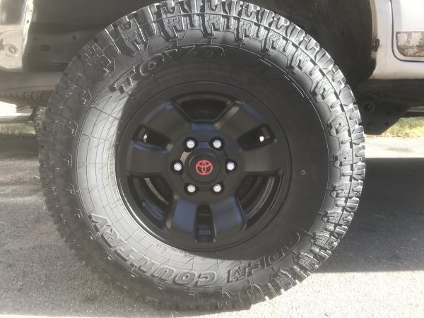

Can't believe there's been 9 pages and almost 8 years of this thread without a good ole rattle can rim special! I guess I have to represent the "too poor to get new wheels but still want to look cool" community and show mine here...

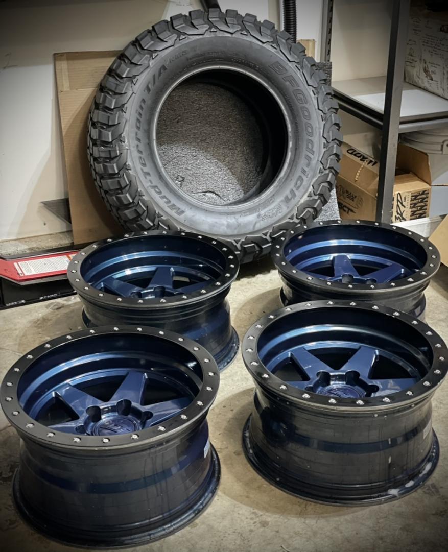

Is there a list of wheel manufactures that fit our 3rd Gens? I’ve searched and this is the only thread I could find with the pretty good specs on wheels...
One thing I’m seeing is the lack of offset mention with the wheel/tire specs.
I like the deep dish look and have seen some -18 offset which might be more than I am looking for but some where between -10 to -15 offset.
If you run that kind of offset on 17” wheel will those work with the TBU? I may do that In the future and don’t want to have to buy new wheels when that time comes.
Thanks in advance!

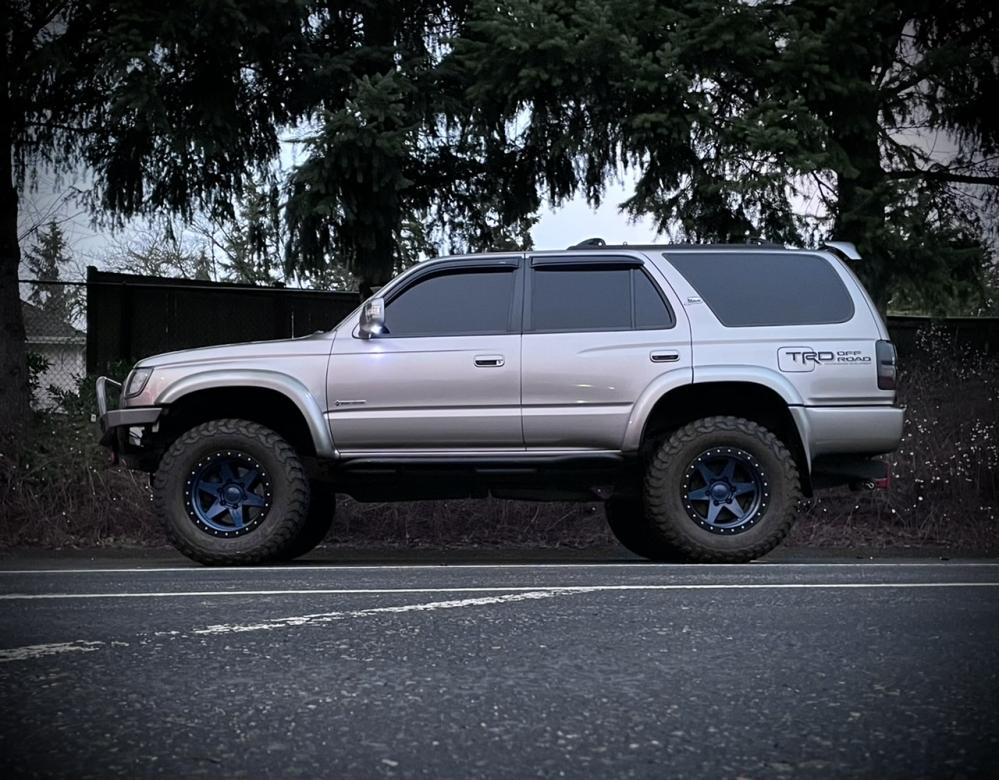

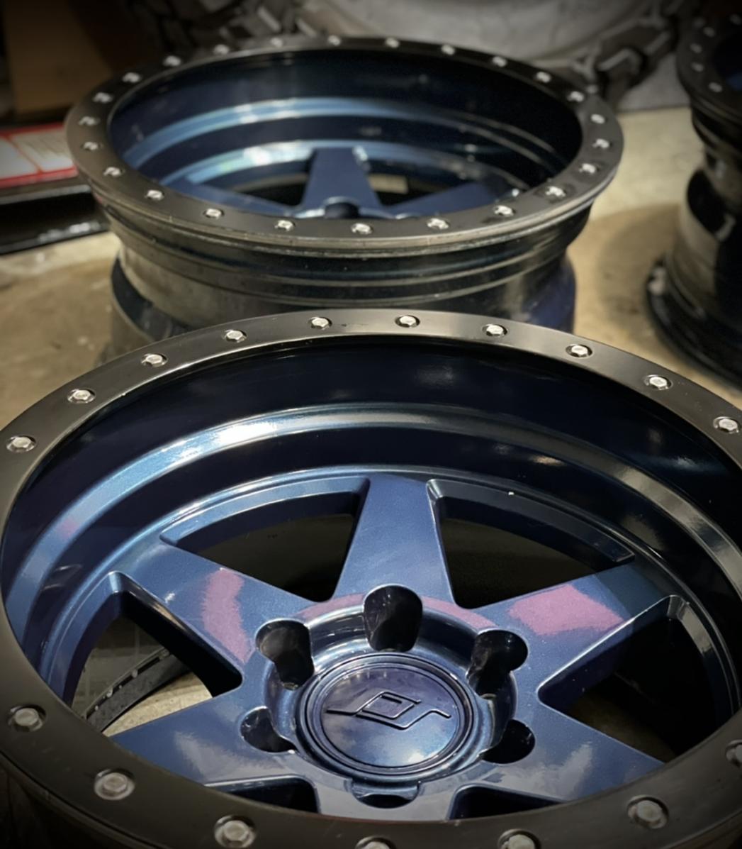

SCS BR6
Stealth blue finish
17x9” offset -38
BFG MT KM3
285/70/17
