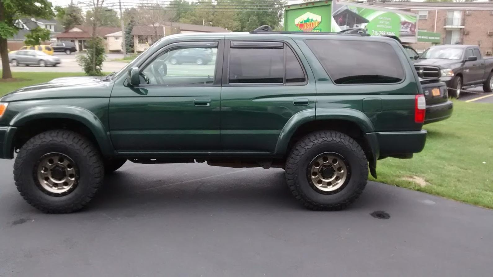

Mine are some basic MB razors from Discount tire.
17x9 - 6-6.5
Wrapped with 35x12.5r17 Goodyear Wranglers MT/R's
Love them and I think I paid like $90 each :bigok:

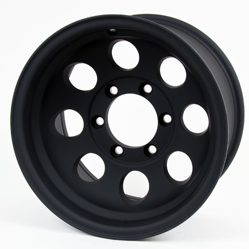

Pro Comp 7069 Alloy Wheels in Matte Black
  • 16 x 8, 4" backspace, -12mm offset, 6 on 5.5 bolt pattern
  • Purchased at 4WheelParts.com
  • Installed with Goodyear Wrangler Duratrac 285/75/R16s
  • Low profile center hubs from Wheeler's Off-Road (I didn't like the Pro Comp center hubs)
  • Gorilla 21138ETBC lugs purchased from Wheeler's Off-Road
  • Technically these wheels do not need spacers, unless you're going for the wider look. I took off my SpiderTrax and installed without 'em.
  • I have no rubbing with my 3" Toytec lift.
  • They will accommodate the 231mm Tundra brake upgrade (I have not verified personally but [MENTION=44220]BigFishAllDay[/MENTION] said so in his awesome writeup).
Here they are on my '97 SR5! LOVE these wheels.
