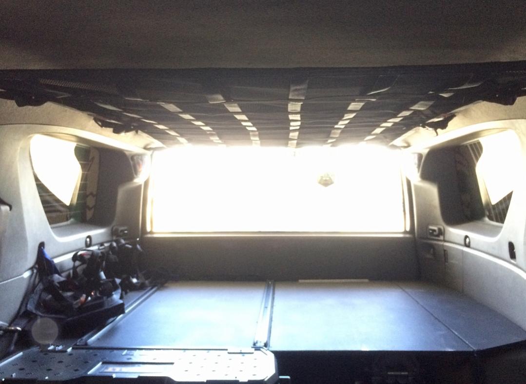

I can't quite tell on that picture or the pictures on your website, but where are the attachment points?
More specifically, I am interested in whether instead of going full-length, I can have a roof-net over the rear cargo area, but have the front portion of the net be used as a way to block and divide the rear cargo area from the rear passenger area (coming down approximately where the rear passenger seatbacks would be).

Like your approach here. I had the good fortune to spend some time with [MENTION=148218]JZiggy[/MENTION] yesterday and after explaining what I'd like to do, he mentioned your name. i was wondering if you used rivnuts, and you did. Well done. Probably didn't even need to remove the headliner?
So, a year later, have to ask, still holding-up well?
No problems at all.
And the rivnuts go in without pulling the headliner. And if you want to pull it out the headliner clips work in the rivnuts.

Helpful again rkntoy. Well-executed.
I will do what you did, possibly using stand-offs to create just a little space above to squeeze-in compressible items like jackets.
That welded mesh seems to fit perfectly back there. May I asked where you sourced it? Apologies if mentioned earlier...

It is 2" welded - I got a 4x8' sheet for a different project (that I never did) from the local steel supplier. If you lived closer you could get some for free - I still have the rest of the sheet left.
