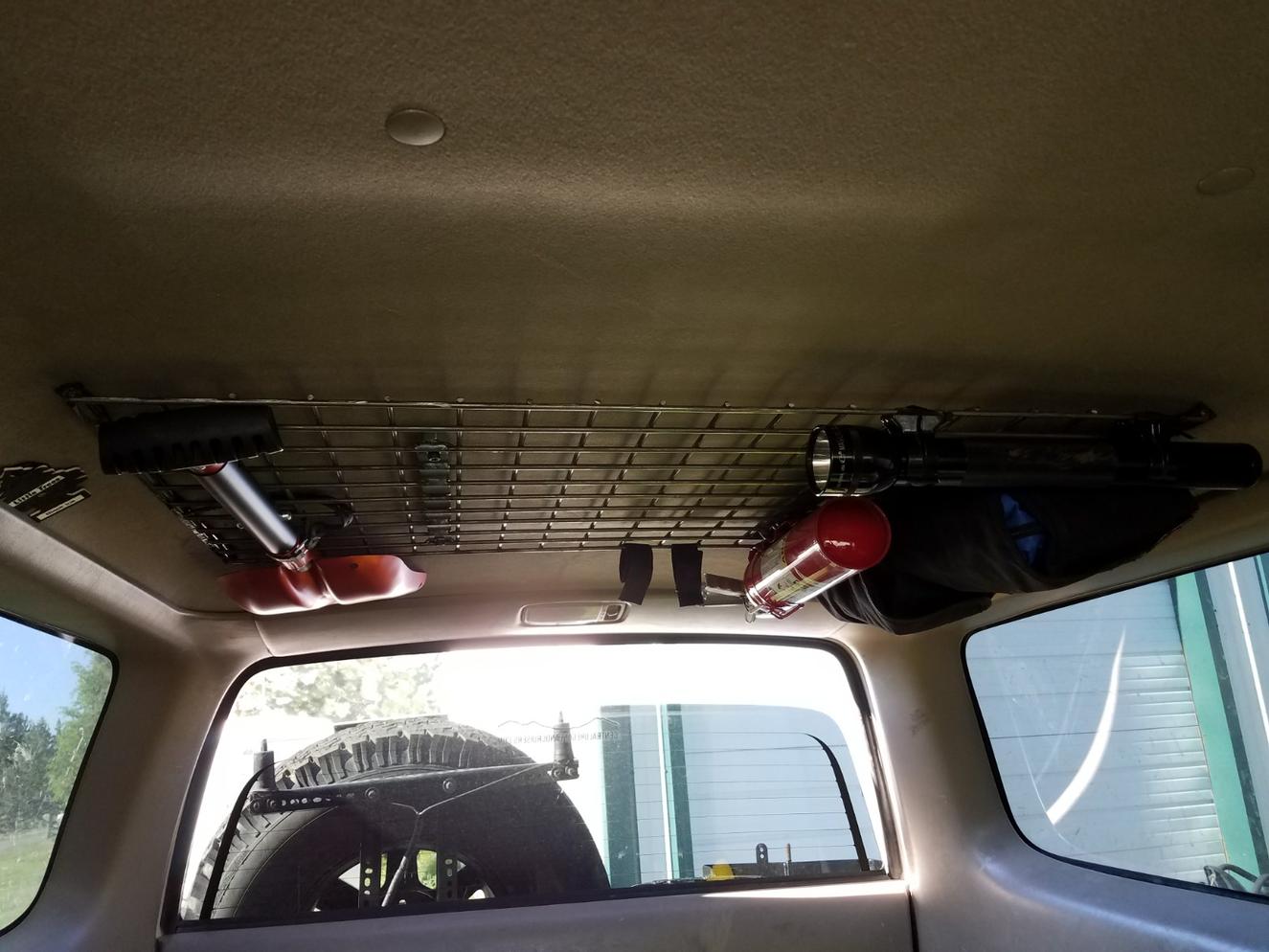

Raingler makes a nice product. You have to pull the trim back and install mounts into the sheet metal. Here's mine in use.

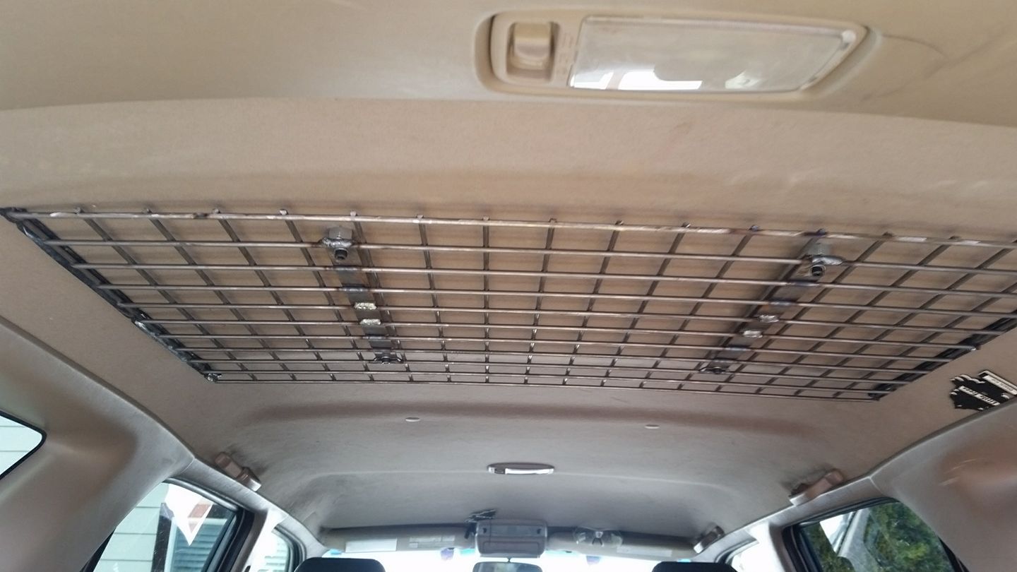

I did it a little different with 2x2 welded mesh and mounted molle pouches to it. Hate having stuff sagging down in my rear view and moving around.

Here is my setup

That's cool! I built something similar for the back window. I may barrow this or close. Very smart. Did you attach to those two roof structure supports? How much does that weigh?
I put 6mm rivnuts in where the 4 headliner clips went. The clips still fit if I decide to pull it out. Thinking about making some more as I have a bunch of the 2x2 mesh left.
I would do it the same. The rivnuts in the ceiling have been holding up great.

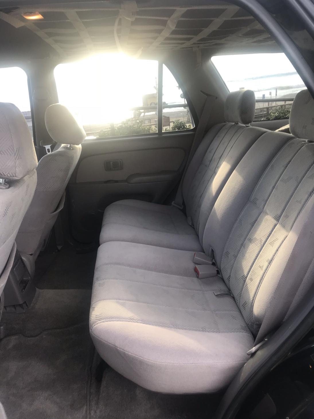

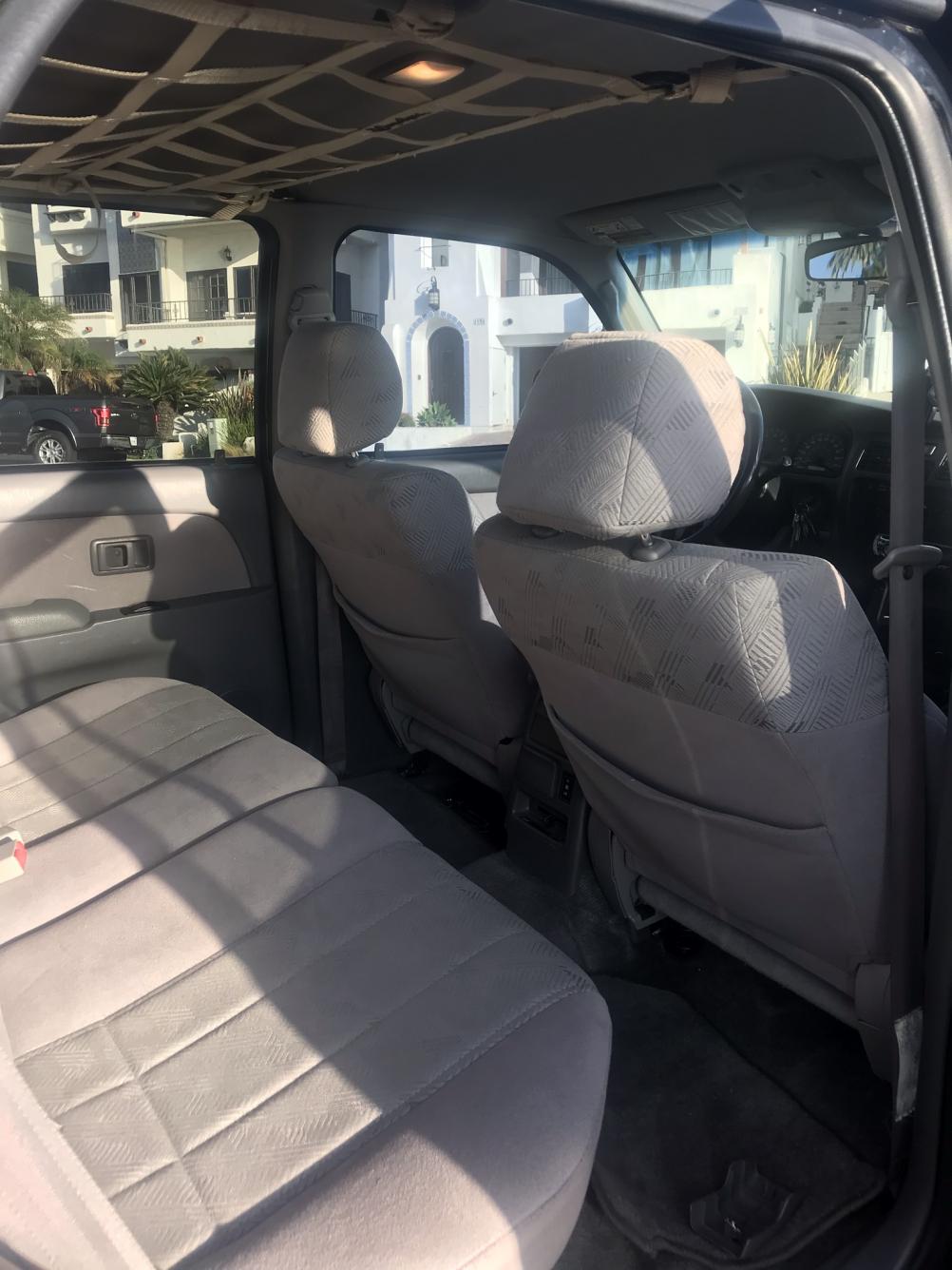

Here's a few different angles. Mostly existing handles and our D ring mounts up front though. Here's how they install. You could fold the front down as needed or all the time and then have the option to raise it up if that suited the storage needs better when you wanted.
We do make a back cargo area ceiling net too. You could then have choices of specific vertical barriers that would have a tighter and more contoured fit to the 4Runner. Just depends on how closed up that back needs to be really.
