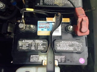

Any reason no one seems to be using a deep-cycle? About $80 from Costco. 685 cranking amps. Small mod to extend positive cable for reverse posts.
I don't know much about batteries but I thought this was a good idea when I did it several years ago!

Never seen deep cycle used on cars. But shouldn't be an issue. I think if you have enough cca its fine.

Deep cycle batteries are made to be deeply discharged (50-80% of capacity) and thus will have less CCA's than a comparably sized starter (normal) battery.
Using a deep discharge battery where a start starter battery should be used (your car) or using a starter battery where a deep cycle battery should be used (your boat/RV) will shorten the life of either.
