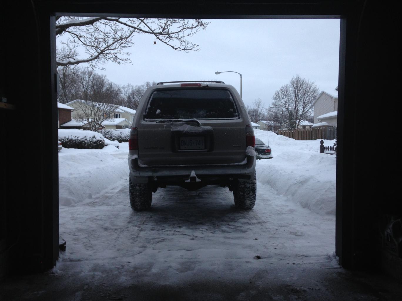

Anyway, I have a pretty noticeable lean as well. I'm pretty sure it's at least 1" difference.

Noticed yesterday that the truck didn't appear to be leaning at all. My wife confirmed that it looked much less "leany" as well. Measured the rear fender heights from the ground and now they're only 1" different instead of 1.75" different. The front fenders are 0.5" different.
Wednesday evening we drove through downtown on a REALLY rough cobblestone road and I'm wondering if maybe a spring was unseated and got re-seated? Bizarre stuff.
I haven't had a chance to mess with it much this week but hope to get under the truck and look around this weekend.
Not sure these show much but here are a couple pics from when it was severely leaning:
And yesterday when it wasn't so noticeable:
Those pictures are AWFUL at showing anything, sorry!
