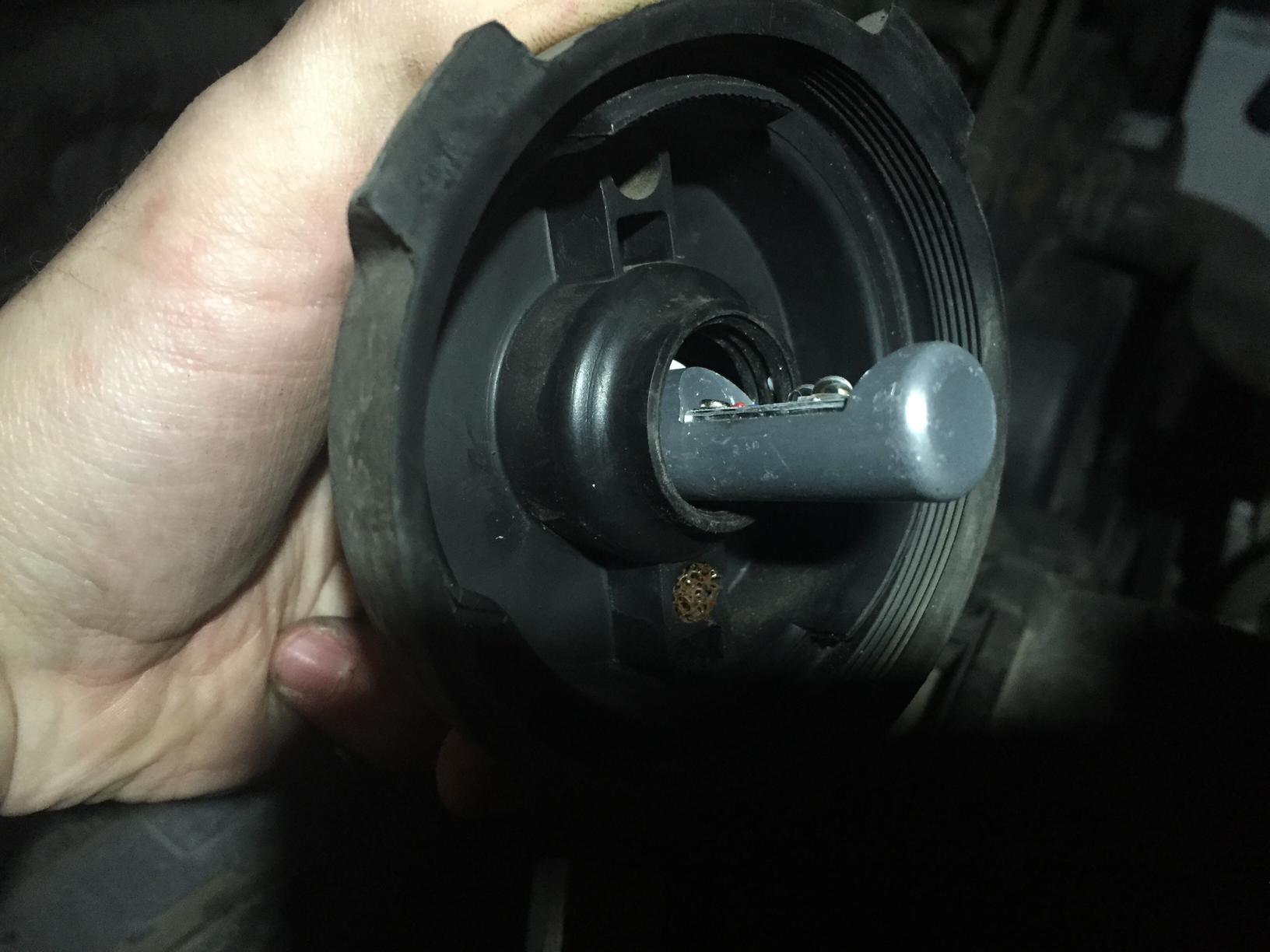

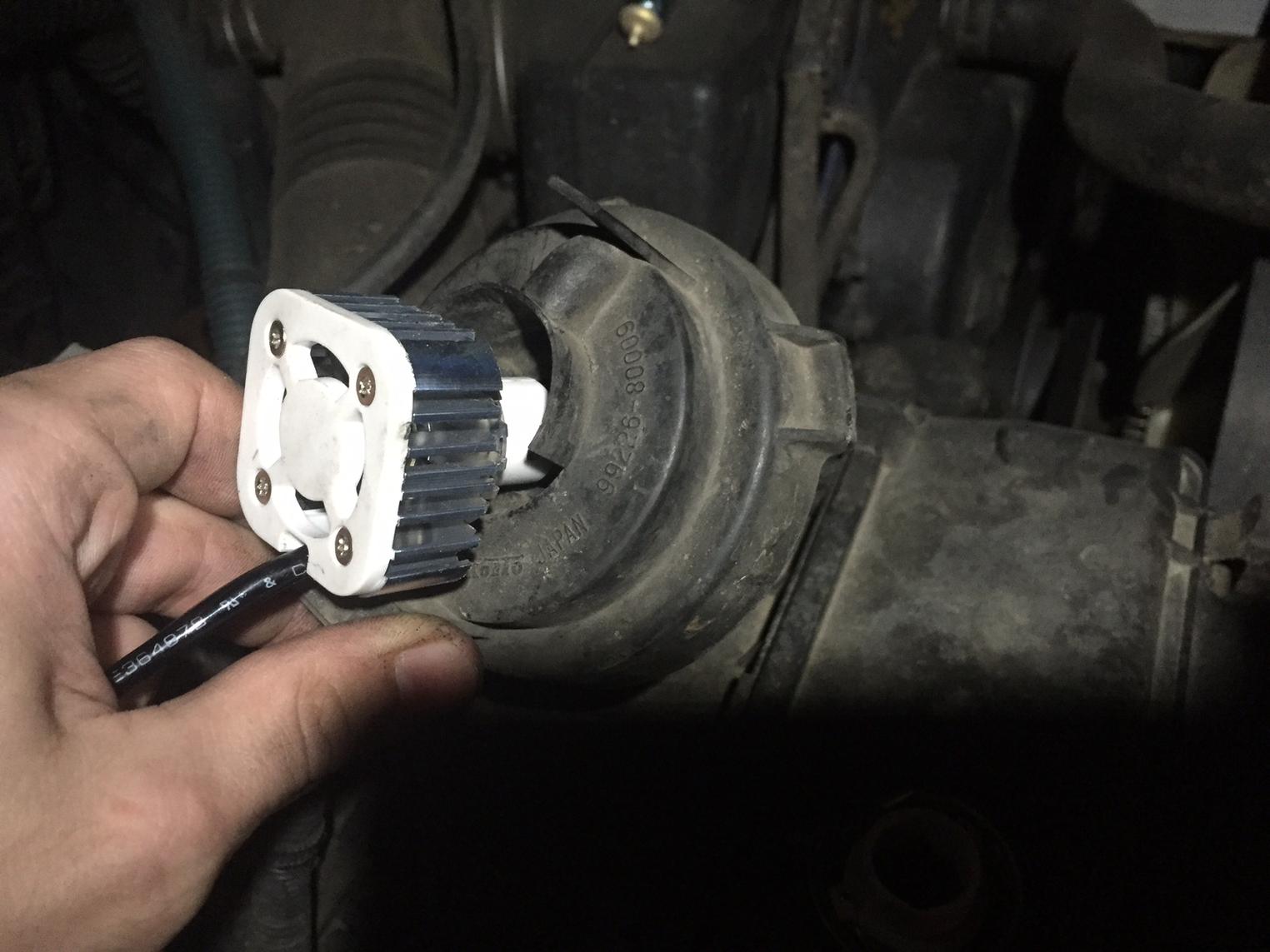

So the sylvanias burnt out finally and I now have an excuse to put these in. A few things are going on here that I don't like.
First, I'm stumped on how to make them work with the weather covers. See the pics. Should I just trim away until I make them fit? What about the heat sink? If that's exposed to the elements in pretty sure it'll short out, no?
Second, I had to disassemble the bulb retention clip because it wouldn't fit over the top of the heat sink. Now when it's clipped on the bulb has play in it it/moves a bit.
Help? I did plug the one on and ran the working sylvania and the led and its a huge difference.

Ok, so a quick update:
I was being a dingus about the retainer clip. Turns out you can actually remove the silver 3 prong light mounting plate from the rest of the bulb assembly, simply put that in place, attach that to the retainer clip and then insert the bulb and twist it into place. I can provide pictures if you need them.
Still not sure what to do about the lack of weather proofing though. Ideas?

Hello. We may be able to help you out. Attached is a pdf that was put together by one of our customers, detailing his install. He has some very good photos of his modifications to the dust boot that he made in order to maintain the seal. This was for the install of one of our H4 kits from Brite Ass LEDs | LED Headlights | LED Conversion Kits , but it may also help you out. Does your kit allow for the fan to be screwed off of the back of the bulb? If so, the install should be very similar. Good luck!

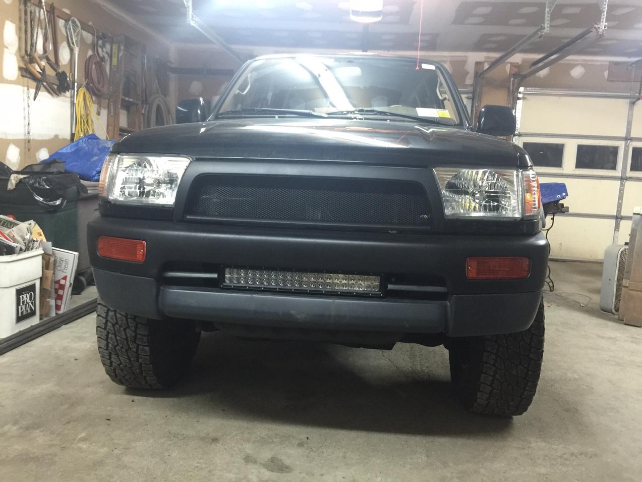

Just jumping in on this. Just installed exact same lights in my runner last night. Beyond happy with them. Again high beams could be brighter or maybe bolder but not at all disappointed. I suggest highly to anyone on the fence. Great clean color and crisp cutoff line. And matches perfectly to my 20" OKLED light bar installed tonight.

Could we see some pictures of the cutoff?
Thank you so much for posting this! This looks like it will work and I'll post results. I need to do this ASAP because I've been driving without the seals and it's been snowing here.
