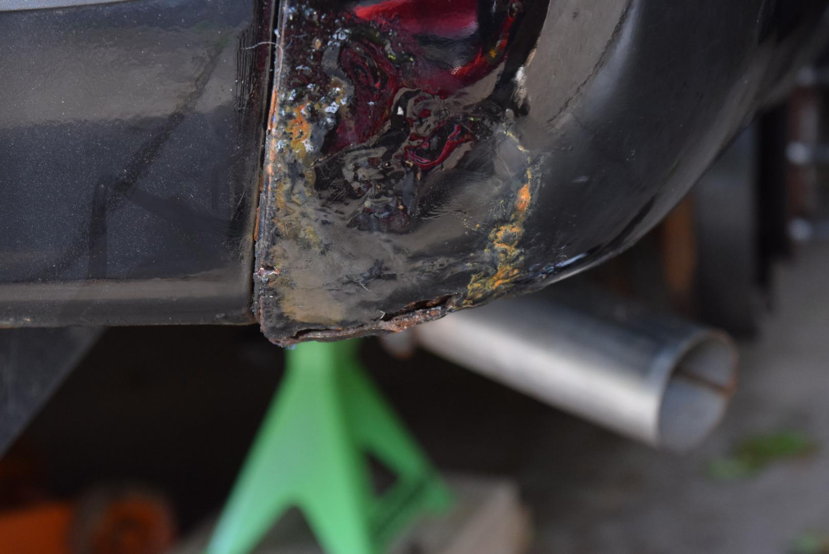

Thought I would chime in on the progress of the RH side bumper replacement that is over the exhaust tail pipe. Living in the rust belt this bumper rots out where snow and salt accumulate in the rear curved area. " See Pic Below "

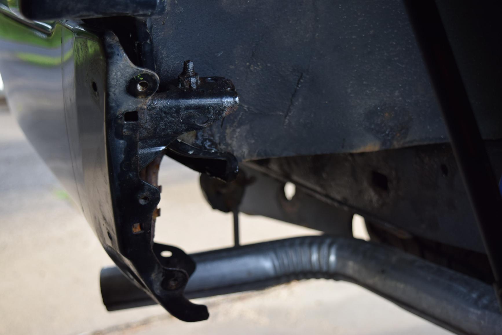

Back to the old bumper removal, dam tough in these parts as all bolts have rusted solid. Used PB blaster over night and a torch to remove 2 of the 3 holding bolts. One remains a problem that holds the upper part of the bumper near the tire ( see pic ). The bracket that this attaches to is secured at one spot allowing the whole thing to twist as I try to remove this bolt.
Looks like I will need to take the recip saw and cut the nut off as that part is attached to the bumper so no harm to the bracket, I hope?

This is the picture of the bolt that will not come out due to weak bracket!

I second the angle grinder. With a cutoff wheel. Sawzall will likely grab and bend metal. Just watch where the sparks go.

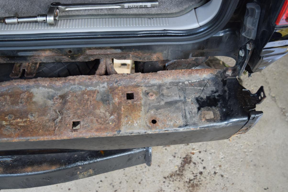

Well, there was one more bolt I had forgot to mention in the upper portion close to the plastic guard on top of the back bumper section. I had to remove the bumper guard and it was a good thing as I needed to clean up rust under it and apply Fluid Film to that area.
Note! I did not notice nor did the parts dept. suggest ordering the square plastic insert into the top of the side bumper but the old one was still somewhat intact so I reused it as the plastic shroud requires it to snap into.
PS: I did end up using the sawszall to remove the nut and cutting oil to help the blade do it's job without getting snagged!.

Yes be very careful with sawzall. Mostly they stick and shake the crap out of the steel. You can do more damage then good with those. Cut off wheels and angle cutoff wheels are the way to go. Mostly when the side bumpers rot, the rear is super close as well. Maybe you will luck out but I am never that lucky. I always paint the inside of the bumper with 2 heavy coats of rustoleum then when back on. Super soak it with fluid film to keep it from rotting out. :]

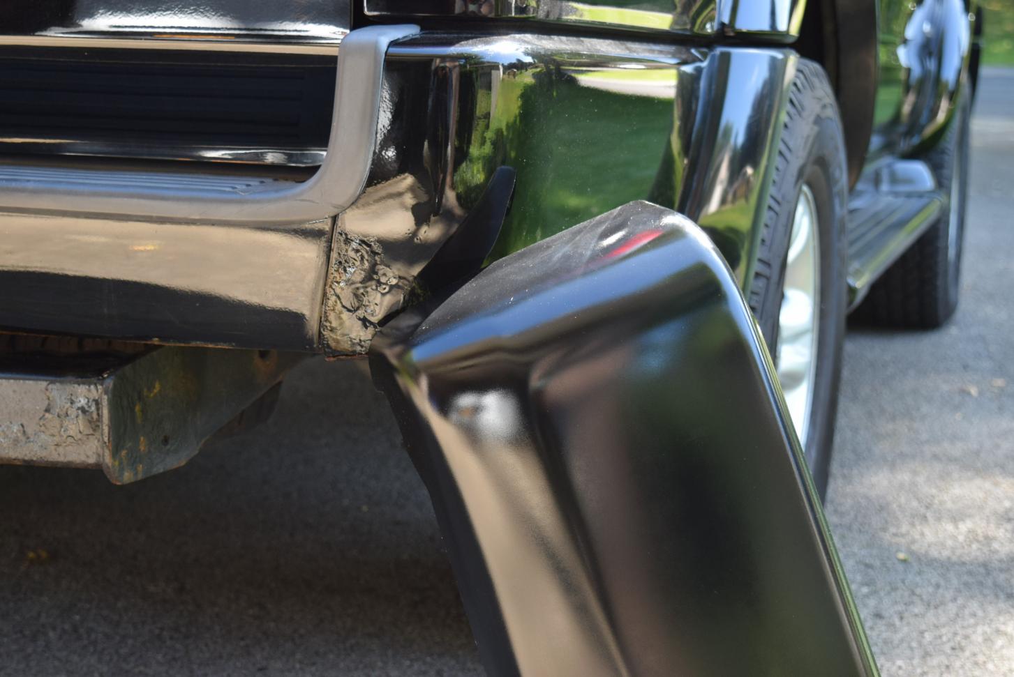

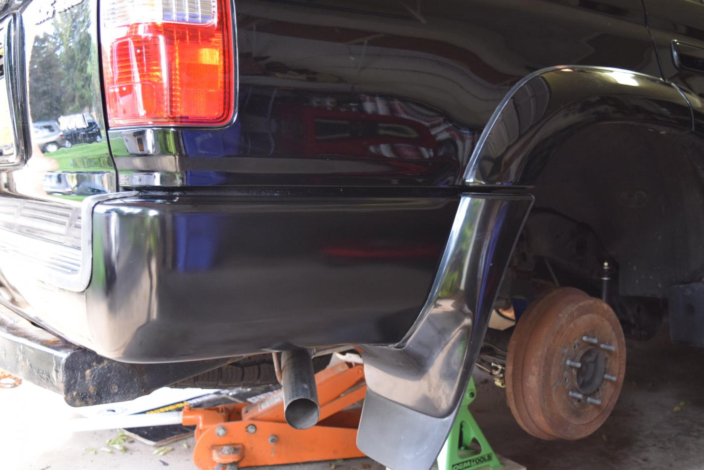

Well, for the first attempt not bad, it won't win any awards that's for sure.
Need to see what additional buffing pastes or waxes need to be done to get a
more mirror like finish? The aftermarket needed some shimming and one hole routed out a bit, but for the $40 cost a small price to pay imo. LMS
