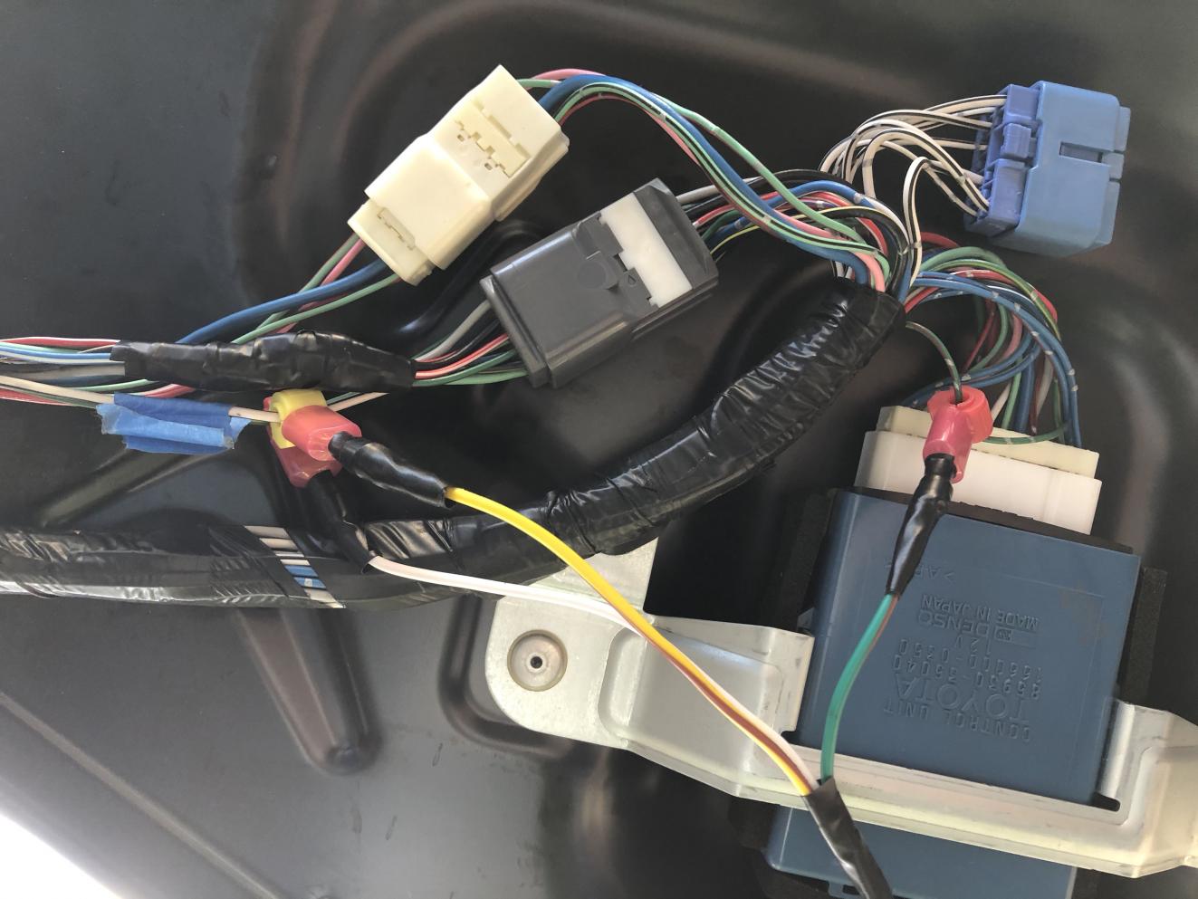

Just did this! Thought I would leave pics of where I tapped the wires by the relay as opposed to in the hatch. Also, here are the appropriate connections if using a factory switch with pigtail like the one in the write-up above. Ignore the color of the wires (red/green/yellow) that I used to make the connections...the color here is obviously arbitrary but I don't want to confuse anyone.
(Wires from Relay)-------------------------------(Wires from Factory Window Switch)
Green w/ Red Stripe: Up------------------------Green wire
Green w/ Yellow Stripe: Down-----------------Blue w/ Yellow Stripe
White w/ Black Stripe: Ground-----------------Blue w/ Red Stripe
Connections soldered
Here you can see the wires routed from the relay through the door and out the hole I cut (and lined with electrical tape)
