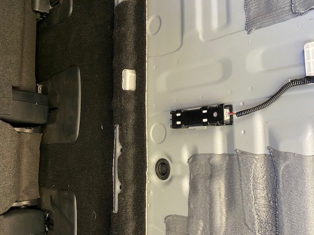

Occupant sensor
Hello Everybody!
The recent developments in this thread finally pushed me over the edge and I started the conversion. Although having mechanical ability, having been raised in Austria, I did not grow up to be a “car guy”, so this is very new and exciting to me and my questions might look stupid. After I removed the seats, I found what seems to be an occupant sensor. First removed it, but then somebody told me to better leave it since it could be a closed loop system. Any opinions and help will be very much appreciated.

Hello Everybody!

Weird, mine did not have this sensor.
Must be on the newer trucks as I don't remember seeing one in mine

It’s not an occupant sensor. It’s the rear key fob sensor, which enables a user to touch the rear hatch handle to lock/unlock the hatch or open/close the rear window.
