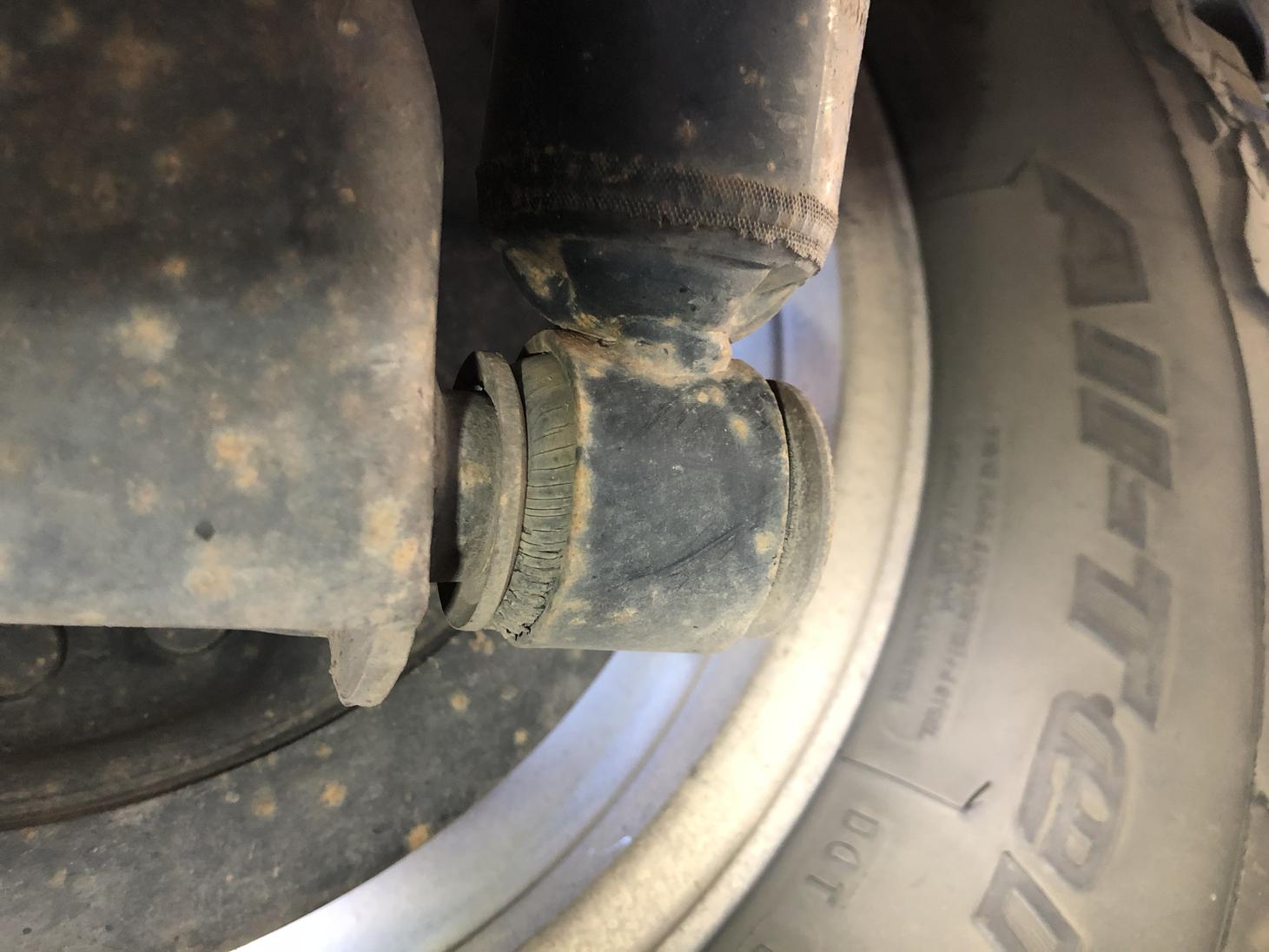

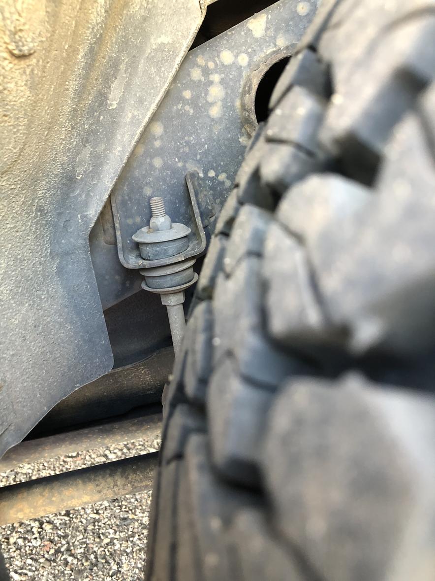

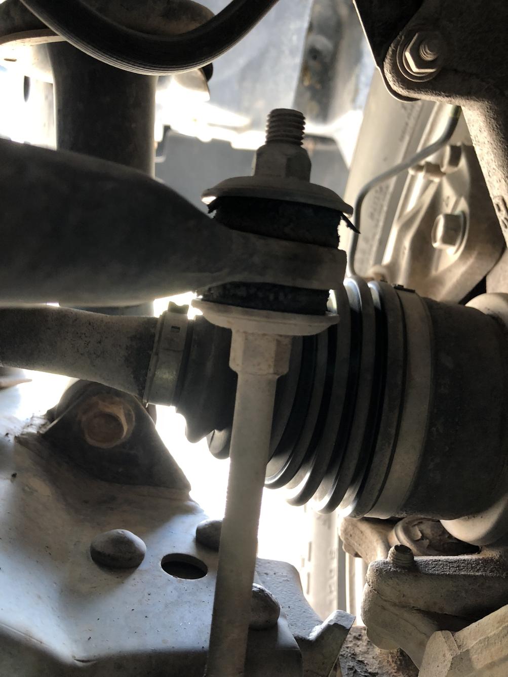

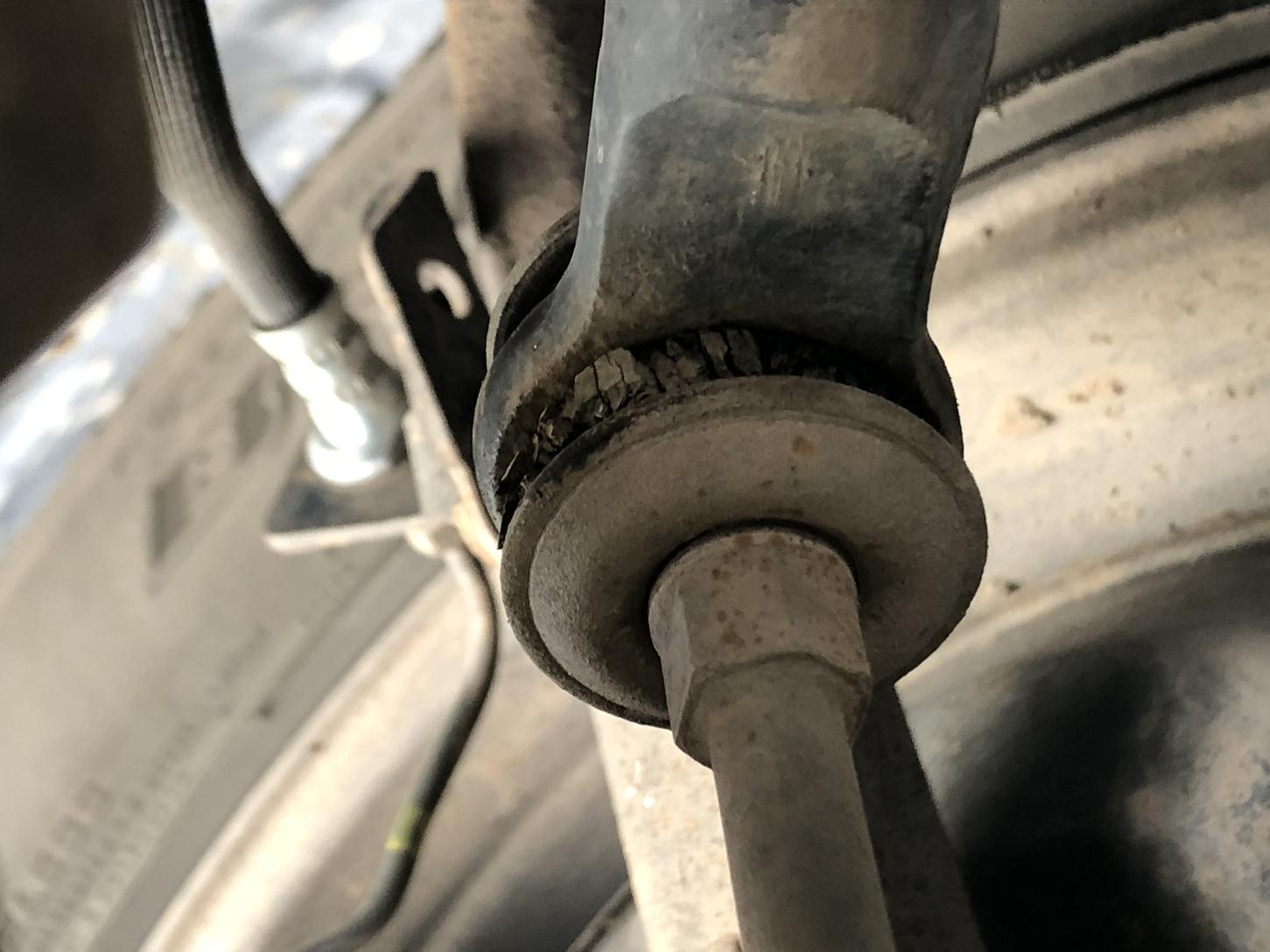

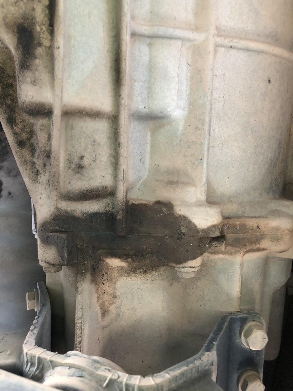

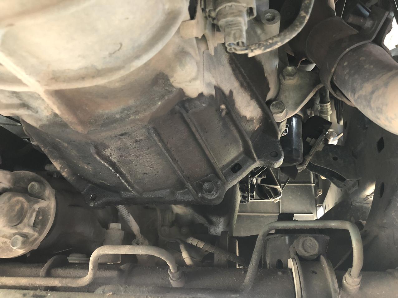

Ok I have a laundry list of fix it issues...I love this truck and I inherited it with many problems but it’s super low miles (160) for being a ‘98. Everything is original except for my spark plugs! I don’t even know if the timing belt was done! No paper trail on this one.
Bushings (front/rear) and suspension
They all look like dried out scabs....so I know I need to work on these. I’ve seen many helpful videos and chats about it, so I feel good about doing the sway bar and link bushings. My shocks are at their end and I want to add a lift of at least 2”. Any suggestions? People have told me Icon, King, or Fox....

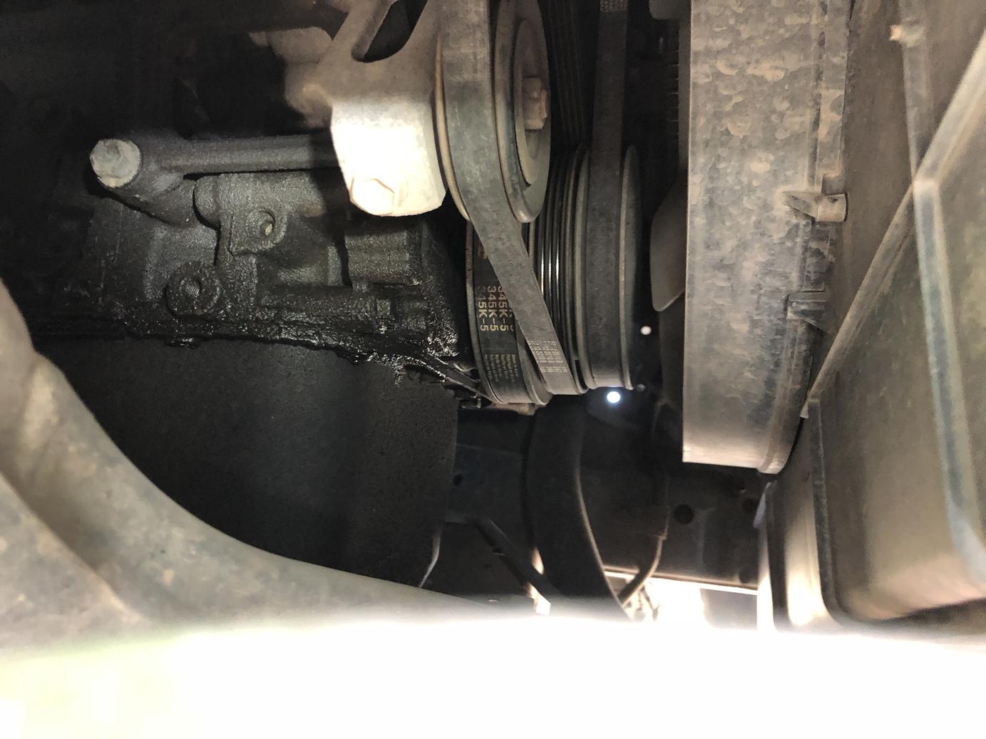

Transmission and engine seepage???
What’s happening? Gaskets??? :(
Any advice...at least the clutch is perfect. I’m really just concerned with how greasy the engine and transmission are...perhaps I reseal it with a timing belt change? $$$$!
Thanks

I don't see any leaks that would really concern me yet if it has not been cleaned in a while. I would clean it up and start watching drips and fluid levels.
One thing to add since you saved some money on the timing belt - the 3rz engines can be picky with their exhaust valves. Doing a valve adjustment would probably be a good thing if you do not know when the last one was done.
Thanks for the info. Best way to clean all this, just with a degreaser and rag?
