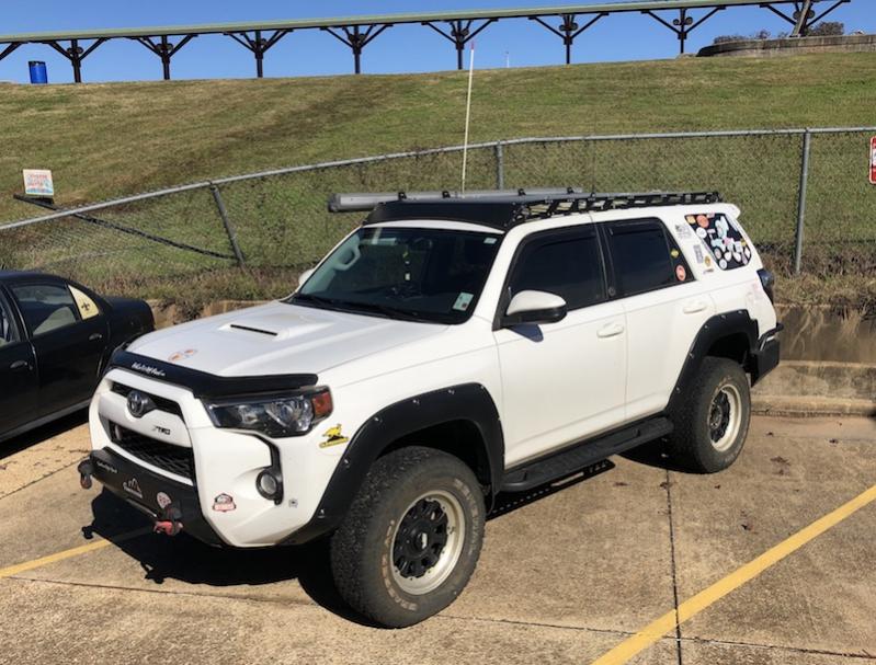

Then: 1/14/14
Now: 12/29/18. I will edit this pic as I add stuff, so you'll have a direct comparison.

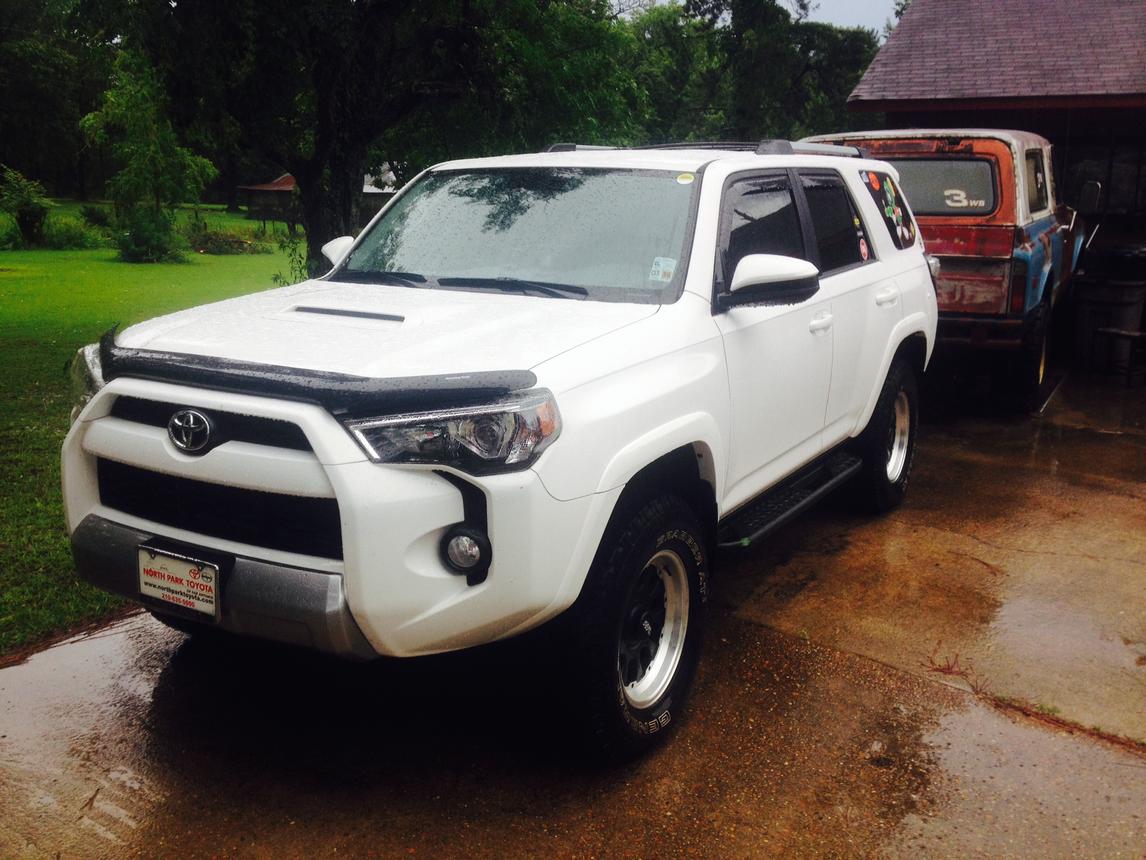

During my downtime on the rig I went surfing for aftermarket for my new toy. Everything I own gets a bug shield and vent visors, so off I went to Weathertech and ordered a set. I really like the look of the Nfab step bars on that SR5 so I ordered a set of those also. I like the looks with all of the roof baskets, but just wasn't ready to spend $500 - 1,000 on one yet. I found a Larin aluminum one on Amazon for ~$120 and ordered it as a sort of "proof of concept" to see if it was something I would use or not. I also ordered the missing crossbars for the Toyota roof rack at the same time. All of this stuff accumulated at my house over the next couple weeks waiting for my first home break from drilling. I had about 4 days to mount and play with stuff in mostly wet conditions so please forgive the pictures. I'll try to post better ones as I get time.
Bug shield and roof basket front.
Next on the list was a lift/leveling kit. I briefly looked at spacers for the struts but just didn't care for that idea. I looked at the Icon, Bilstein, and another couple options I can't think of right now, and decided the Bilstein 5100 adjustable setup was in line with what I was looking for in the price range I was willing to spend at this time. The kit was about $460 at 4WheelParts, and they wanted an additional $460 to do the install/alignment. But they couldn't get to it in the time I had so I went to the dealer I bought it from and paid about $100 more to have the work done. Way less than the $7,000 for the SR5 I had looked at. I had them set the front height at 1.75" and it looks like it pretty much leveled the ride, which is what I was looking for. To the top of the front and rear fenders now measures right at 35" with a couple hundred pounds of personal gear and tools in the back. It does appear to have an ever so slight tail down attitude from the side, but not enough for me to worry about. I need to adjust the headlights down now, and have read a couple good threads in here regarding that subject.

The latest thing was tires and wheels. Wifey has decided that I can have this year's tax return for a set, so knowing what my allowance was I went looking at several options. I kept coming back to these Black Rock D Window wheels because I like the way the titanium colored rim offset the black centers. They are 17x8 with a 4.5" offset so I knew I could keep the weight centered over the hub but still get a little wider stance to fill out the fender flares. I went with the General Grabber AT2's in factory sized 265/70-17 because they had a very similar tread to BFG AT KO's for roughy half the price, and they have a 60,000 mile tread life expectancy. Again I am expecting to put way more highway miles on them than off road. As much as I want to play in the dirt it's a matter of time and location. I had some help from C2one in photoshopping my fender flares black. I am trying to decide if I want to plastidip them or maybe do a Line-X job on them. I think I would like them better black, but I have time to decide on that.

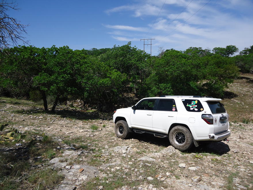

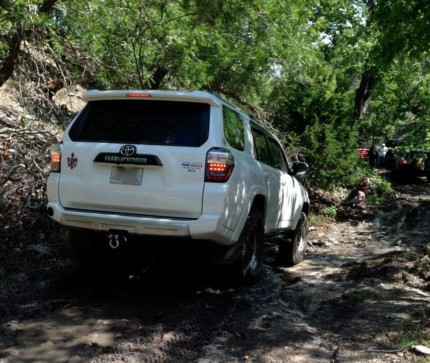

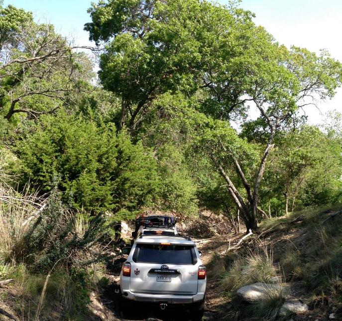

2 weeks after the Toyota Jamboree I met some Facebook friends at Canyons Off Road Park, north of Fredericksburg, Tx. Lots of fun. Canyons is 400 acres, mostly up and down or narrow trails through the bottoms. Rocks everywhere. Pretty technical, very low speed. Lifted setups would do better than mine and I was still able to do 90% of what the group ran Saturday. I even tried out the CRAWL function a couple times. That is a really nice function if you feel like you're in over your head. I have already figured out the Nfab steps have to go and I need to start looking at sliders if I'm going to keep doing these parks. I dinged the steps a couple times getting over obstacles and got a scuff on the rear bumper cap. I did opt out of a couple obstacles that just looked a little over my or the 4Runners capability, but I am new-ish to this too. I was the only 4Runner in the group. There were 2 FJ's, 2 80 series Land Cruisers (old warriors), and one Jeep Unlimited there also. I shot some video, but I have to chop it down to reasonable lengths so I can upload some.

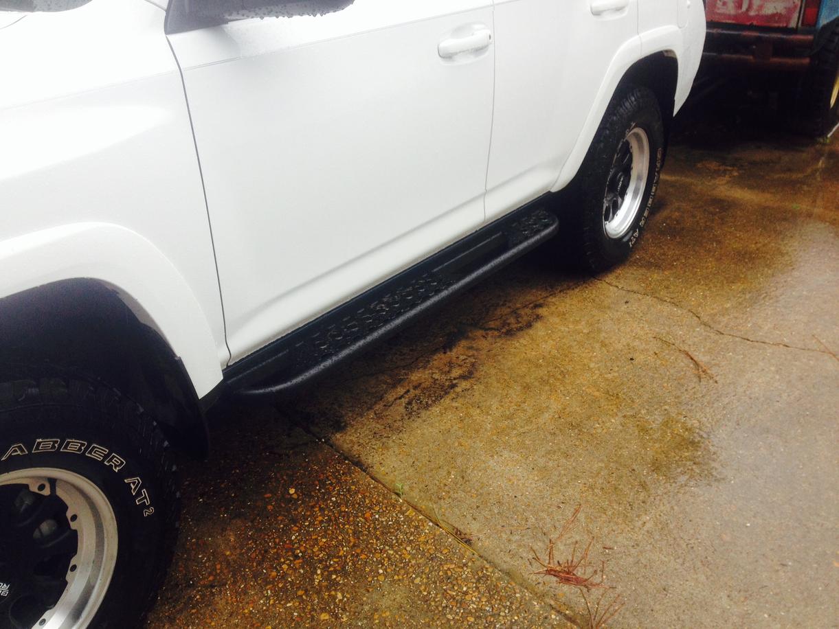

I picked up a set of unused Shrockworks Step Sliders from member harko last week. Saved me a 3 month wait. My nephew and I got them installed over the weekend in about 90 minutes. I hate to admit we spent about 15 minutes just figuring out how to get the blind nuts into the frame before my nephew spotted the plastic access covers.
Next on my list. A full length Baja Rack I will hopefully have by the end of this month. :art:
