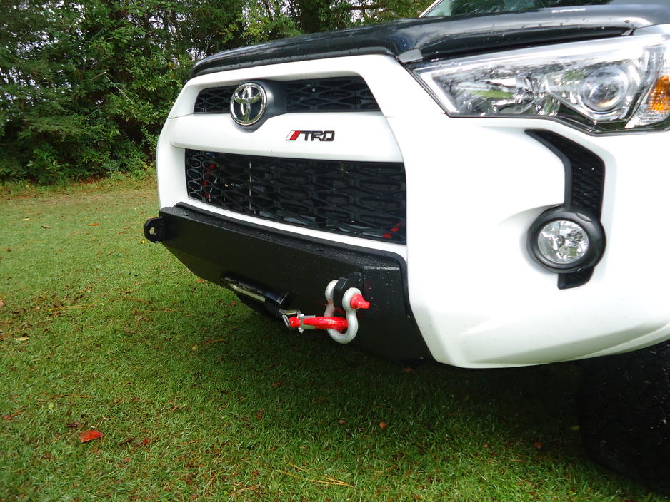

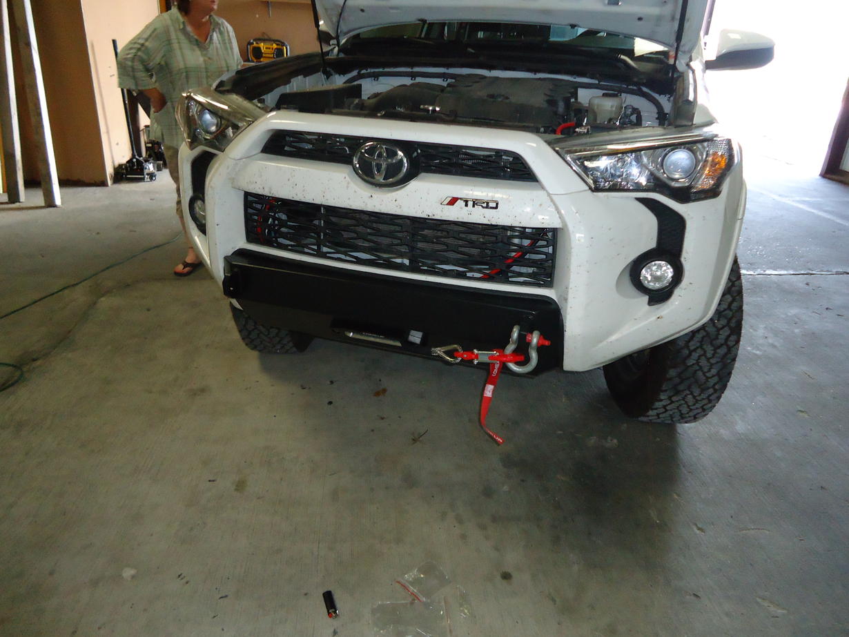

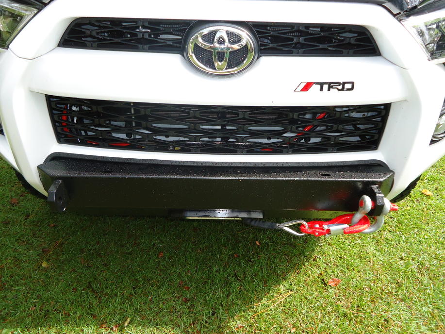

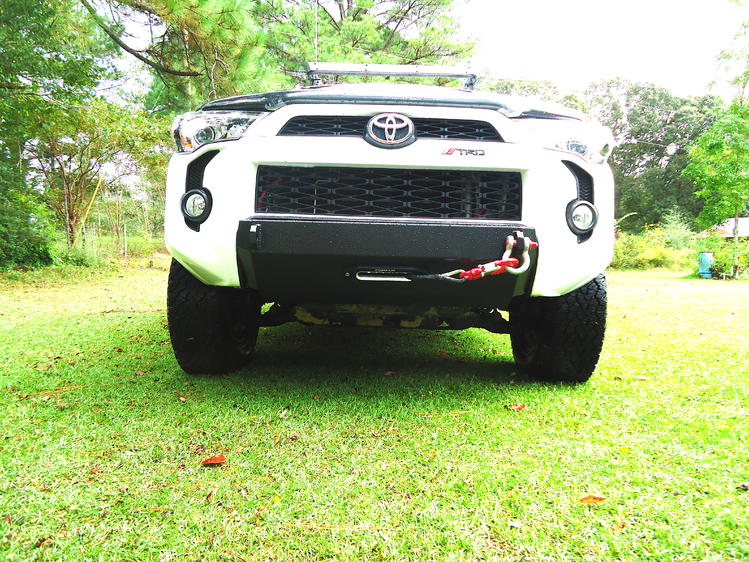

Spent a couple days down in New Orleans getting the SSS hybrid winch bumper installed and seeing the sights. Will post better pictures soon hopefully.

I brightened the low front shot to try and get a better view of the underside. And I have no clue why the 2nd picture is so much bigger than the others.

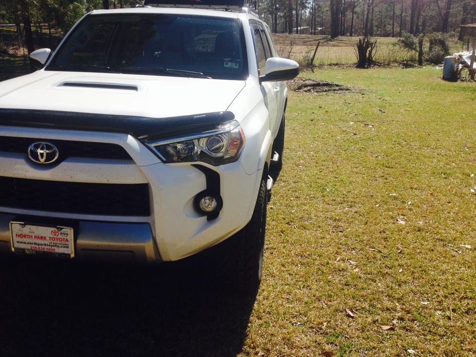

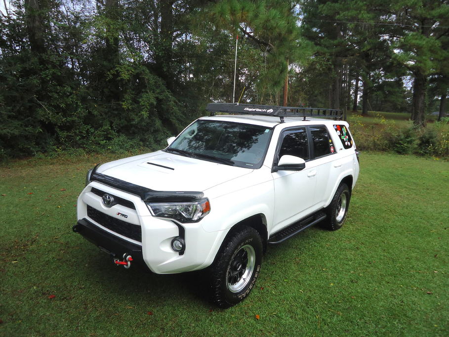

Left picture is fairly early on with Bilsteins at 1.75" front and 0 rear, tires and wheels, and Nfab set bars.
Right picture is after adding Shrockworks step sliders, Baja Rack, and SSS Slimline Hybrid bumper w/winch. I'm guessing an additional 250 - 300 pounds of steel with these add ons. Suspension has not been changed. I'm feeling the additional weight now, but it has not adversely affected the handling so far. The front end looks like it has dropped ~1/2 - 3/4".

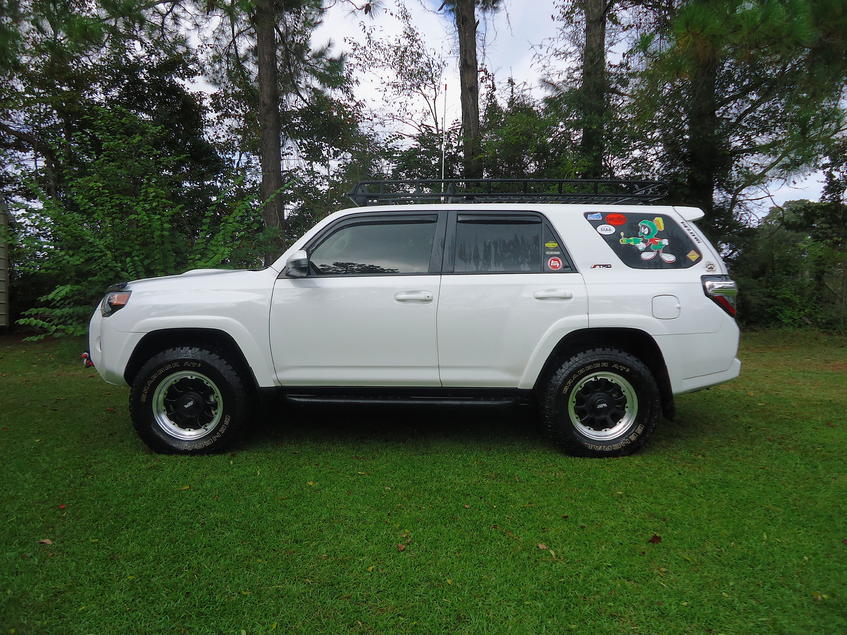

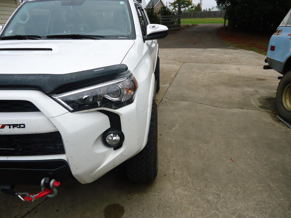

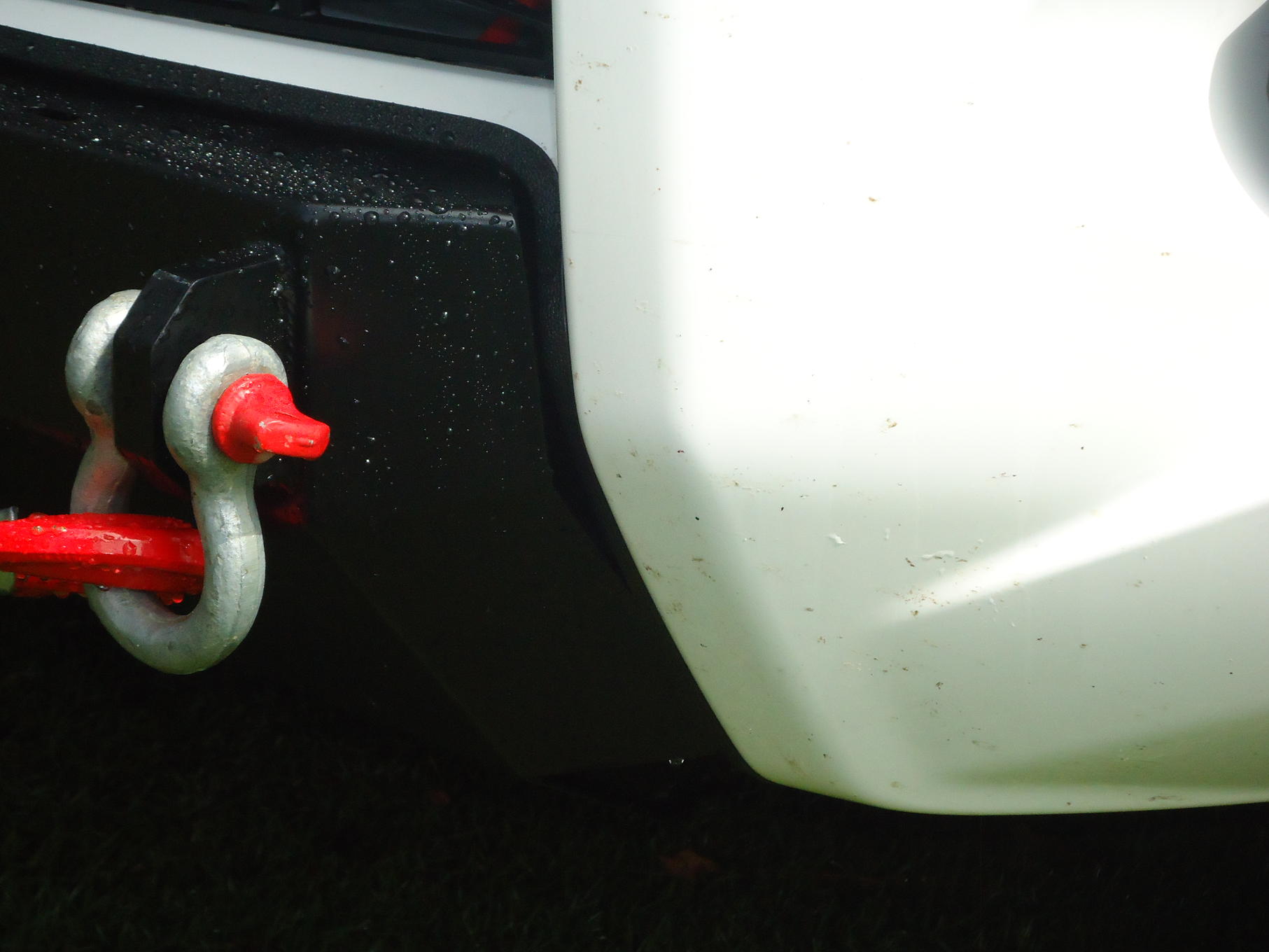

Added a set of Spidertrax 1.25" wheel spacers I've been sitting on. It's nice to have a few extra days off while they relocate the rig a couple hundred miles. Before and after pics. And it did make me finally do the front fender mod. I was pleasantly surprised to find the front fender skin could be cut with a sharp box cutter blade. I was marking where to cut with my handy dandy Swiss Army knife and it cut right in there. I didn't even have to go search for the Dremel (my wife and I both use it so it never gets put back in the same location.....).

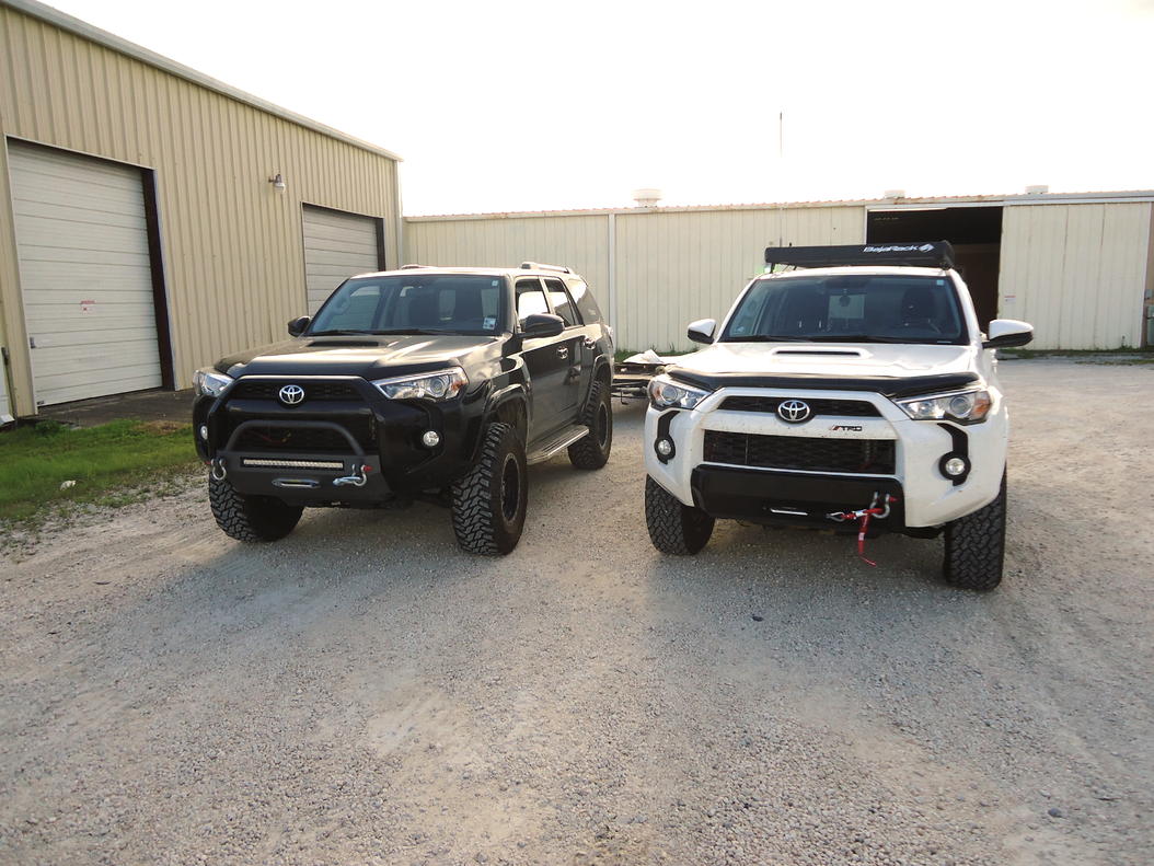

Looking good. Did you do the hub centric spacers?
Yes. I had been running 1/4" spacer plates up front to get my wheels away from the brake calipers. I bought the Spidertrax over the summer in 2 different purchases from people who opted not to use them. But even with the factory sized 265's I did have to do the front fender mod and the mudflap cutout. I'm getting 2" #885 OME springs and 1.25" Traxda rear spring spacers installed tomorrow, and I am working a deal to get a pair of Toytec 2" Superflex rear springs that another member removed for shorter ones.
Well I just purchased 2 sets. I had been contemplating getting some and your post was a nice reminder. Wonder how much more trimming I will need to with my 285s. I already removed the mud flaps and pushed the fender liners in. We shall see.
The amount of cutting/trimming all depends on the specific tire and its profile, as well as the individual vehicle to some degree (tolerance stack up and minor assembly differences). The good thing is that unless you get into a BMC situation, the changes are ridiculously easy.
I would actually recommend NOT trying to use a dremel. The plastic has a tendency to melt rather than cut. A good sharp razor or knife is all it takes (as mentioned :-)).

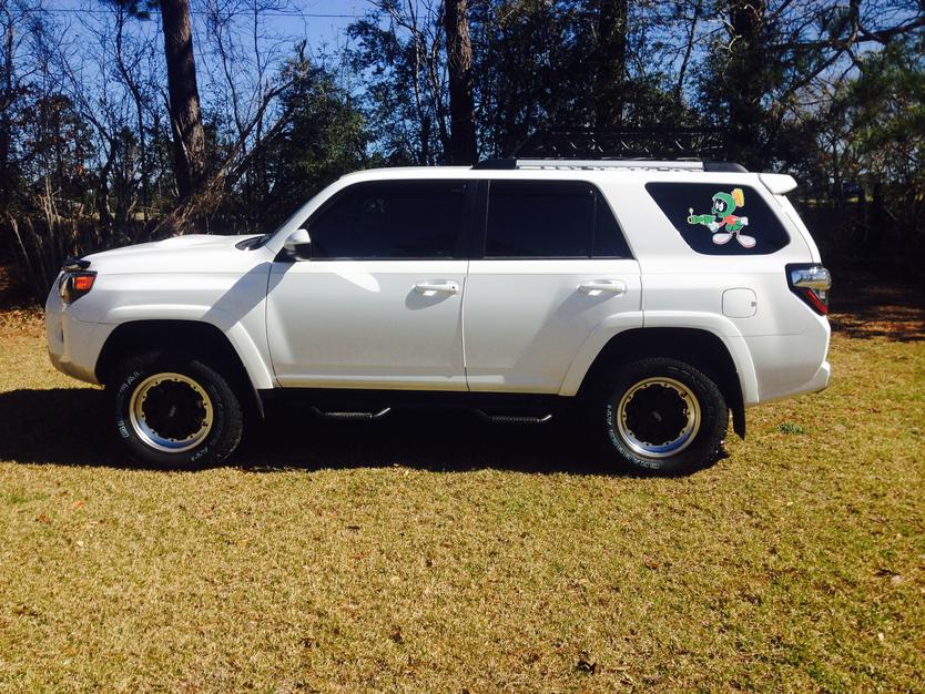

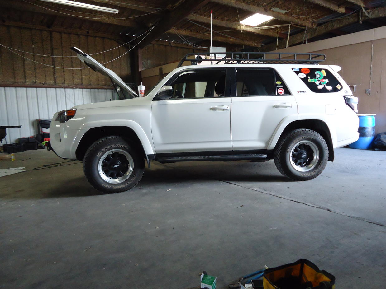

OME 885's added to the front and Bilsteins set at 0. Traxda 1.25" spacers added to rear. Finally........ Thanks [MENTION=66483]hrod79[/MENTION]. The ride is back to the progressive rate it had before adding the SSS bumper and winch. The visible difference is more obvious standing next to the 4R than it is in the pictures.

Taken in February after adding the Bilstein kit at 1.75" front and 0 rear.
Taken 10/11 after SSS winch bumper installed.
Taken 10/30 after OME install w/Bilsteins reset to 0 lift, and Traxda spacers added to rear.

Consensus on the forum says I should have gained 3" from stock. I measured a gain of about 1 1/4" over what I rolled up with. That is after I had them reset the shocks from 1.75" to 0 before installing the OME's. The bumper/winch combo dropped the nose ~1/2 - 3/4" basically taking the progressive "soft" part of the factory front springs away. It looks like it's back to a slight reverse rake after adding the spacers and the ride is back to what it was like before the added weight up front. Mind you I didn't have a problem with how it drove with the bumper up there. I just wanted my front level back. I am negotiating with another member to get his no longer installed Toytec 2" Superflex springs. So those spacers won't stay in the back for long.
