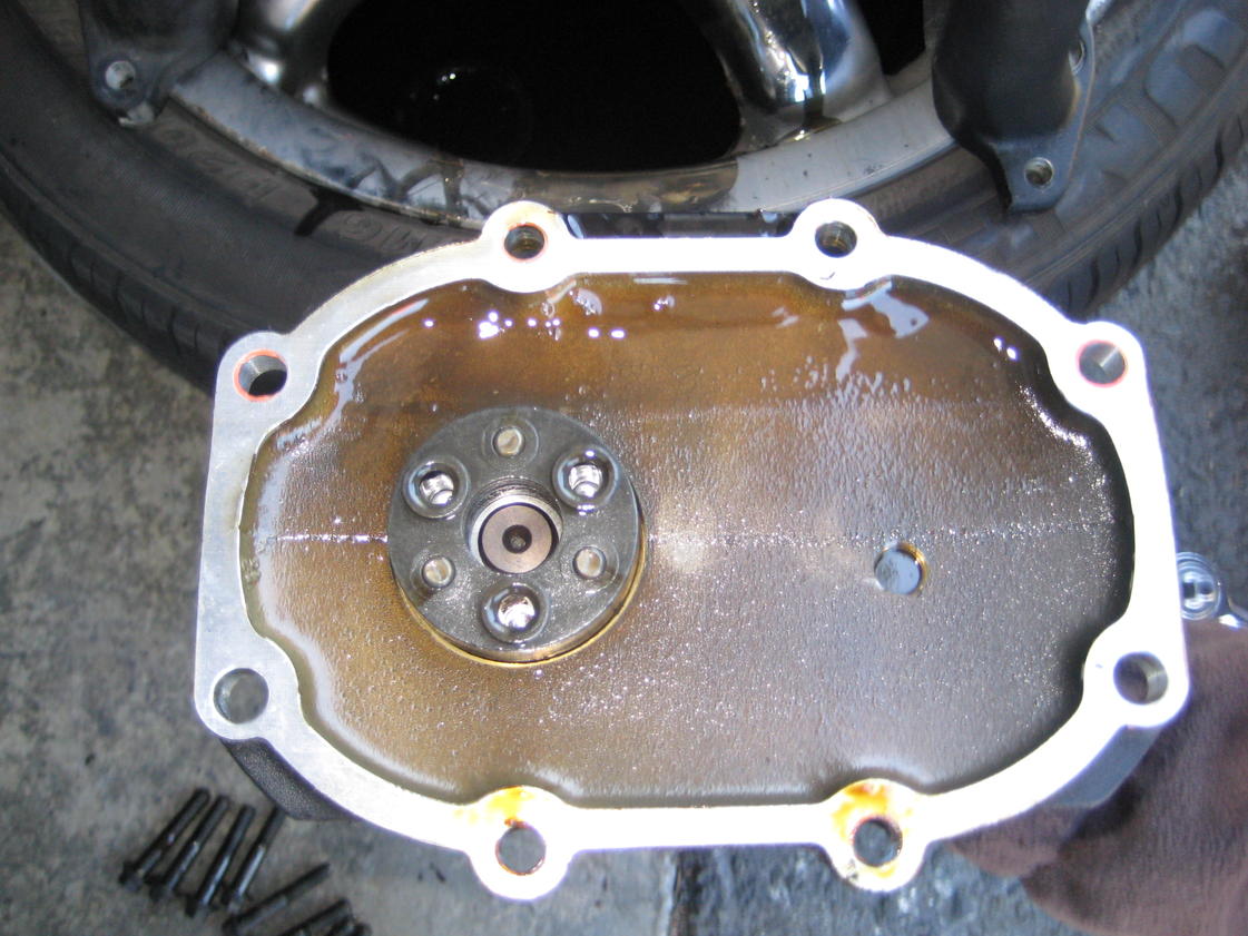

Here is a pic of the leak from the nose drive:

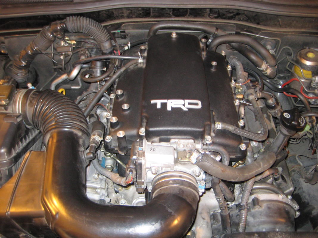

More pics.

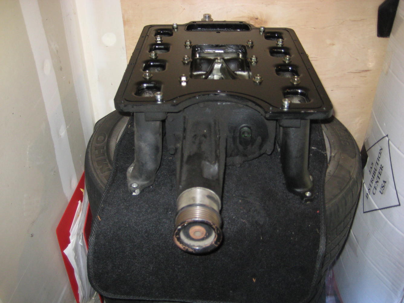

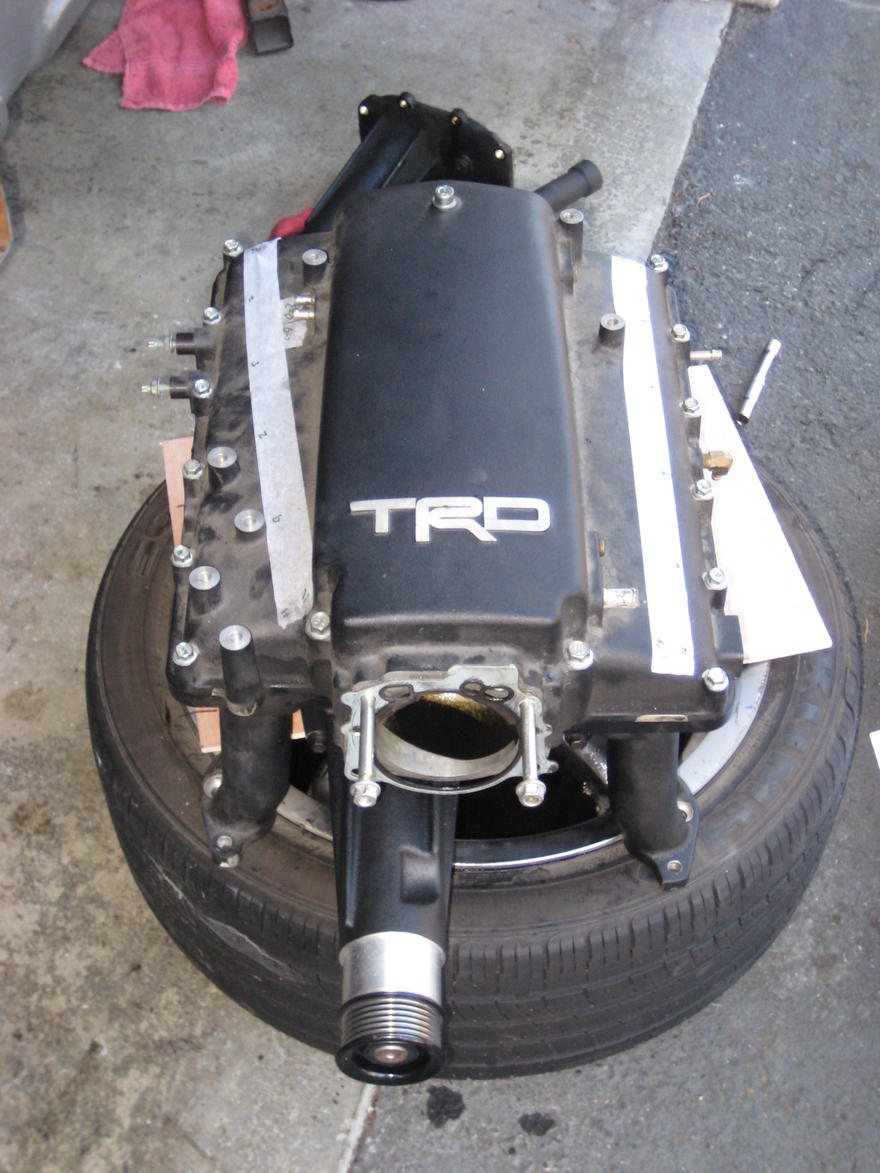

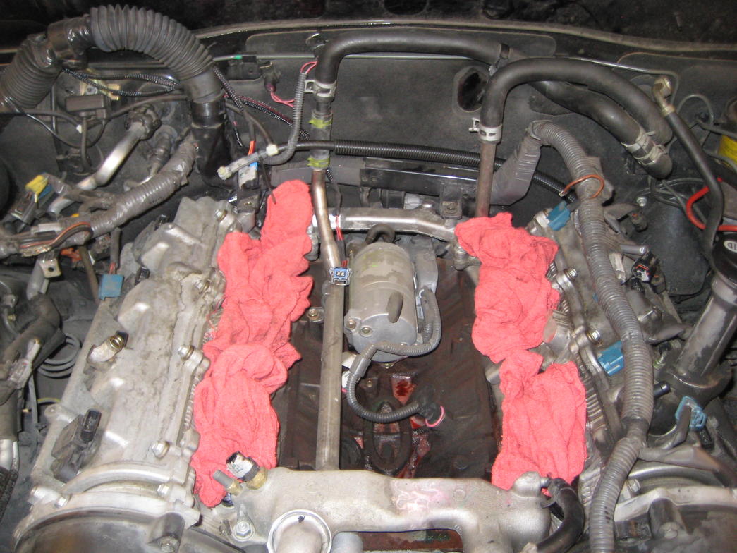

Supercharger taken off, rags covering the intake. Took about 2-3 hrs to take off the charger.

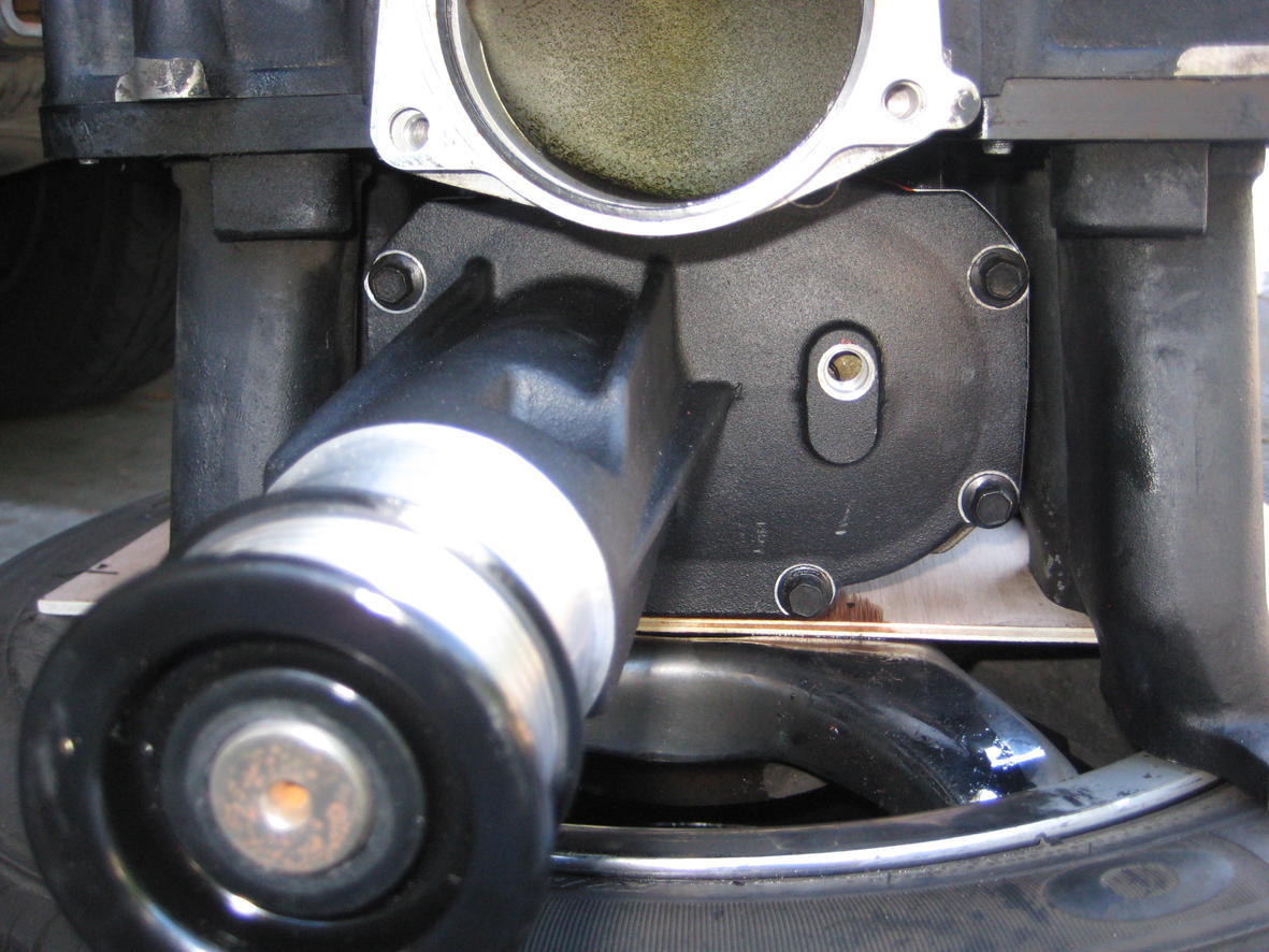

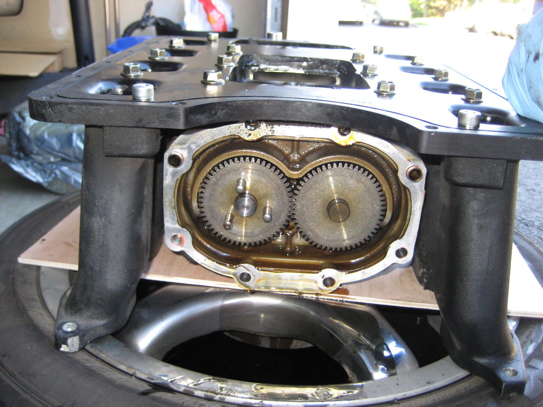

Back of the nose drive, showing the phenolic adaptor, which is a part that is replaced with the new nose drive assembly.

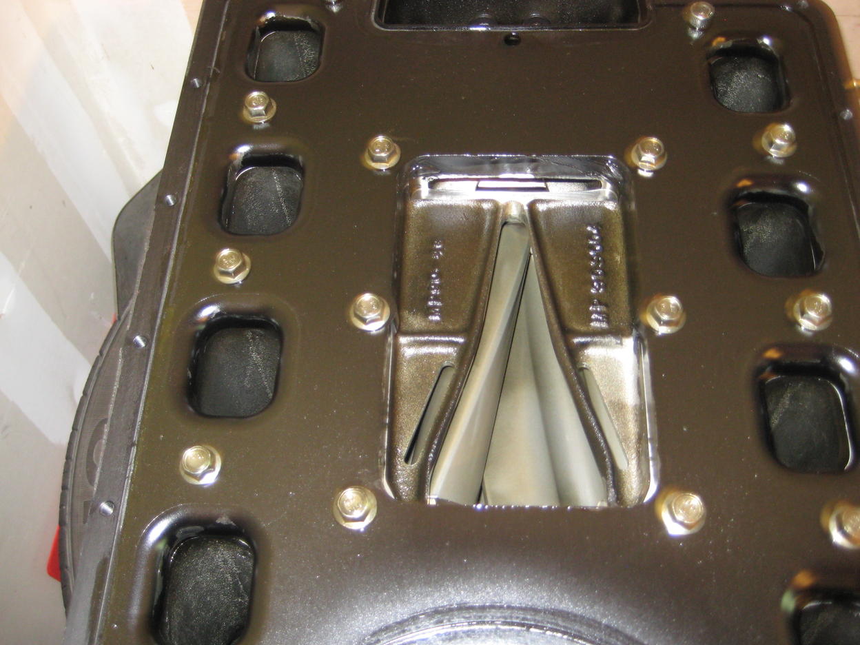

New nose drive installed. You can see the opening where oil is put in then a screw plug is placed afterwards.
