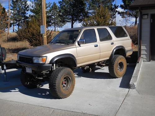

This is what a 4" SAS lift with 35's looks like. I realize you're talking about an IFS, but the spacing should be similar. Plenty of room for your bigger tires.
