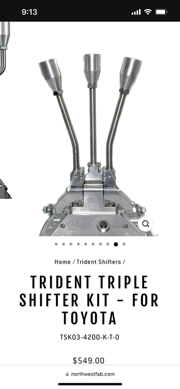

I really need to find another top-shift to do my duals; and think I might do 4.7 and 4.7 (I have a Lefty. [emoji51])

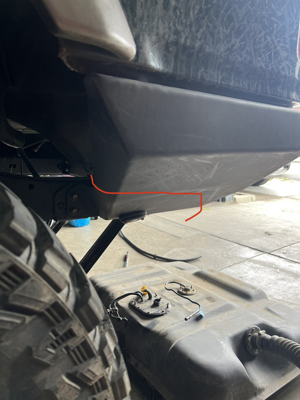

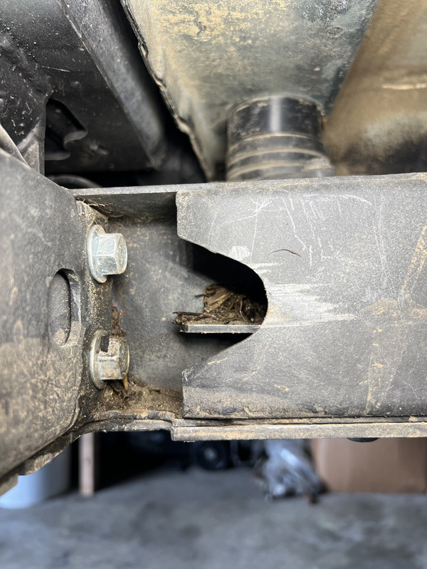

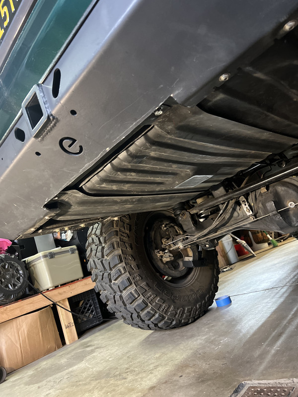

Couple things that I will be changing about the eimkeith bumper: 1. mud gets trapped really bad inside the driver side wing, most bumpers are open at the bottom there with a tube support going to the wing from the frame. 2. The fuel tank brackets can’t be removed without removing the bumper, if I have to change the fuel pump I don’t want to have to drop the bumper.
You can see how full the wing of the bumper is with mud through the hole in the frame.
This is where I want to cut the bumper

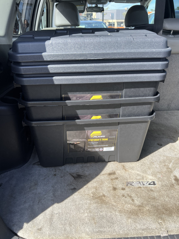

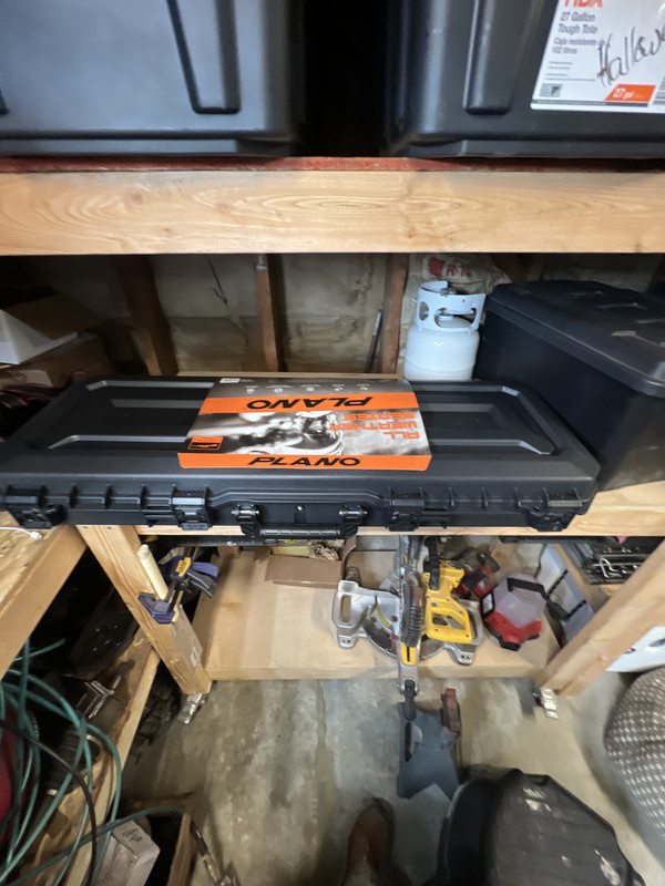

Got some Plano bins from Home Depot, pretty happy with these and the cost wasn’t bad at all.

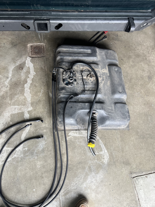

Finished the AN lines for the fuel tank, haven’t tested the lines yet but they seem like they will be good.

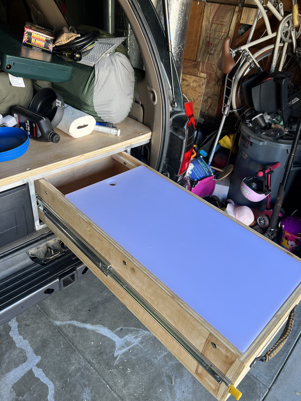

Made a cutting board top for my drawer

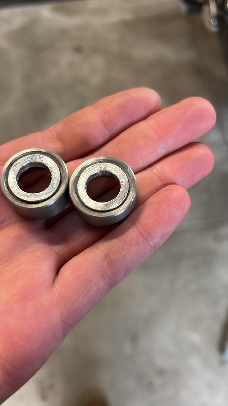

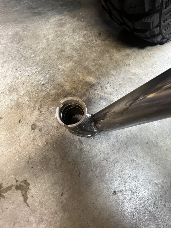

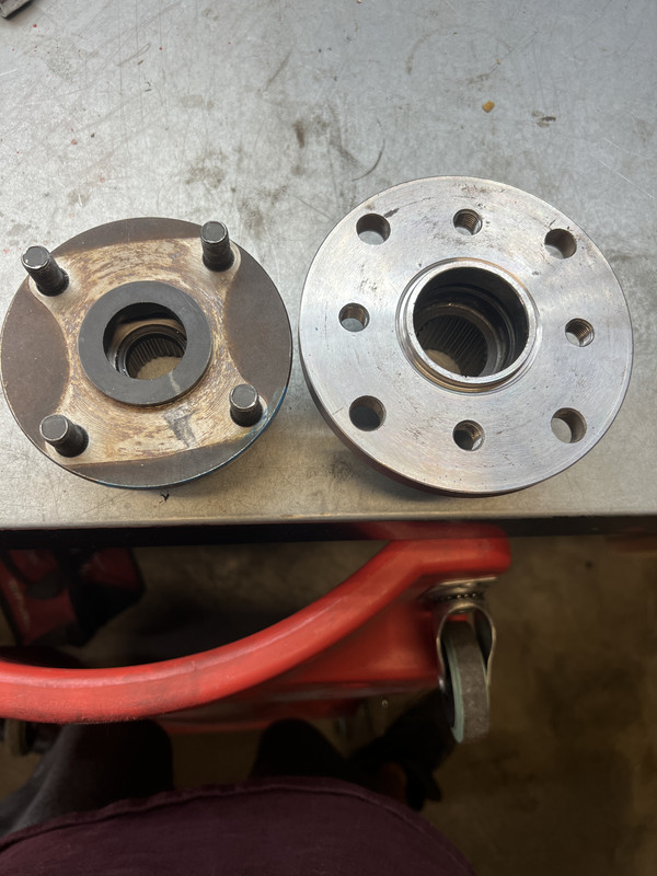

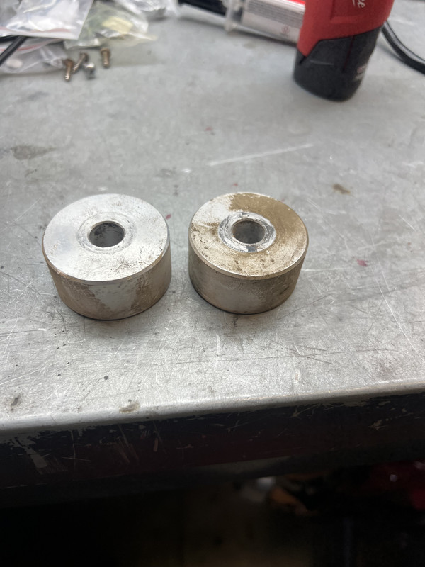

Got my driveshaft flange bushing made out of steel, my boss helped me turn it on a lathe at our shop.

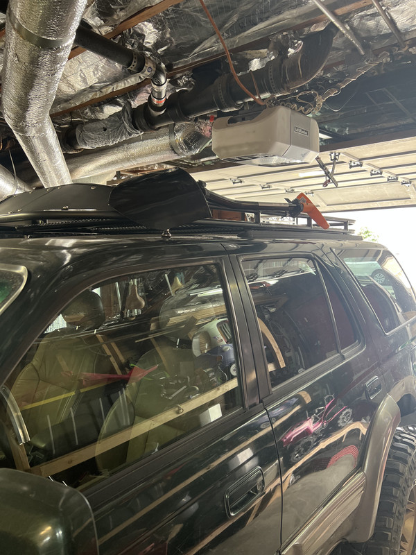

Got a cheap Fiskars shovel mounted to the roof rack, foldable smittybilt one wasn’t cutting it.

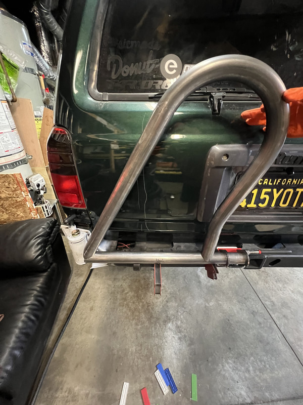

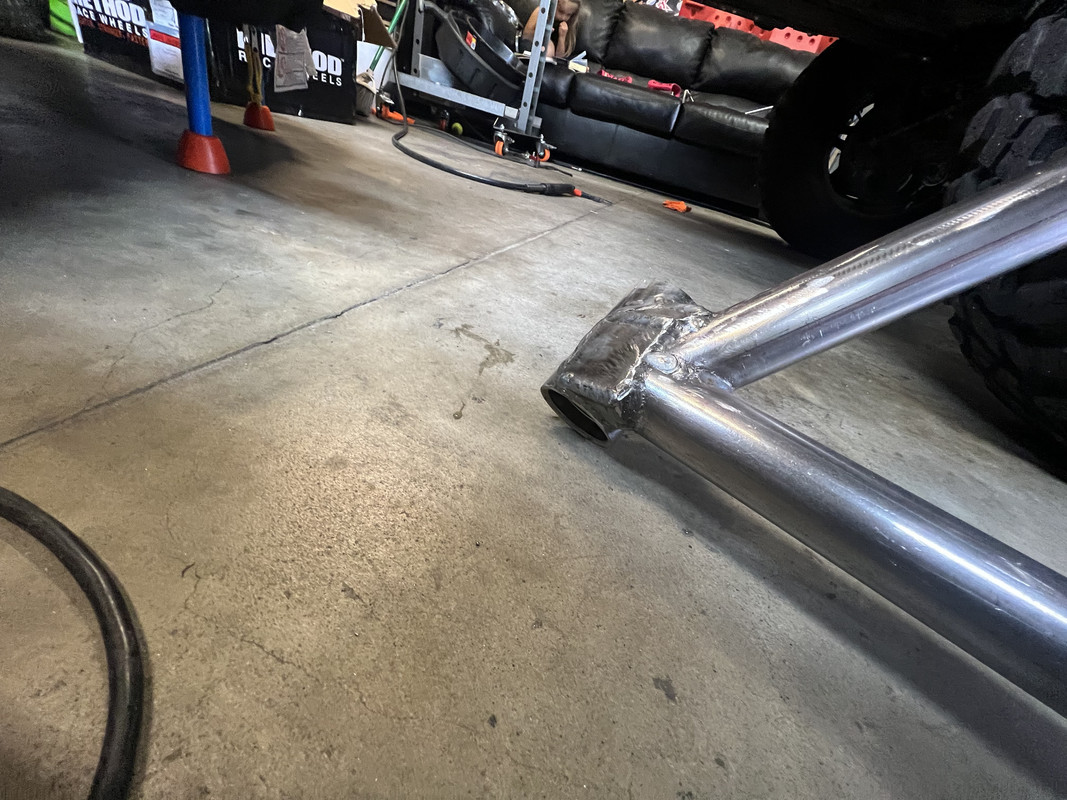

Last but not least I welded in some tubes in the frame for the front bumper, every time I would use my winch the bumper got sorta loose at the front through bolts. Also pushed the bumper in about 1.5” or so. Was a lot more cutting than I thought it would be lol. I might make a plate for the top of the frame on the addicted offroad crossmember and through bolt one of the back bolts eventually too.
I was also thinking about this one, I have not gotten into a spot where it would load up with mud but I'm guessing you could add 400 lbs into the wings in a very short time.
I would also like to be able to access the rear body mounts without breaking my wrist.
some holes are needed, glad to see you got the tank sorted. I'm doing the last fitting on mine right now. will post a build entry and a video of what I ended up doing.
Good point forgot about the body mounts, definitely want those accessible. Wondering if it will be easier to route my exhaust out after I make the chop, somewhat loud in the cabin with the muffler turn down. If it’s still difficult then I might just add a resonator like yours.

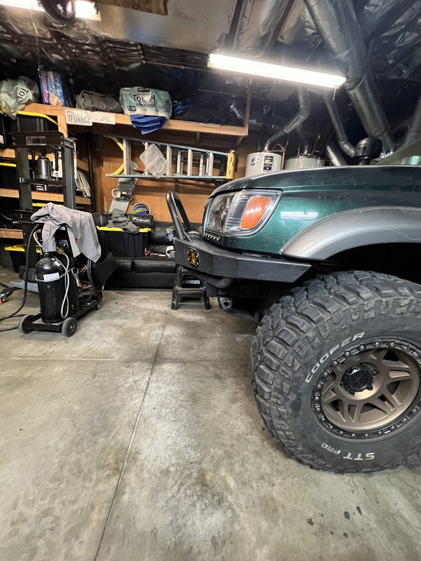

And here’s another update, some 4runner mostly tool/shop stuff.

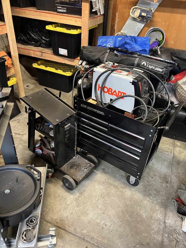

Made my old 5 drawer HF mechanic cart into a welding cart, shortened and welded a tank mount on the side for the gas. I’m really pleased with how this came out.

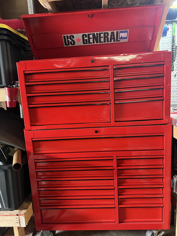

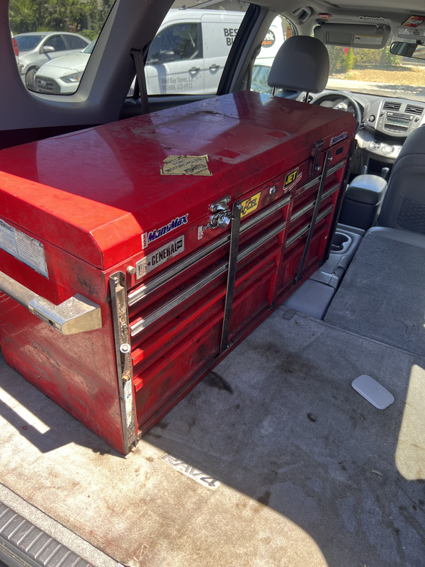

Picked up the lower matching box for 300 and grabbed this for 150. Pretty beat up, lower box was mint though.

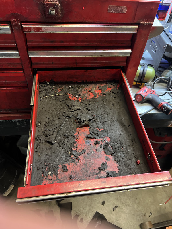

Glued in drawer liners were a PITA to get out. Please never glue your drawer liners to your drawers.
Cleaned it up welded/bondo’d and painted all the holes, installed new soft closing slides. Ton of work but pretty satisfied with the results.

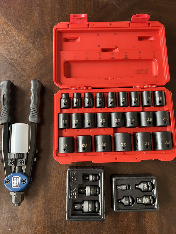

New tools for the toolbox (needed the rivet tool for the drawer slides)

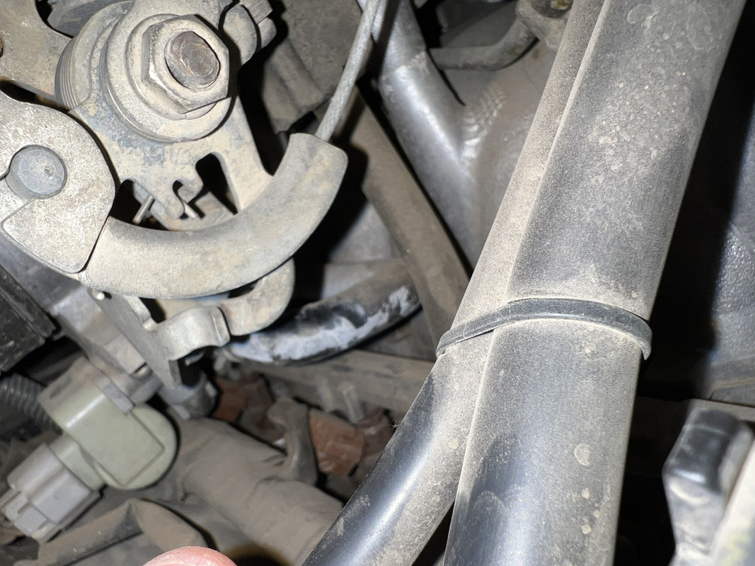

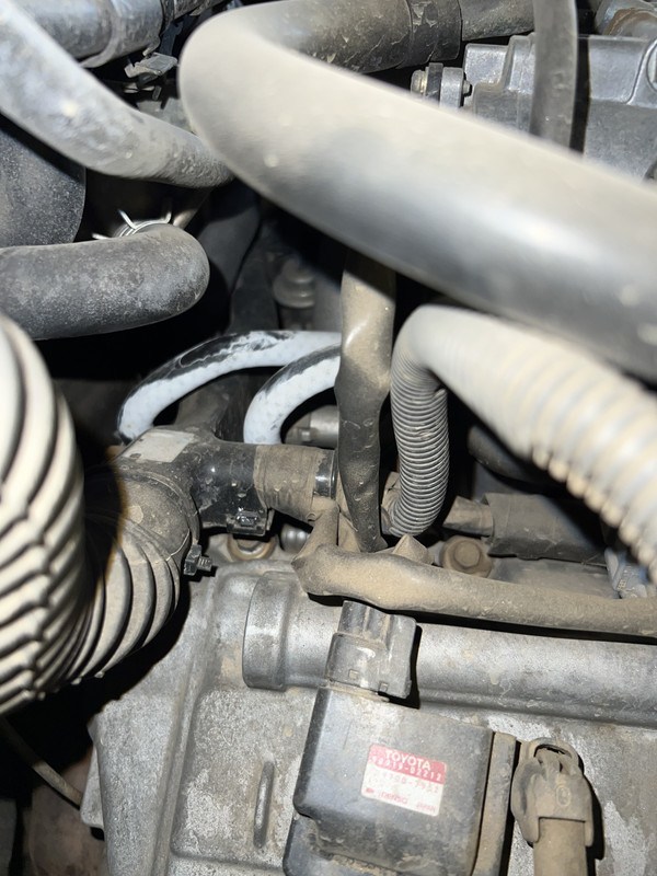

Coolant hoses under the throttle body turned completely white (seems like coolant permeated through or something). I’m thinking this might be because my coolant overflow tank is slightly overfilled? Coolant overflow tank hose is also white.

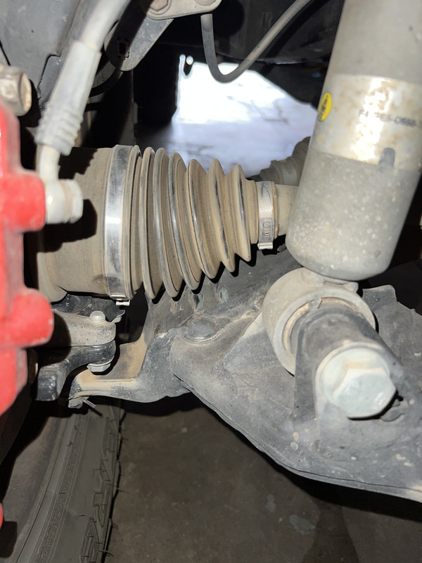

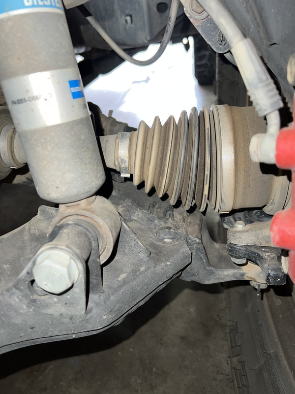

Has anyone else experienced this? 3 of the ribs on both of my cvs are rubbing on my eimkeith LCA reinforcements at full compression. Can clearly see the paint rubbed off on the LCA to bare metal and the clean marks on the cv boots.

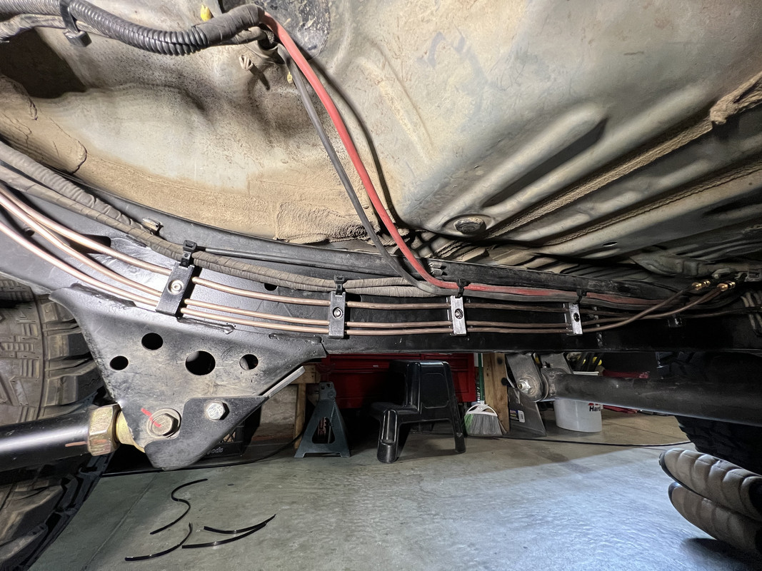

At this point I think I’m just going to use this copper/Nickel hardline and call it done, relatively cheap and I already have all the compression couplings at my plumbing shop so all I really need is the tubing itself.
Almost 4 months later the lines are still sitting on my work bench lol. Anyways bit of a solid update with more to come still. Got the radflo suspension in, got some stuff to clean up my auxiliary wiring, and figured out my ITRs are completely toast (last suspension/steering piece that I haven’t replaced).

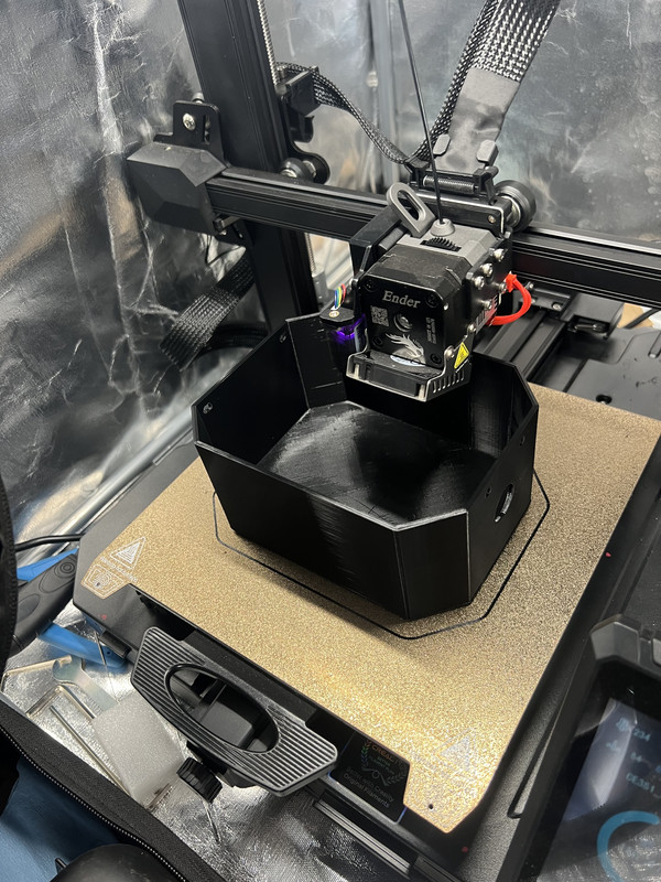

I got an ender3 s1 pro 3d printer, been pretty useful so far. The auto bed leveling is garbage but the printer itself works good.
Side panel flush filler pieces

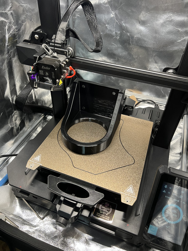

Printed a mount for my m18 leaf blower

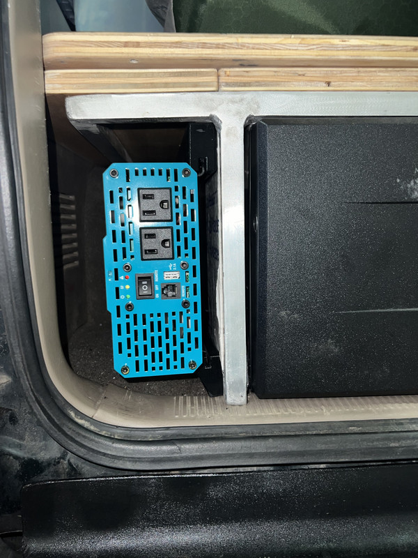

Made mounts for my inverter so I didn’t have to remove my platform to mount the inverter

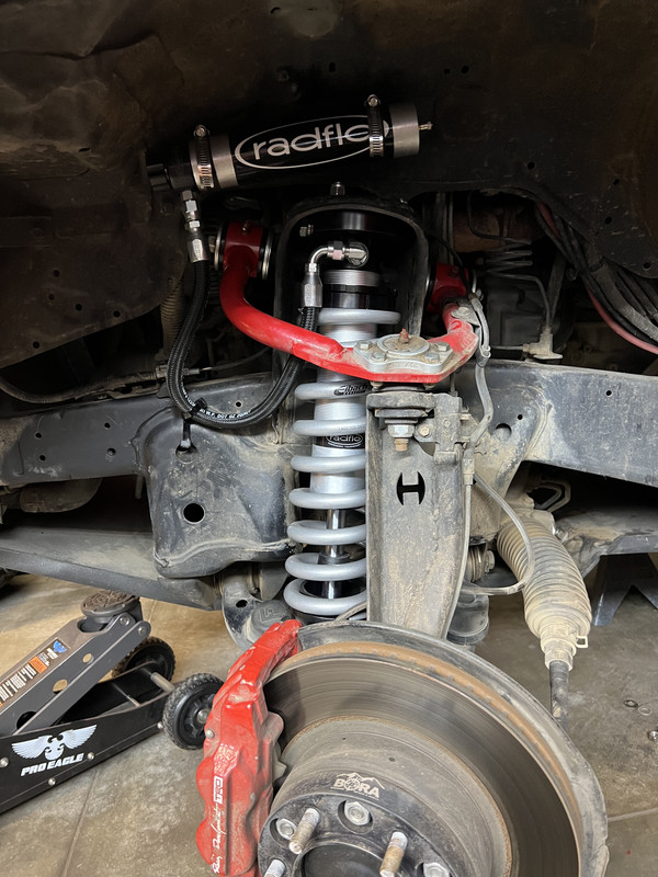

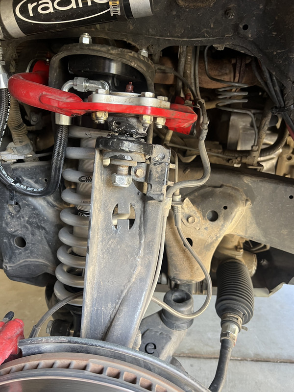

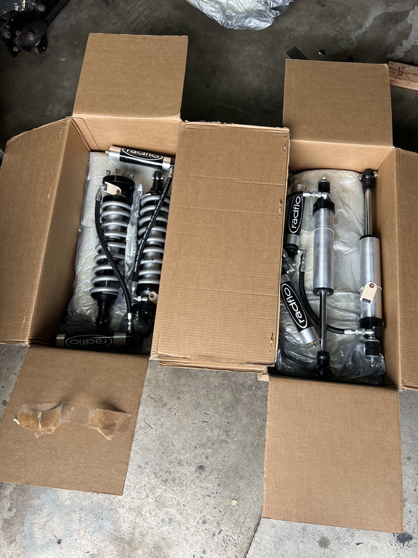

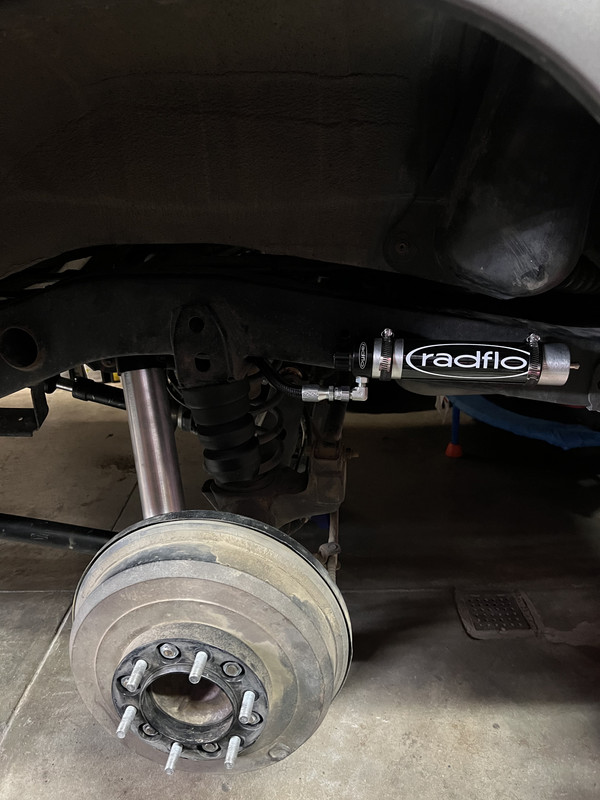

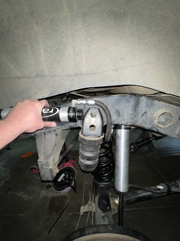

After about 4-5months of waiting finally got my radflos, 2.5” w/resi and adjusters front and rear.
Must of tried 10 different orientations before I landed on this one for the resi’s, feel like it’s a weird spot for them but that’s how it shows it on Sonoran steels instructions.
Rears had their own struggles as well, had to make a custom bushing that goes inside the lower mount bushing because they were just a tad too long. Also not pictured but I got snowbound lower shock mount skids as well.

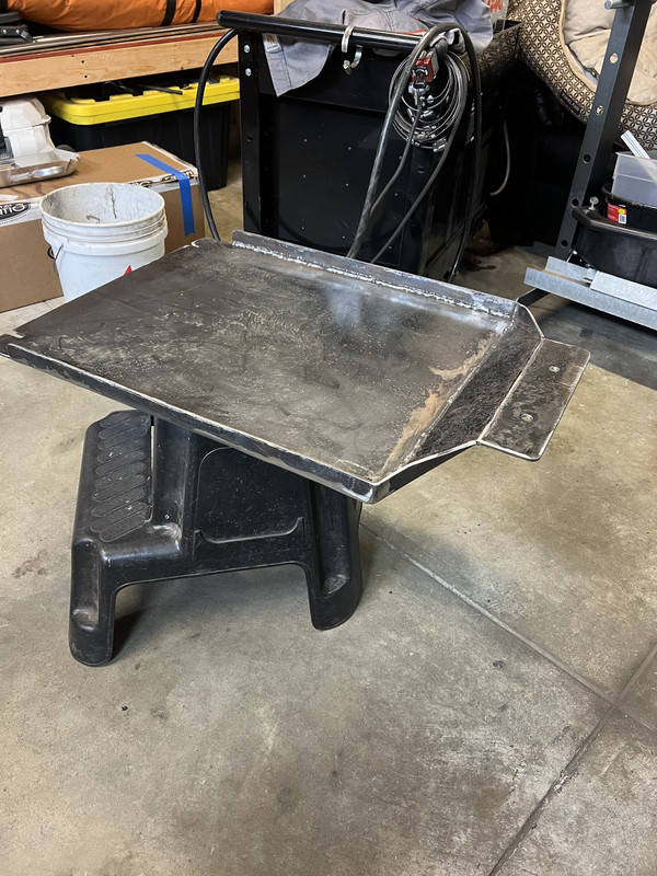

Finally made a skid for my dual tcases, still needs paint lol.

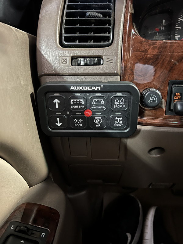

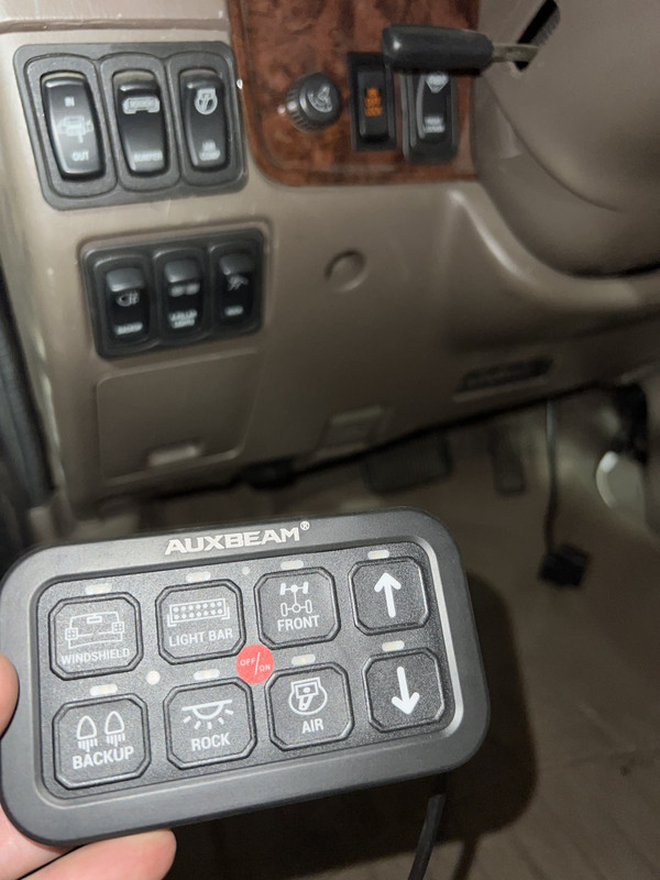

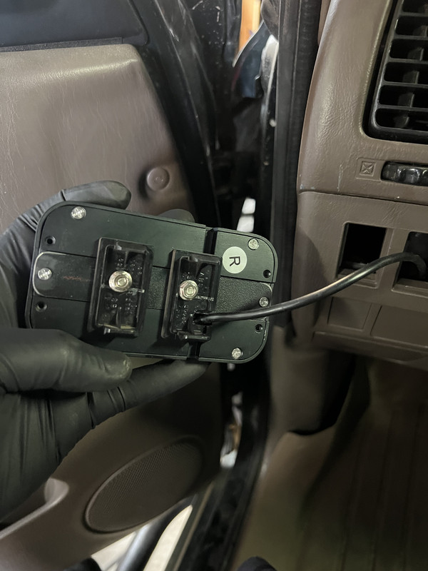

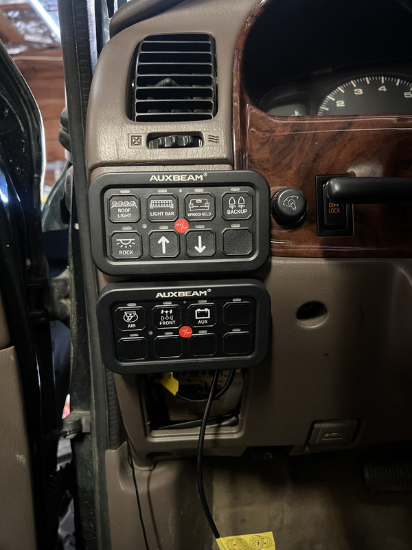

Didn’t end up 3d printing a bracket for this, used the oem switch blanks and one of the brackets that came with the auxbeam panel. Had to countersink the mounting hardware which turned out really nice.

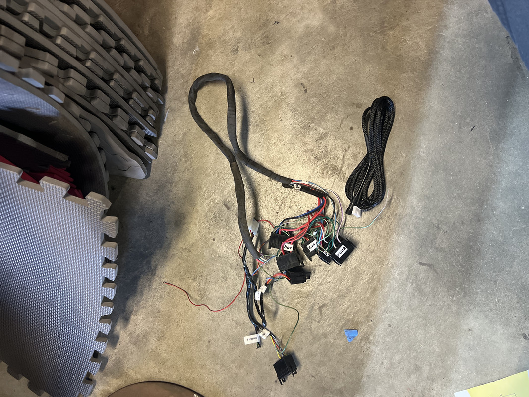

Here’s the old rats nest of wiring compared to the small wire that’s replacing it (actually I think this is only half of the rats nest lol). The switch panel system really is so much cleaner and easier, wish I would’ve done this from the beginning.

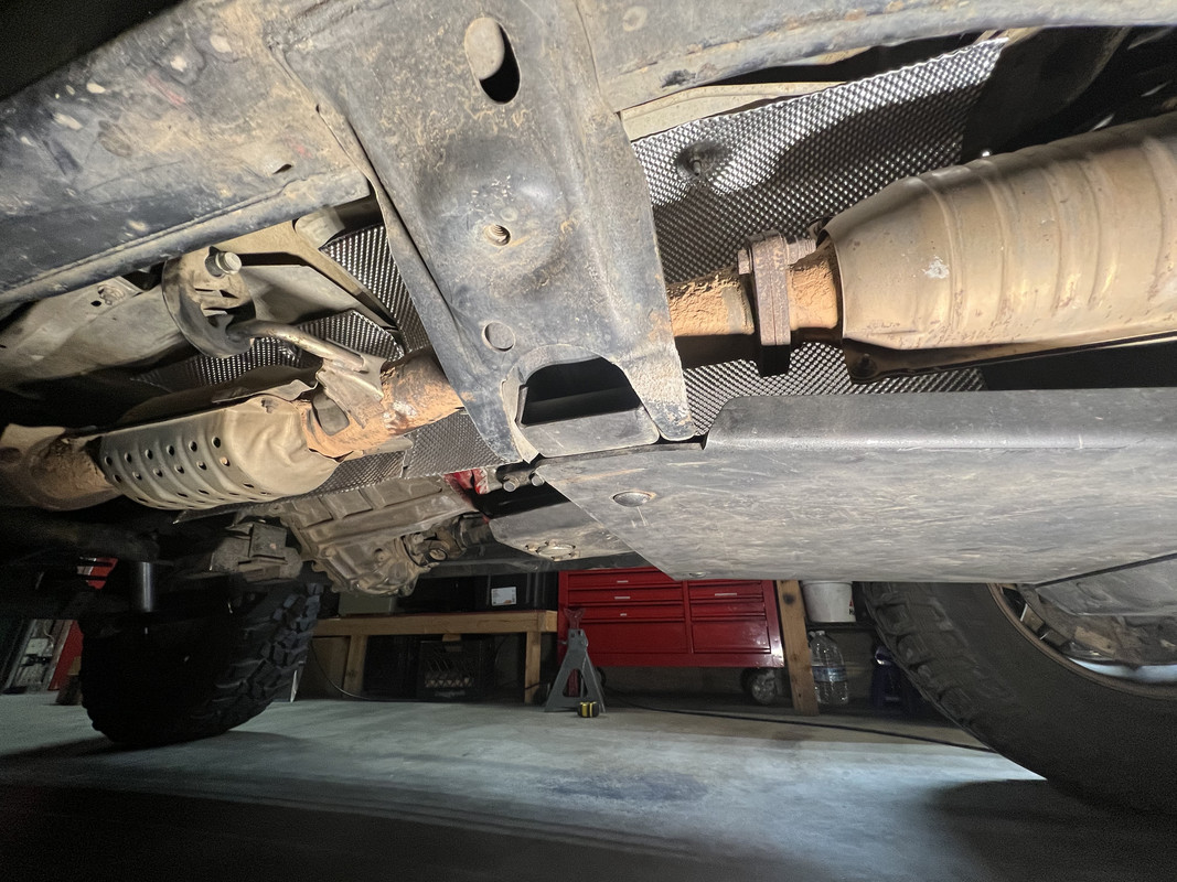

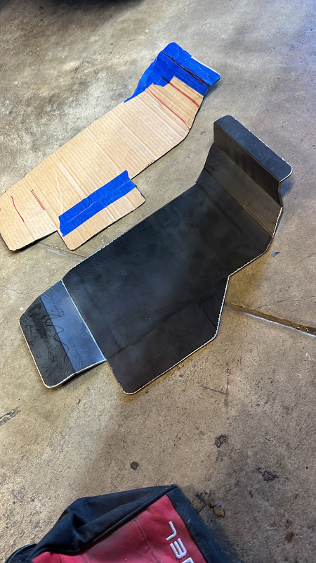

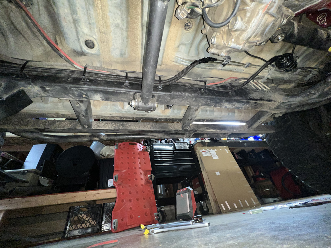

While installing my custom skid plate I decided to add some heat shielding to protect the transmission/transfercase. I definitely notice a significant increase in trans temps when I have my skid plates on, hopefully this helps a bit.
Back to the fuel tank adventure, hopefully my 3rd time doing the fuel lines is the last time. Decided to cut the eimkeith bumper to make tank removal/reinstall significantly easier. This bumper was way over engineered so I’m not too worried about removing this small piece.

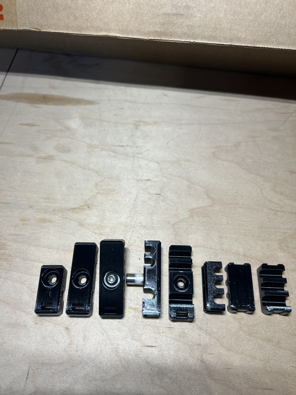

Designed and printed out some brackets to hold all the fuel lines to the frame.
And here it is all plumbed, might have had a leak or two but just had to snug the fittings down a bit more and boom she’s running good again.

That's a fantastic idea using the switch blanks to mount the switch panel! Hopefully I remember that if I ever install one. Looks great!

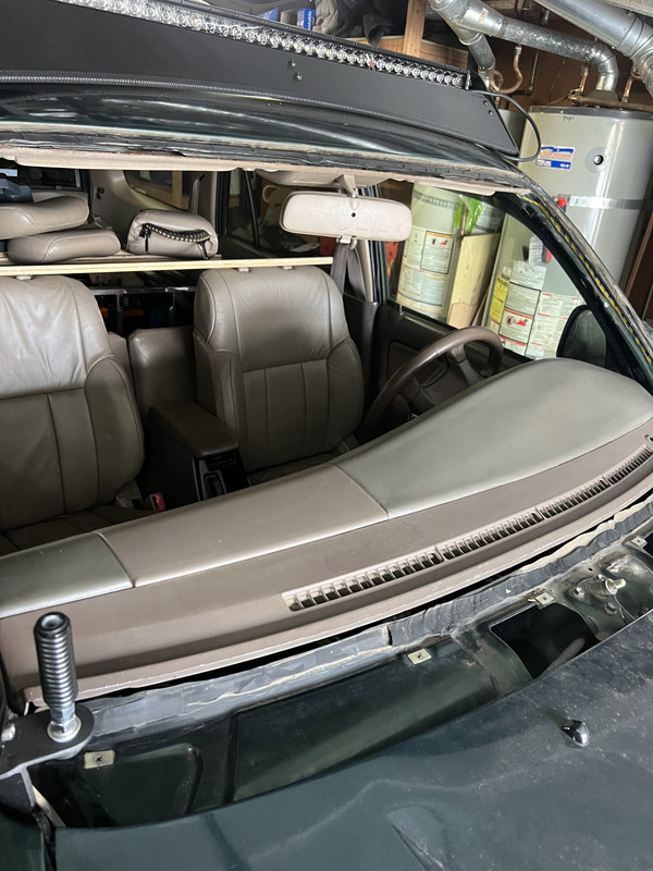

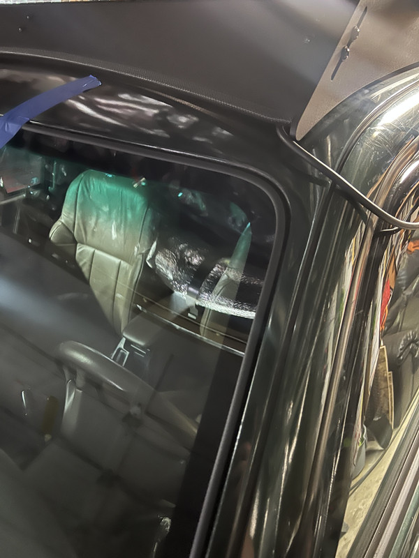

Removed/reinstalled front windshield (Timmy the toolman video coming out in the near future). The exterior seal was peeling up in the corners and I could tell the last person didn’t do a great job. Ended up being a little rust in a couple spots so I’m really glad I fixed it when I did. Used the oem seal and am super happy with how it came out.

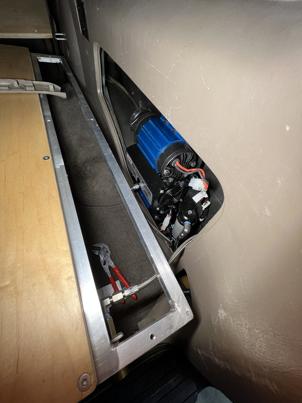

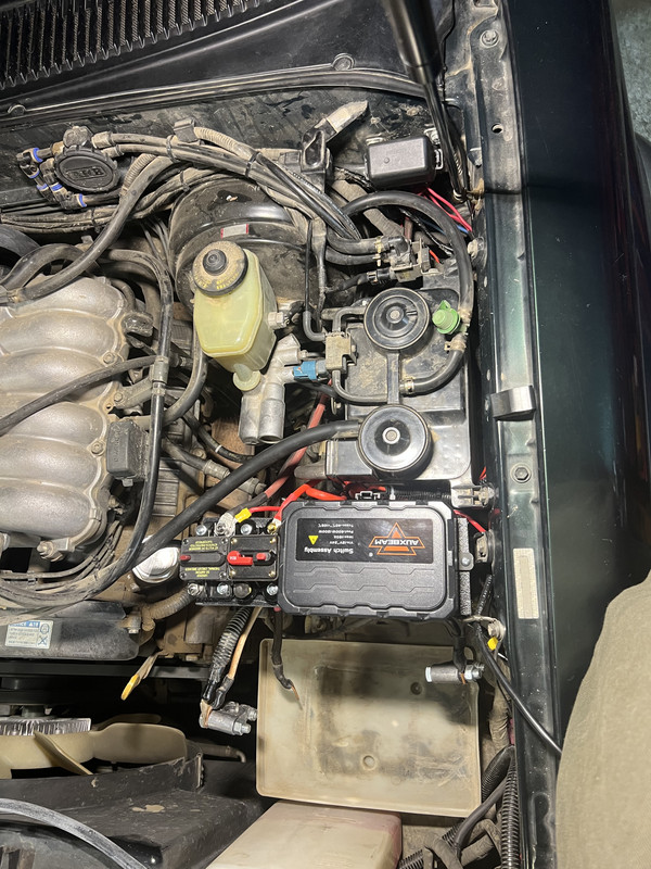

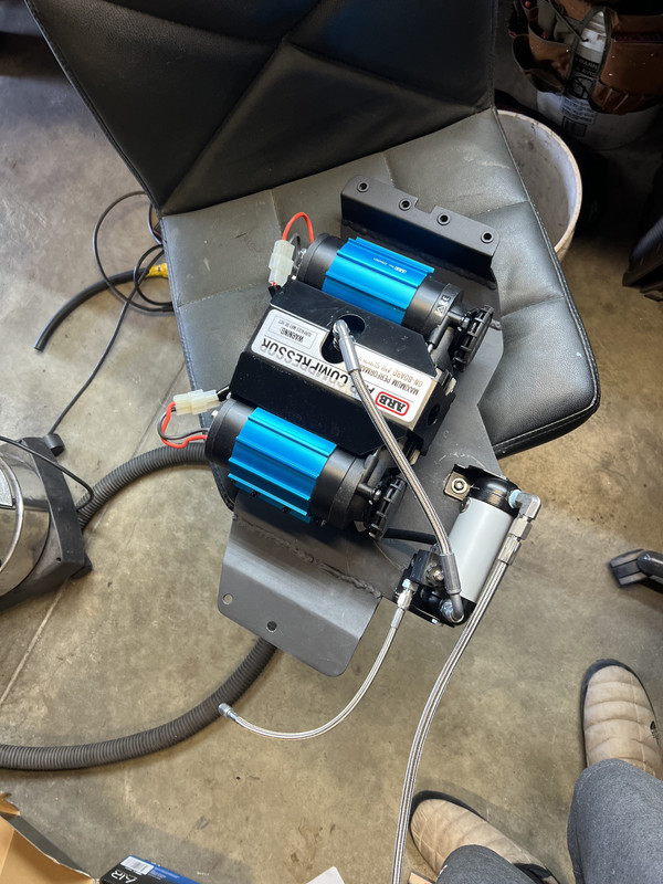

Got a dual arb compressor, didn’t want to get rid of the abs module so I couldn’t fit it in the engine bay. Ended up putting it in the rear cubby, made a solid bracket out of 1/8” steel. Installed a stainless braided line for the front locker (need like 12-14’ length). Had to wire it and my secondary switch panel to the auxiliary battery.

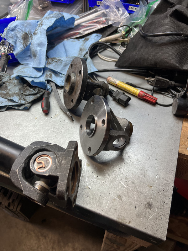

Replaced the ujoints and cardon joint in my driveshaft, I think from driving with it out of balance for a while it was starting to mess up the u joints and I found a bit of play in one of them. The cardon joint is a direct fit to the Toyota transfercase flange so I can eliminate the custom bushing I made a while back.

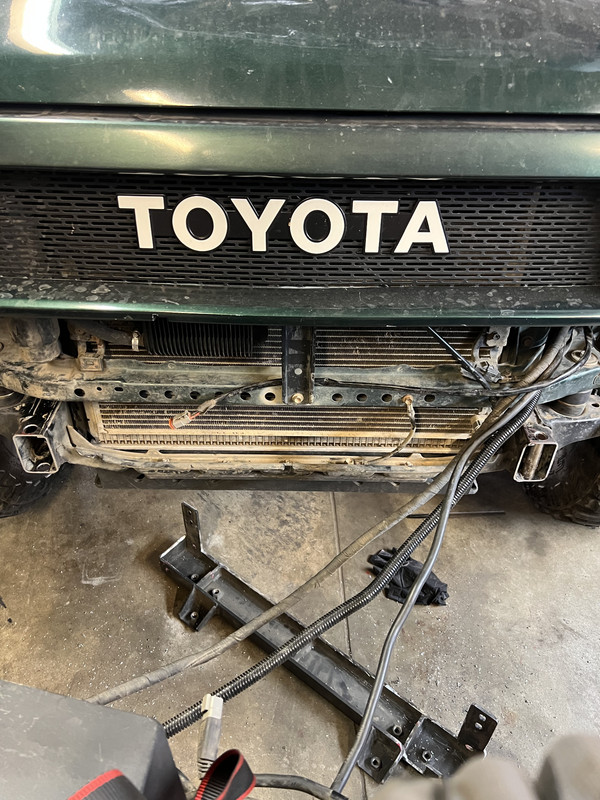

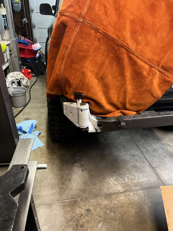

Got an eimkeith swingout hinge and a truenorthfab swingout kit. Ended up working out good but had to reinforce the connection really well. Going to make a fold down table eventually as well. The hatch clears the tire by millimeters lol.
Here you can kind of see how I had to offset the tube on the swing out from the pivot point on the eimkeith hinge. I was skeptical at first but it turned out more beefy than the majority of swingouts Ive seen.
Final product

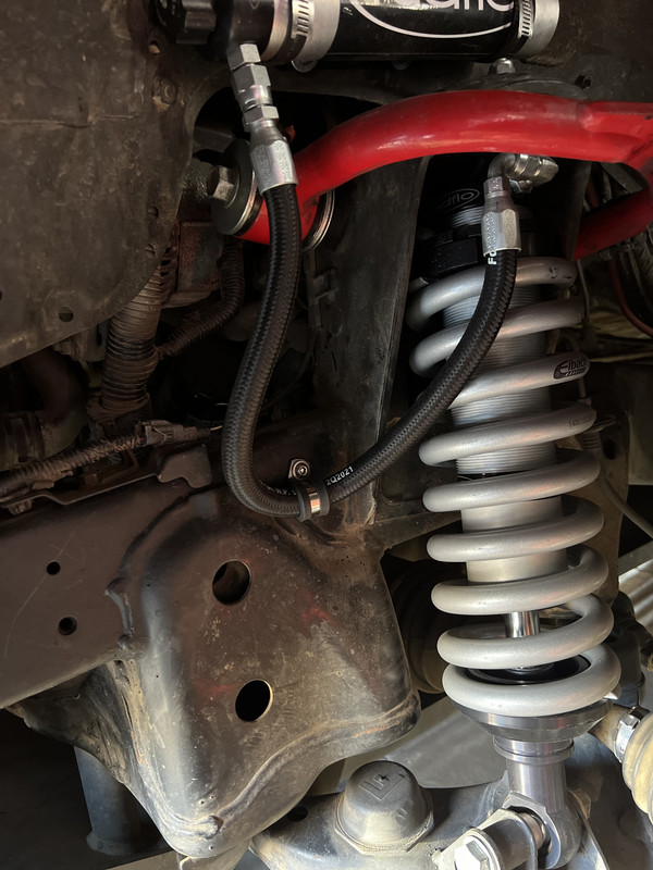

Strapped the hoses on my front resi’s a bit better

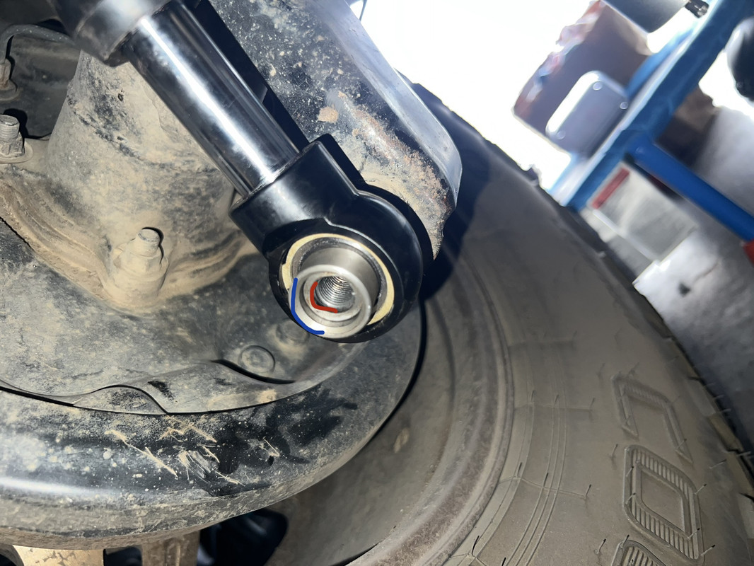

Installed 861’s in the rear and had to reroute the resi’s on my rear shocks as well.

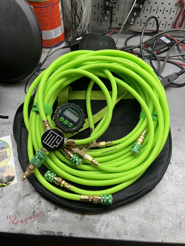

Got a morflate kit, pretty nice quality.

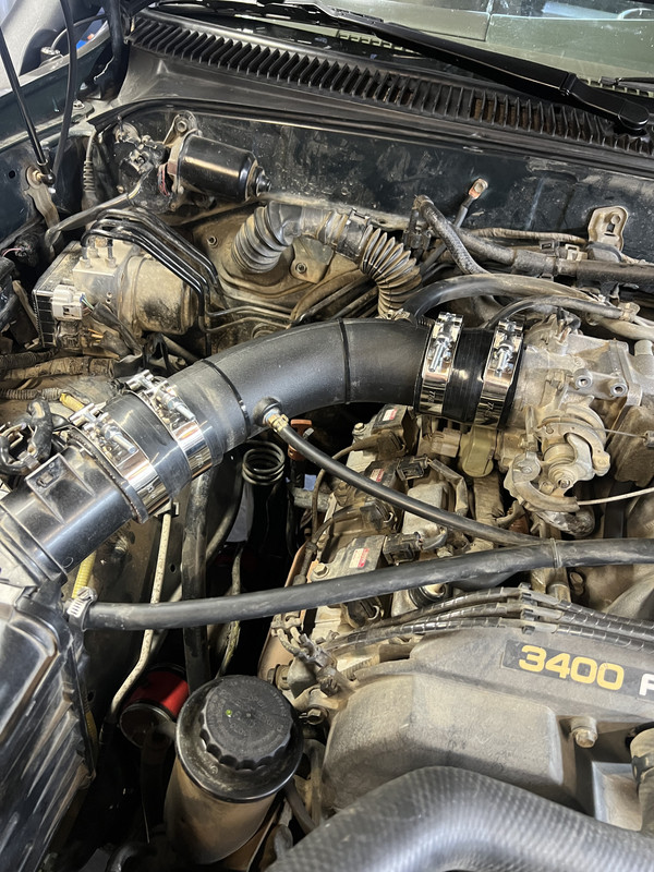

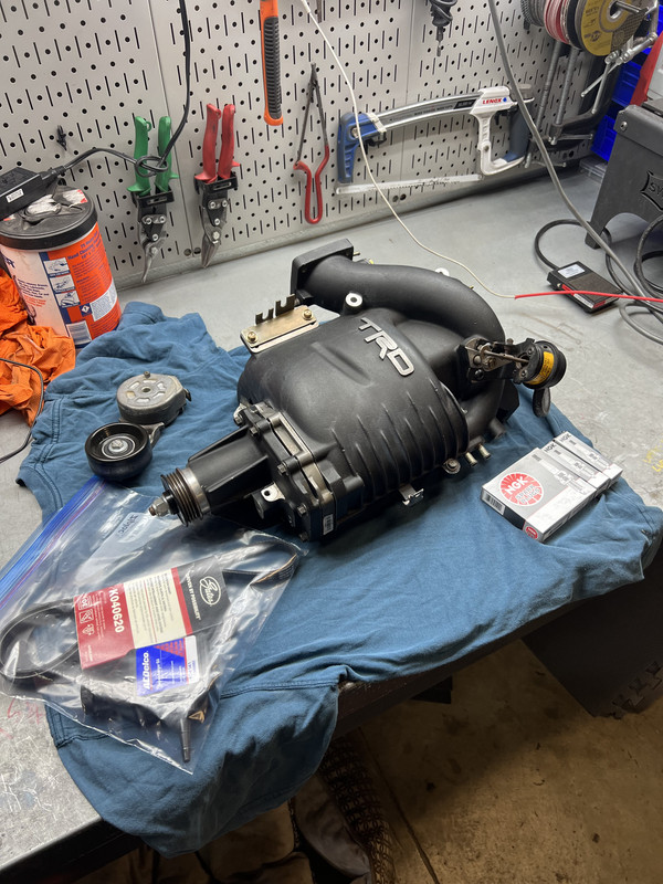

And last but certainly not least I got a supercharger!!! Woot not much left I can do to this thing without going SAS. I feel like if I go 1 tons this truck is going to weigh too much for the engine to handle, sucks we can’t really legally do engine swaps in CA anymore.

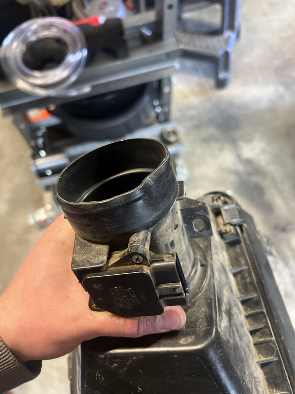

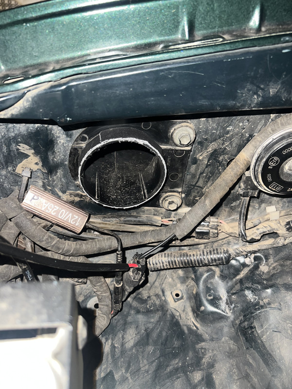

Ended up crushing the connection on my oem intake box. Hit it with a torch and a piece of metal that fit inside pretty well and got it straightened out a bit. Now instead of worm drive hose clamps I’m using these nice turbo style clamps, they seem much better. Also I used to have the connection from the airbox to the fender well sealed with rtv but found that wrapping it with tape to achieve a tight works really well.

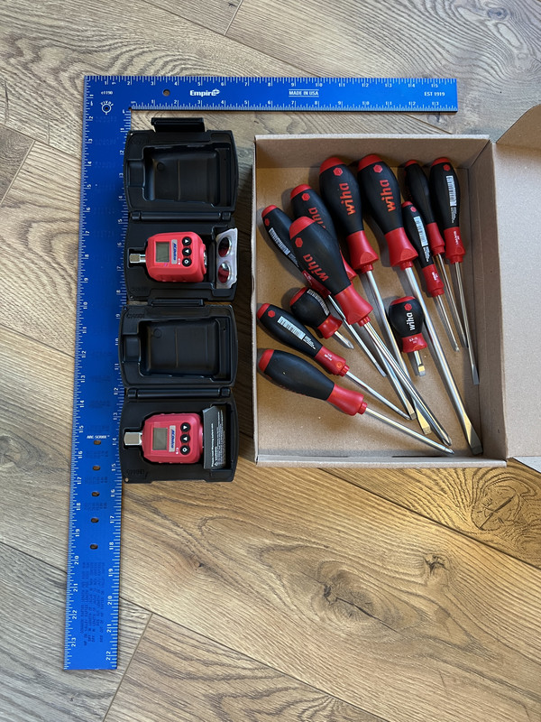

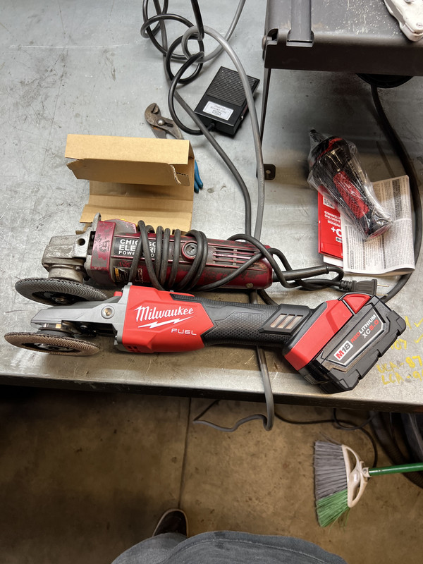

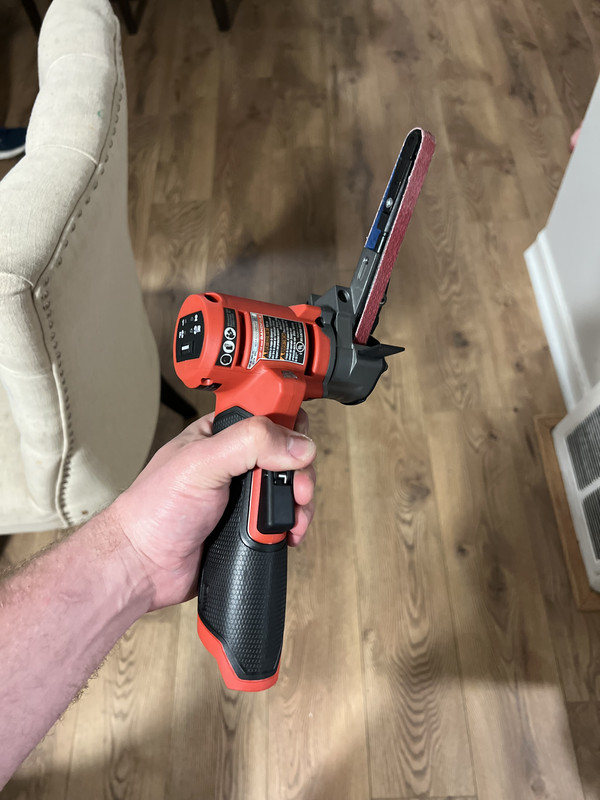

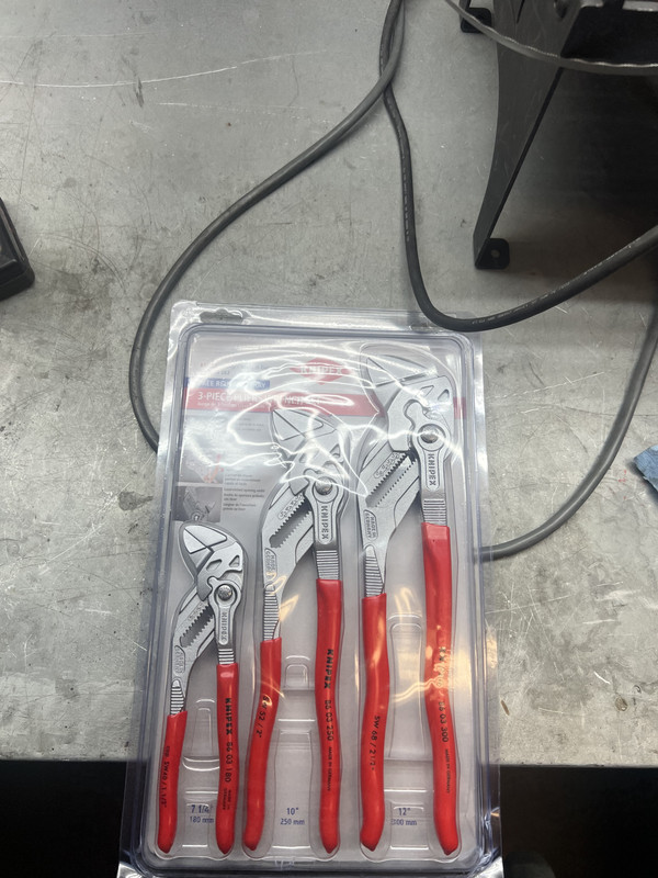

Can never get enough tools, got some KNIPEX pliers, m12 belt sander, and an m18 mid torque impact 1/2”. No picture of impact lol.

Removed front diff drop because it was making my CV boots rub against the LCA eimkeith reinforcements.
