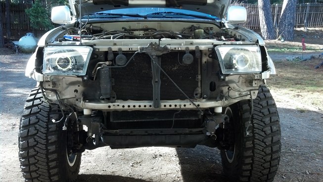

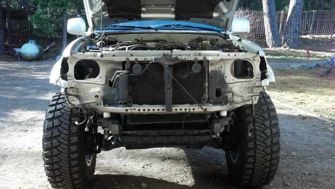

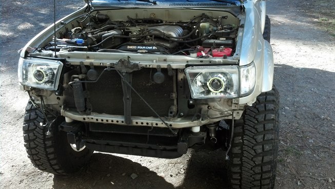

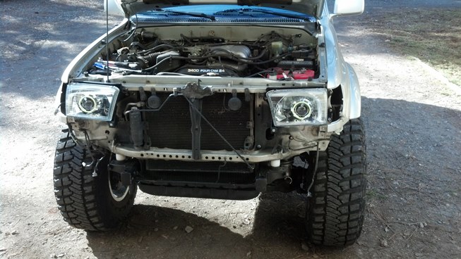

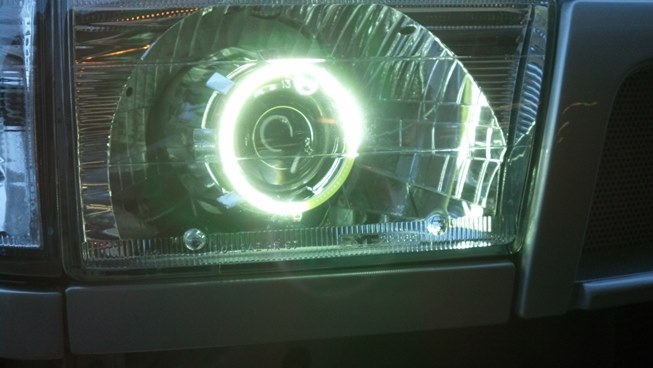

Well had a few hours to work on my runner so I went after the projector head lights. What a pain in the ass. Actually it wasn't bad just disappointing. The drivers side had a lot slop between the housing and the the bracket, that was fun to fix. After getting out all wired I turned on the halos the passenger side had an issue. Only 3/4 of it worked...so bummed I can't even tell ya. Pics and stuff to follow.
So here's what she looks like with the new lights. And the almost working halos.....:ybrick:

Wow this truck is gorgeous Bryan!
Bummer about the halos. I wish the entire halo wasnt working, then it would probably be an easy fix like a bad driver. Shoot me an email, TRS will warranty the rings and I could probably walk you through the process to replace or we can work something else out to get you up and running.
Thanks, it's coming along slowly. But so far I'm happy with it. Minus the current issue...

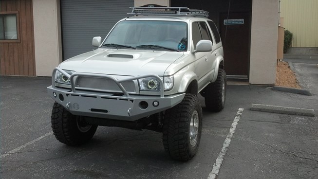

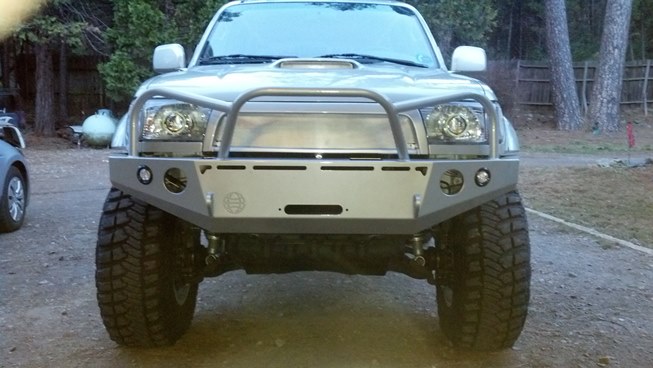

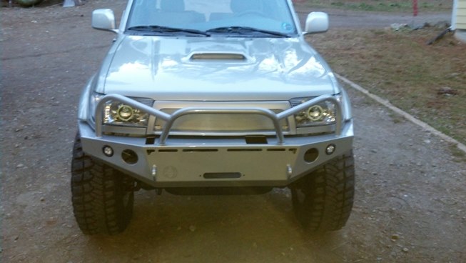

Woah, the projectors, and that grille, and bumper make it look raunchy AF! I LIKE IT!
Are those FX's? Do you have any output shots of them? I'm curious to see if the bumper interferes with any of the light output/cutoff.
Bi-xenon FX-R Stage III Kit (FXR-III)
Ballasts Morimoto 3Five (35w)
Bulbs Morimoto 3Five 4300K D2S
Halos, Morimoto XB LED (White)
Projectors LHD (2.5" lens)
Shrouds Gatling Gun
Wire Harness Relay: H4/9003
This is what I got...I don't have any shots of them yet, I haven't had time to aim them yet. I'm hoping to do it tonight.

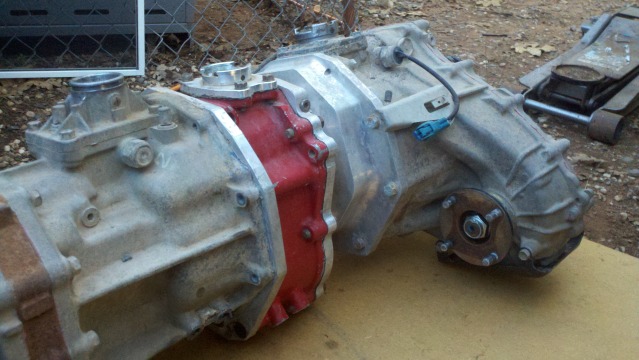

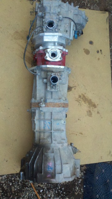

So I picked these up last night.:first:
Great stuff man! What's the final drive with those cases? We're gonna have to hang out when I get back. Help me out with the retrofit projectors and check out the crawl speed with those cases!
This is the best I can come up with. 35's 4:88's, 5speed, duals with 4:7's
Final Drive Ratio 185.05
I've gotta ask, cause I've yet to see one on here, how do all the linkages/shifters fit in the cab(center console). I'm hoping by next year I will be able to afford to be dual locked with at minimum one reducer. And yes, one of my favorite expressions, as you can tell. P.s. Props on the millennium silver, it's like looking into a crystal ball at the future for my rig. :madgrin:
