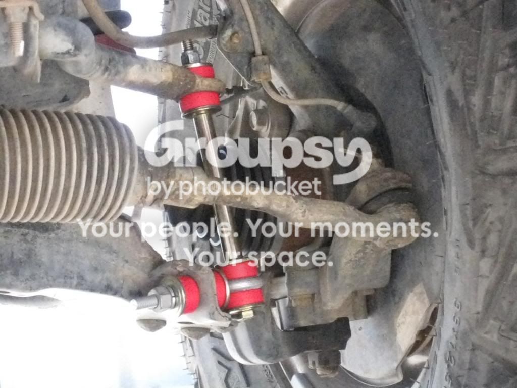

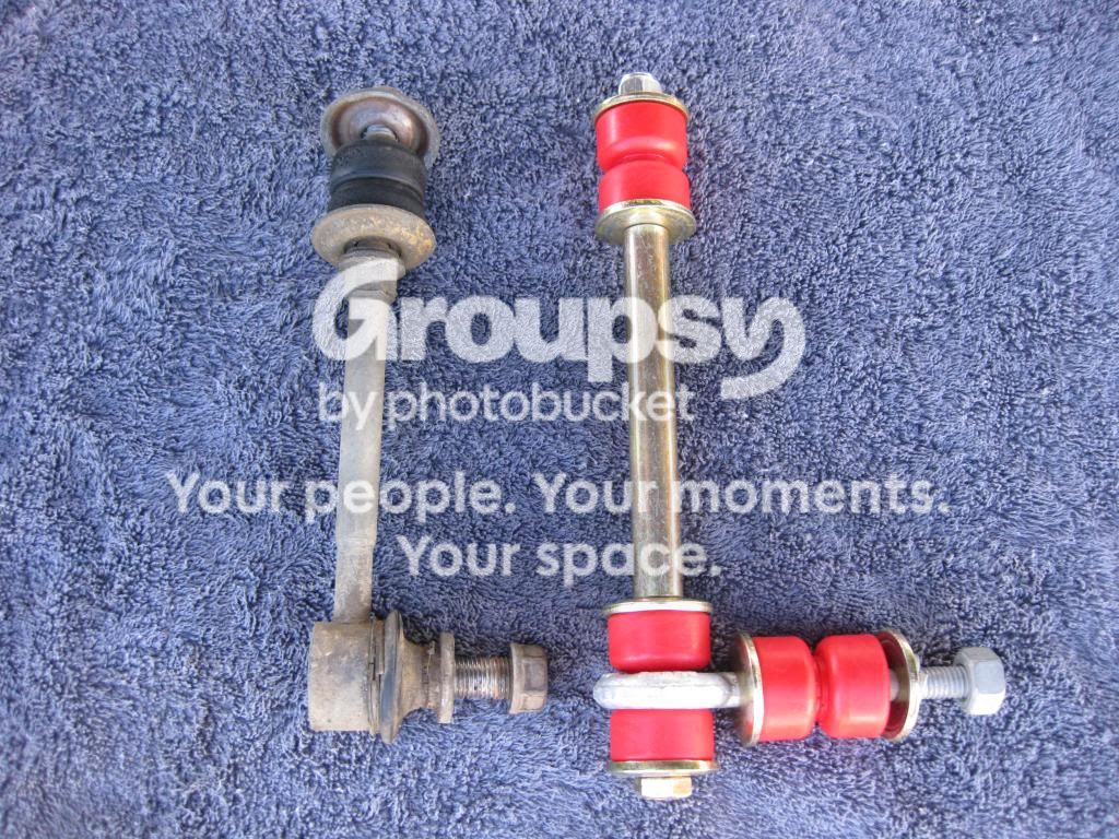

First, I finally installed the new front swaybar end links. I did the rear end links a while ago when I installed my 8.5 wrap coils and shocks, but I never got around to the fronts.
Old vs. new
IMG_0681_zpsec5129a5.jpg~original
Installed
IMG_0687_zps30666bcb.jpg~original

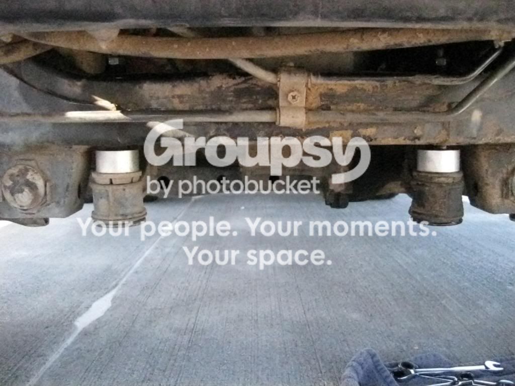

Then, I Installed my Toytec 1" differential drop
IMG_0688_zps63aa9b3f.jpg~original

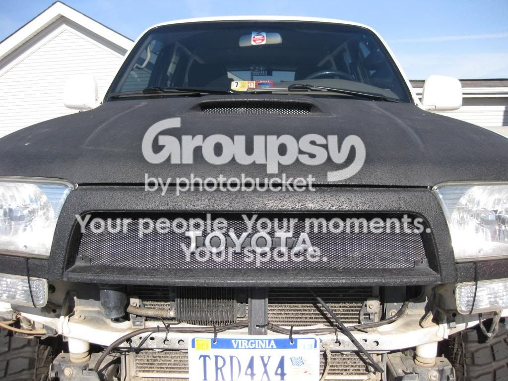

Next, I swapped the TRD emblem on my Satoshi for something a little cooler. I also removed the TRD emblem from my sport hood gille.
IMG_0692_zps83b424e8.jpg~original
IMG_0691_zps2b4f9afd.jpg~original

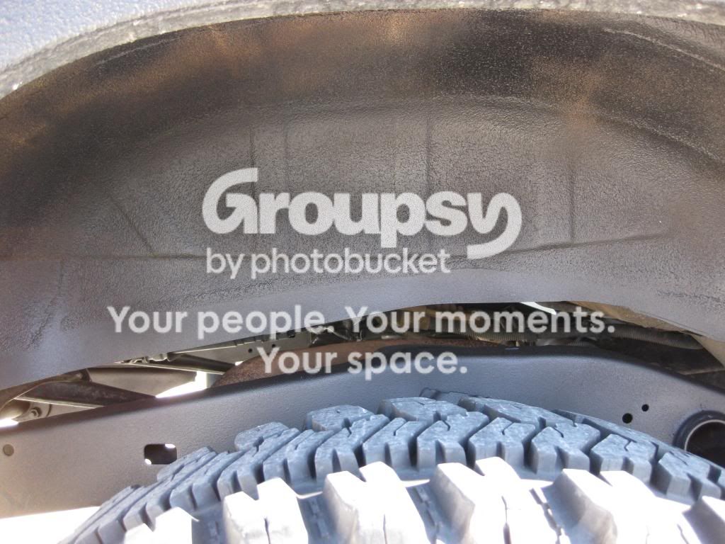

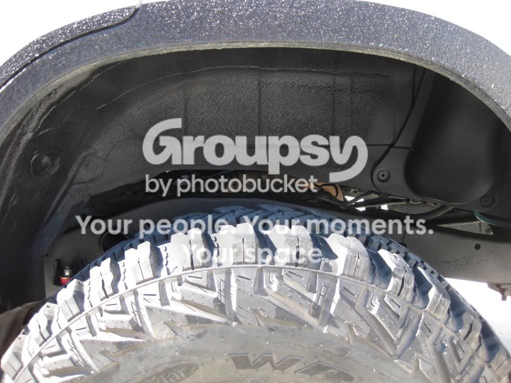

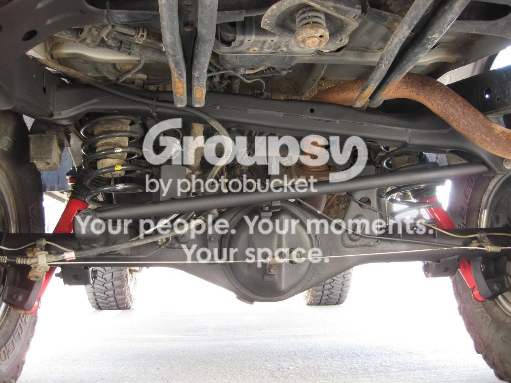

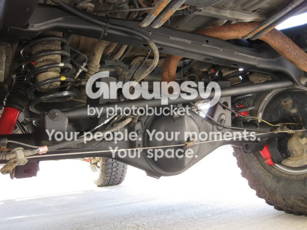

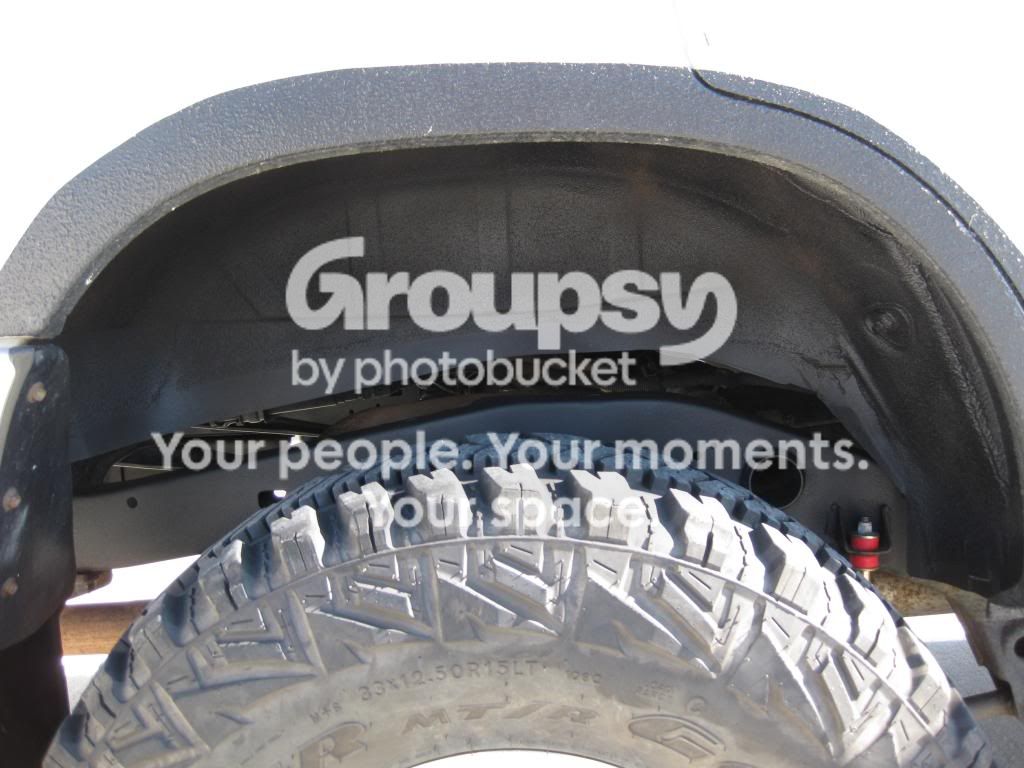

And finally, while I was working under my truck installing the differential drop and swaybar end links, I noticed how dirty, rusty and gross everything looked underneath. So I decided to do something about it...I went to my local auto parts store and pickup up a wire brush, a can of acetone, a couple rolls of shop towels, and 2 cans of 3M Professional Grade Rubberized Undercoating. After a couple hours of work here is what I have now..
Driver side wheel well
IMG_0695_zps8e2a57b6.jpg~original
Underside
IMG_0696_zps67440619.jpg~original
IMG_0697_zpsa7777ace.jpg~original
Passenger side wheel well
IMG_0693_zpsde3b33c3.jpg~original
As you can probably tell, I ran out of undercoat before I could finish...
IMG_0694_zps79ff00f5.jpg~original
My process was as follows:
1) Used the wire brush to clean as much rust and heavy dirt off as I could
2) Used the acetone to clean everything and prep the surface for the undercoating
3) Used the shop towels and some masking tape to cover parts and components I didn't want to spray (coils, shocks, parking brake cable, brake lines, etc.)
4) Sprayed everything with the undercoating
The prep work is really tedious and the undercoating is kind of expensive ($10 per can) so this is a project that I will probably be working on for a while until I am satisfied. I figure 1-2 cans at a time is a decent pace.

That's as good as it gets there, I take it you just hand painted the undercarriage with lots of patience?lol
Thanks! I like to think I am a pretty patient person, but hand painting everything would definitely be pushing it haha. I took the "easy" way out and used spray cans: Buy 3M Professional Grade Rubberized Undercoating (16 oz.) 03584 at Advance Auto Parts.

Did you build those front sway bar end links yourself? Or where did you purchase them? I've been contemplating getting a set for the front and throwing my front sway bar on, then just un-ding the bolts when I go offroad and zip-tying it out of the way...

Sorry if I missed it, but can I get some more deets on those front endlinks?

Sorry about that, I guess I got distracted and didn't completely answer your question. I didn't want to spend over $100 on new end links so I built them myself using the guidance I found in this thread: http://www.toyota-4runner.org/3rd-gen-t4rs/97769-built-new-swaybar-endlinks-my-runner.html.
[MENTION=80692]02running[/MENTION] [MENTION=46329]blcktpgsr[/MENTION]: I used a combination of shop towels, panters tape, and scrap cardboard. I used the cardboard to block off the larger parts and I used the shop towels and painters tape to cover some of the smaller parts as best as I could. With something like this there is bound to be overspray, but the best part about the rubberized undercoating it that it is really easy to wipe off when it's wet (the first few minutes after you spray it). So, I just worked in small areas at a time and made sure to clean off any overspray on the parts I wanted to keep clean.
