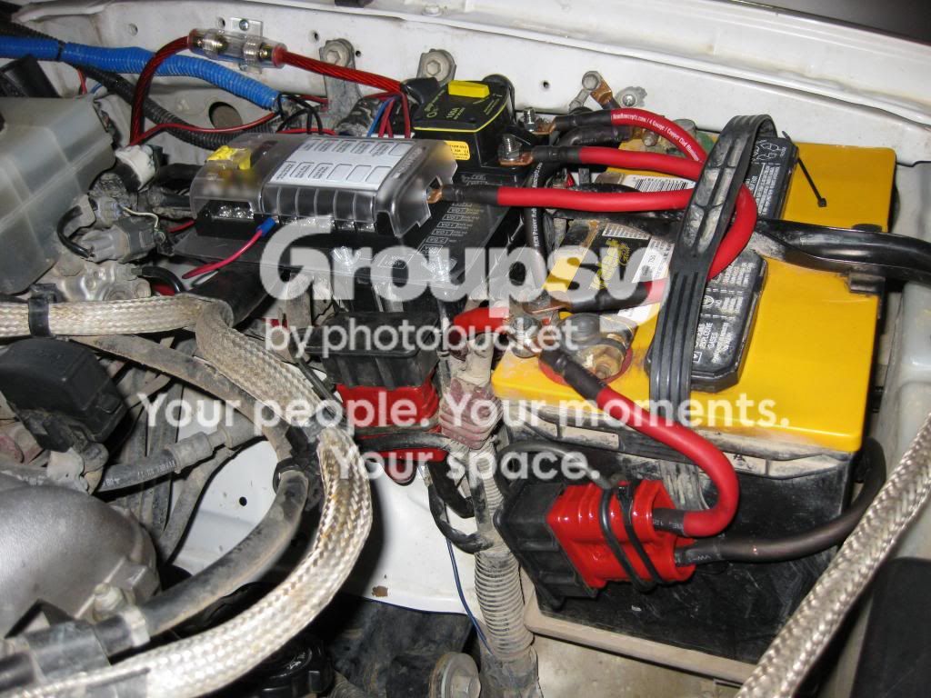

Nice job on the wiring. Looks like things are coming along.
I've had a Blue Seafuse block for quit some time, just haven't installed it. I've been debating if I want to mount it inside the truck of not. I'm wanting to keep all the wires as hidden as possible. Just don't know where I would put it.

Thanks dude, I'm really happy with how everything came out.
I was also thinking about putting it inside the cab, but it just seemed like it would be much more of a hassle to run all the wires through the firewall and find a good mounting location that has enough room on all sides to connect the wires.

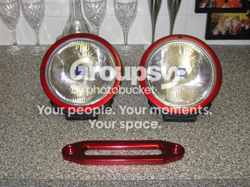

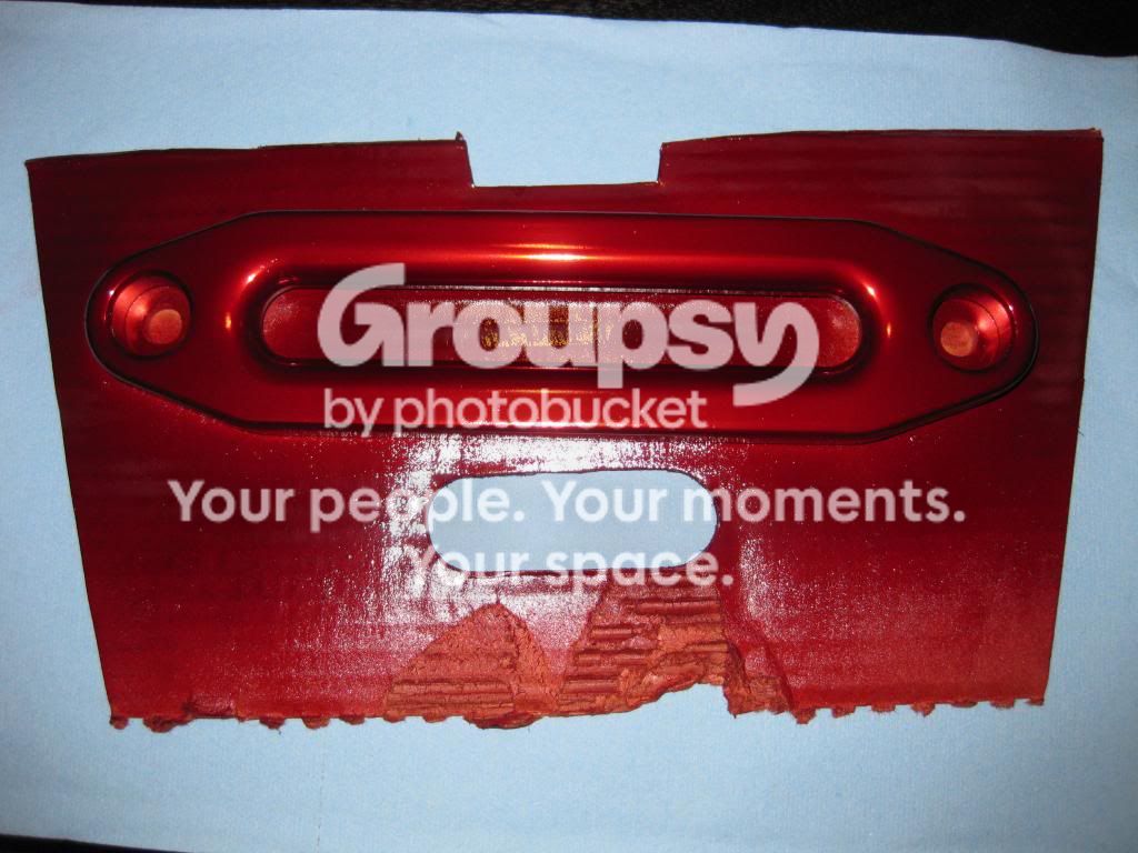

I took a page out of 4-Ripcord's build thread ([MENTION=57546]4-Ripcord[/MENTION]) and painted my winch fairlead with Duplicolor Metalcast. I went with red to keep with the white, black, and red scheme I have going.

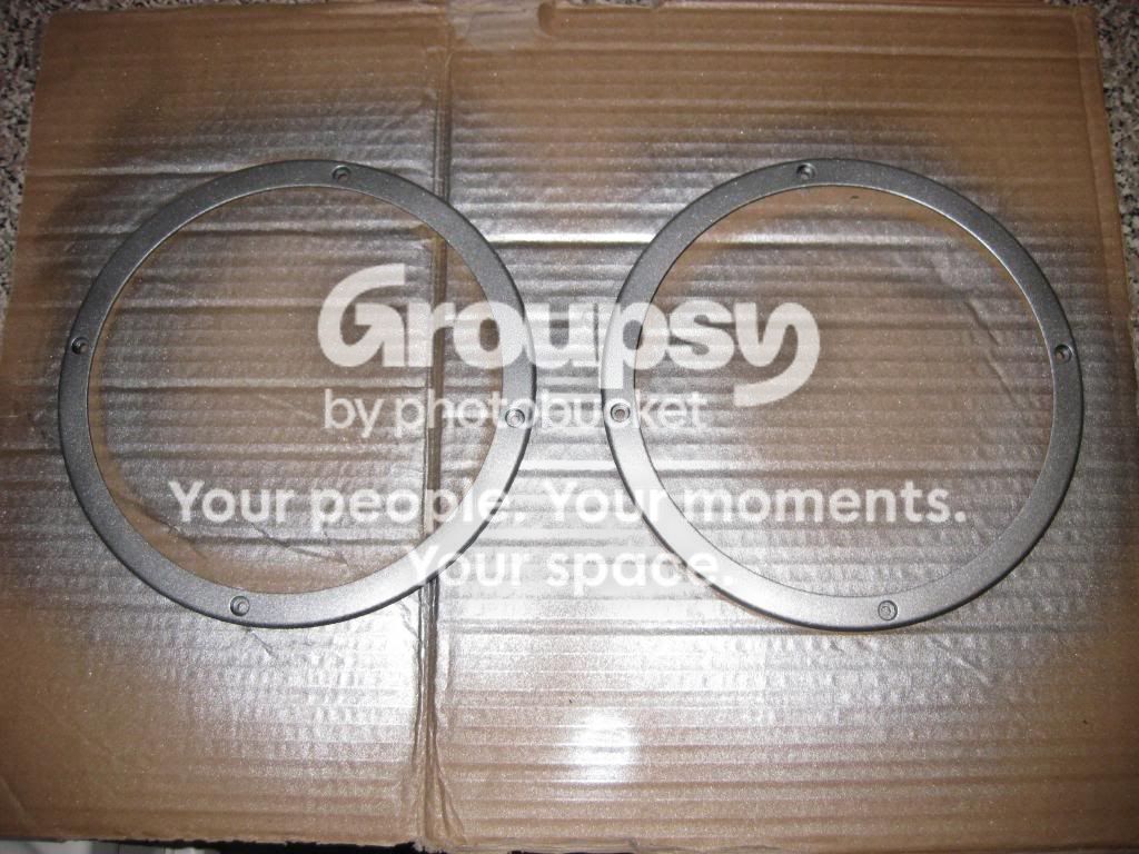

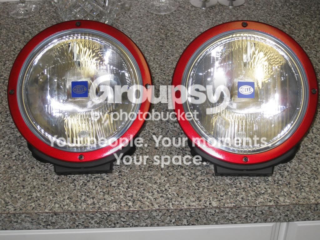

I also painted the rings around the Hella's to match the fairlead. Since the rings weren't chrome or other reflective surface, I had to use Duplicolor's Metalcast Ground Coat first.

Even though I used the same paint, the fairlead and light rings are slightly different shades, I don't think there is anything I can do about it though. (For some reason my camera makes the shades look a lot different that it actually is)

Looks badass! You didn't spray them in your kitchen did you!?! lol
Nice chicks in the background of the last pic btw :D
Thanks dude! Haha I thought about spraying them in the kitchen because it has been so cold out recently...I sprayed them outside (about 30 degrees) but brought them inside after each coat and used a small space heater in the kitchen to help dry the paint and keep them warm. Maybe not the best idea but it seems to have worked out alright. :thumb:

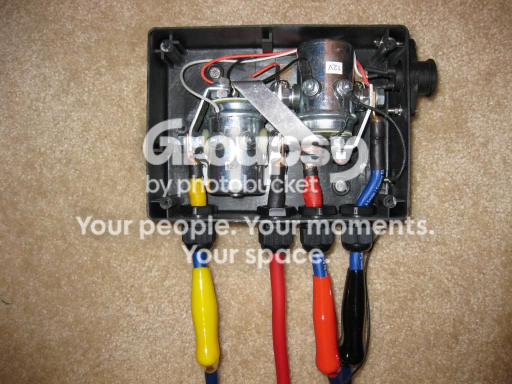

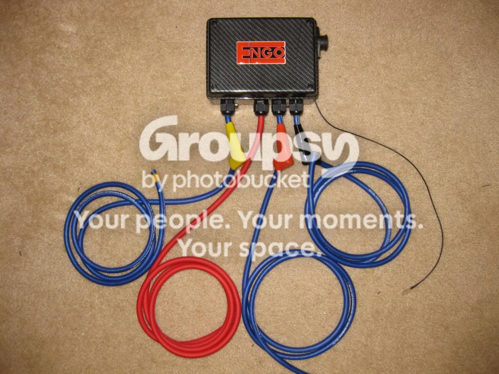

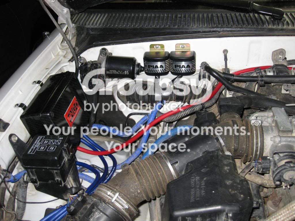

Small update: I got my winch control box re-wired with 6' - 4 gauge wires. Now they should have no problem reaching the winch motor and battery termial.
IMG_0638_zpsef63167d.jpg~original
The 3 blue wires connect to the winch motor and the red wire connects to the positive terminal of the battery.

Sweet! Nice and professional looking. Not sute if 4 awg is big enough though. A winch can pull a lot of amps.

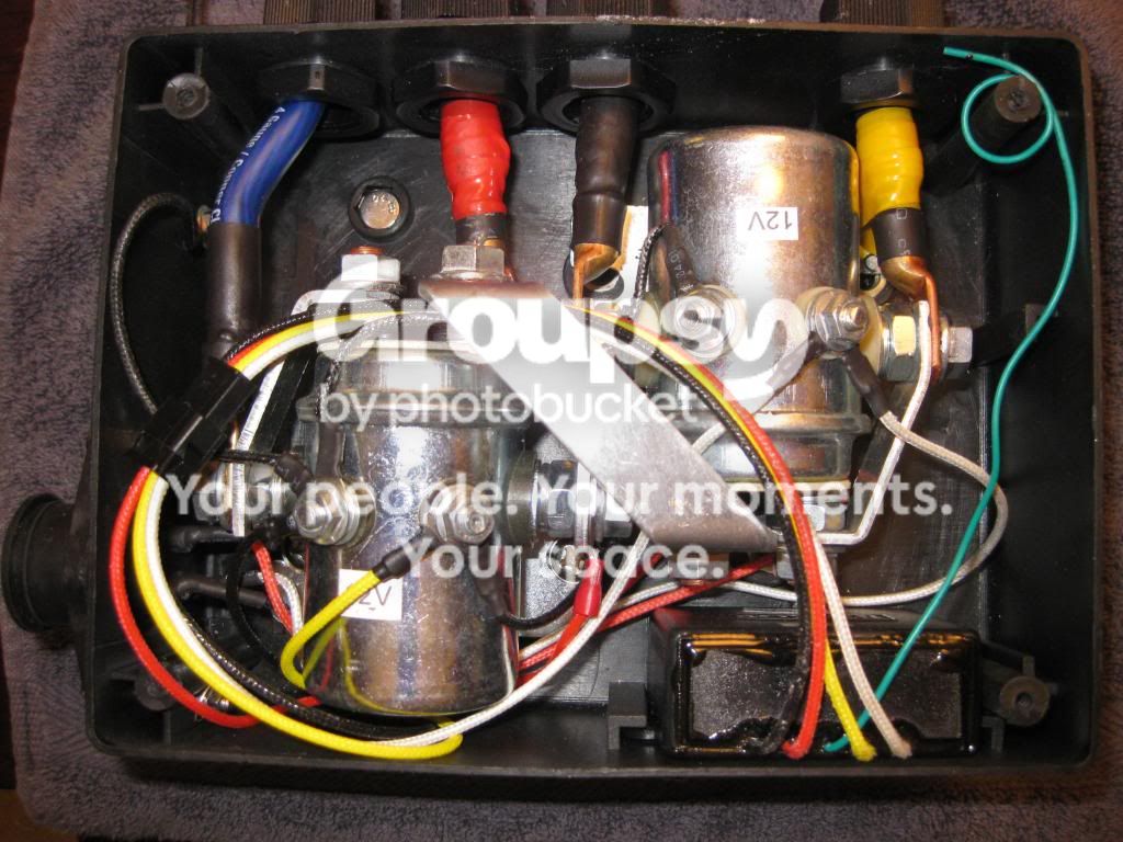

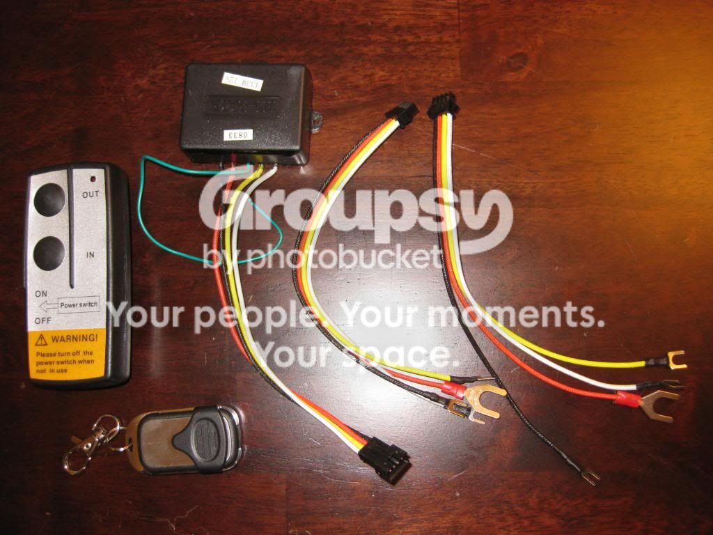

Another small update: In order to solve the lack of access to the winch remote plug problem, I ordered and installed a Tuff Stuff universal wireless winch controller (WINCH WIRELESS REMOTE KIT : Amazon.com : Automotive). The wireless control box fits perfectly in the winch control box and wiring it up was super easy.
Everything included in the package:

Installed:

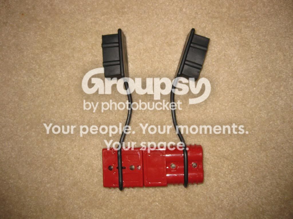

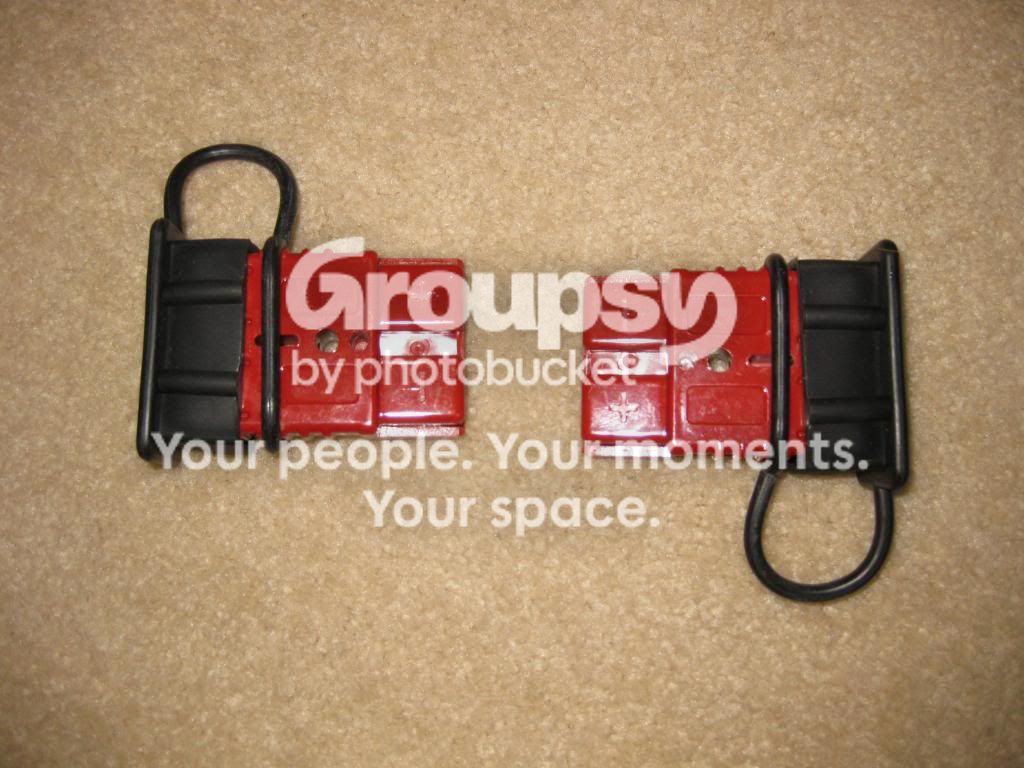

I also ordered a winch quick connector (WINCH QUICK CONNECTOR : Amazon.com : Automotive). so I can disconnect the winch from the battery when its not in use

This weekend I had some time to continue prepping for my SW. Speaking of which, I talked to Mark at SW and my bumper is currently in the production process and should be here in less than 2 weeks! :bluejump:
I mounted the winch control box, ran the wires, and installed the winch quick disconnect plug.

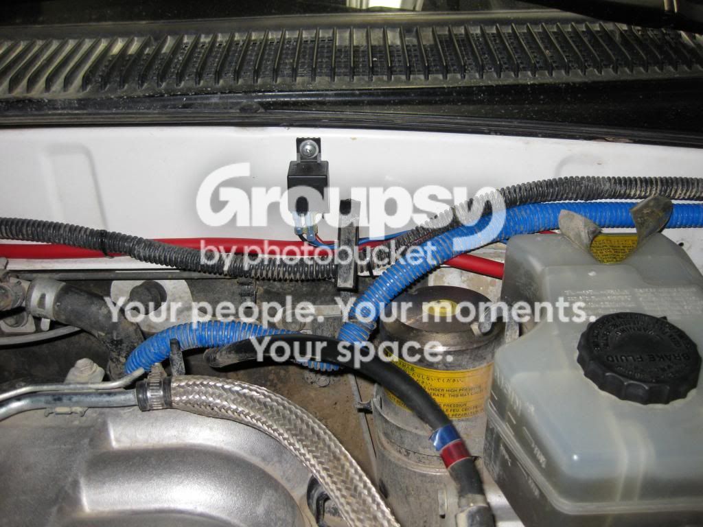

I mounted the relay for my Hella Rallye 4000s.

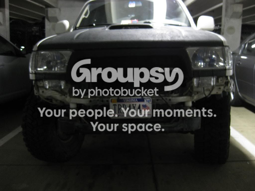

and I removed the factory bumper. I zip tied on my license plate and turn signal lights just so I am legal until I get the SW installed. (Sorry for the crappy pic, I got a late start so it was dark outside by the time I finished).
