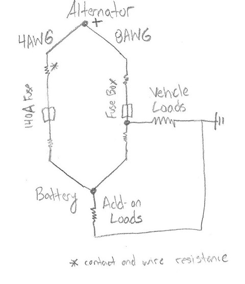

The only concern I'd have is over time, corrosion can increase the resistance in second parallel line and shunt the majority of the load to the original cable, resulting in a blown main fuse and stranded vehicle. However, any reasonable maintenance will prevent that scenario.

Hi JeremyB'
I guess you missed what I said about the way I have my accessories wired. Even if the tandem cables weren't there, I'm still not drawing any extra current through the truck's 140A main fuse. That fuse is only doing what Toyota engineers have designed for it to do; it provides power to the truck's factory accessories. The installed 'add-on's draw current directly from the battery, and are on fused, designated line circuits. The larger alternator is there because the stock 130A unit couldn't provide enough current for everything together so it was replaced.

I didn't miss it. Athough your 'add-on' items are connected to the battery, the power they draw it pulled from the alternator until the alternator is maxed out and voltage drops below 12.6-12.8 (full voltage for a charged battery) - at which point the battery begins to feed power into that line. Power flows from a higher voltage to a lower voltage. Since your fully charged battery sits around 12.6-12.8V, it isn't providing any power until the node voltage drops below that value. Without your added 4AWG cable, you could blow your main fuse.
Also, what I was referring to was is an imbalanced parallel load. If you get corrosion in your 4AWG cable, the resistance can increase to a point where the majority of the load is passed through the 8AWG cable. You can then blow your main fuse. Is it very likely? Not at all, but it is something to think about.

I didn't miss it. Athough your 'add-on' items are connected to the battery, the power they draw it pulled from the alternator until the alternator is maxed out and voltage drops below 12.6-12.8 (full voltage for a charged battery). - at which point the battery begins to feed power into that line...
What...??
I'm sorry, did I give the impression that I began working on electrical systems on Wednsday...
Quite a bit of anticipatory speculation in your post. Your theory, though full of formulas... "and a chart", just doesn't apply. If you get some time take a look at this. The author (JL Audio advisory board staff member) advises the reader/installer to upgrade those inadequate, small factory equipment wires with larger ones (at least 4ga), and suggests leaving those smaller O.E.M. cables in place, "and no mention of any catastrophic, chain destruction phenomena..." Here's the full article link:
