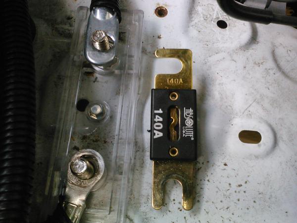

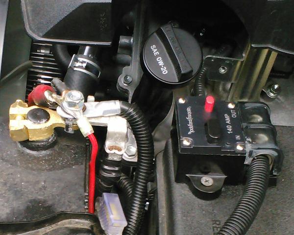

After I posted this thread I saw something that I did that I knew just wasn't right... and certainly beneath all electrical code safety provision docs (I should have caught that!). Remember this (ANL) 140A in-line wafer fuse below?
rigtec-albums-%26quot%3Bgentilmen+prefer+redheads%26quot%3B-picture26782-all-cell-pix-june-2014-006.jpg
It connects the new aux alternator output line to the Positive battery terminal's new aux cable. To reiterate on it's purpose... it's there so that in the event of a serious front end collision and the main alternator harness were to be severed, this fuse would offer an opportunity for the power to be "disconnected" to prevent a fire or an explosion. Well theoretically it will do just that... "theoretically". But, If you look at this line very carefully, w/detail to it's position, you would hone in on the problem that I saw.
Problem is the aux line from the battery is too long and the fuse is much too far away from the battery so if the supply line is severed from the fuse holder then the "safety line itself" becomes the biggest safety hazard of all. This line is so long that if severed, it will be allowed to flail wildly beneath the hood, arcing on everything in it's path, and no way to disconnect the battery; fuse and holder still sitting on the leftside wheelwell. When I noticed this, I immediately went to amazon.com and ordered a 140A circuit breaker from "Rockford Fosgate".
I removed the old wafer fuse and holder...
Then cut the loops ^^^^^ off of both 4ga power lines (see old fuse holder above) and terminated them at the new circuit breaker electrical block.
rigtec-albums-%26quot%3Bgentilmen+prefer+redheads%26quot%3B-picture26896-img418-1.jpg
Now this set-up is much better... and does recognize safety code guidelines! The RED button on top allows the user to shutdown the amplifier or other 140 amp load without unbolting the terminals; for a "quick disconnect"! But the purpose of this circuit is just to supply power to the battery as it becomes depleted from the 'added' high current aftermarket accessories.

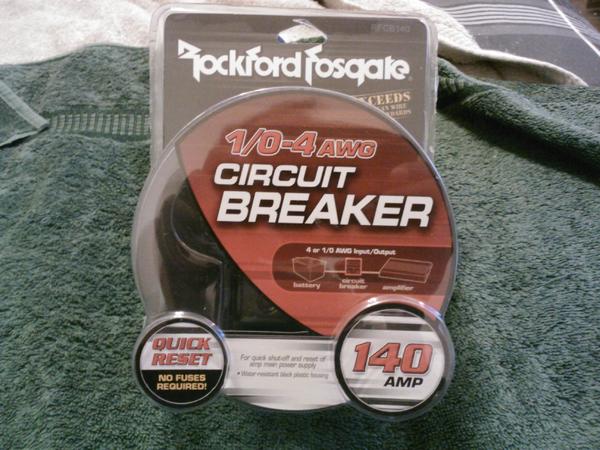

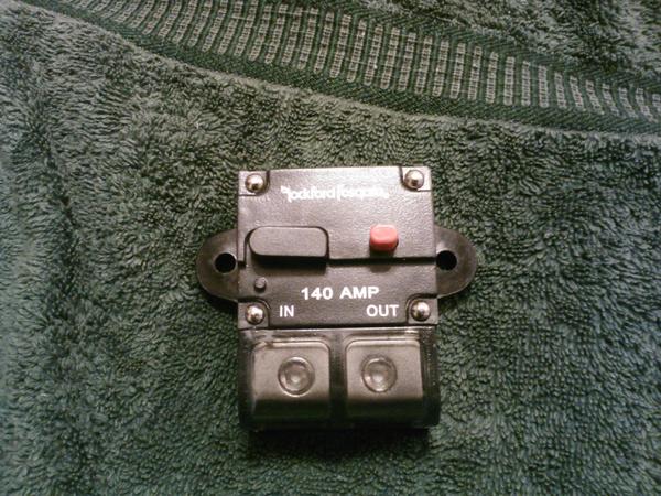

Hi VT,
I originally installed the 140A 'wafer fuse' as a safety provision. After upgrading the 4Runner's 130A alternator to a high output 270A unit, there were still a number of main current carrying cables that needed to be replaced due to the potential for an overload. Instead of ripping out each one of those main load carrying wires and replacing them, I chose to leave them in place and to give each one of them 'a partner' to split the load with. This is the equivalent of using one much larger cable.
Because the (OEM) main load carrying cable (which runs from the battery to the alternator's main output terminal) is protected by an in-line 140A fuse, it was necessary for me to include a fuse of the same electrical value in the partner line as well. If I didn't, then the added lines would in effect, be 'jumping' or by-passing the factory's safety provision fuse, thus preventing that fuse from doing what the Toyota electrical engineers intended for it to do; open up in the event of a catastrophic electrical failure.
What I did yesterday was replace the 140A wafer, with a 140A CB (circuit breaker) because where I located the wafer fuse was too far away from the battery to provide even nominal circuit protection... t'was an oversight on my part so I corrected it right away! Thanks much for your question... and the opportunity to clarify!

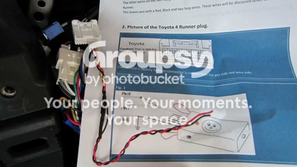

The PAC SWI-RC works like a champ. Since I don't use BT or hands-free crap, I re-programmed the "Hang Up" button as "Power Toggle", the "Call" button is "Play/Pause", and the "Speak" button (or whatever it is) is a "Mute". These are easily programmed during initial SWI-RC configuration. I'd have to assume BT pairing would work fine, and the steering wheel buttons should be easily programmed for their designed BT functions.
I'd love to swap out the W910 to one of the newer Alpine DVD/NAV units, but I'd lose the tight integration with the H800. Granted, the RUX-C800 I have mounted low in the dash (above the 4WD selector) will allow full control over the H800 DSP, but I like the Ai-Net integration I have now, and the Optical connection from W910 to H800 is nice for surround sound or just for getting a pure digital signal from CD to the H800 DSP.
Lastly - You can use an ATX Personal Computer's 3-pin fan header to interface into the factory T4R harness for the steering wheel controls (don't need to cut that harness, and other adapters are available for Power and Speaker harnesses if needed to avoid cutting ANY stock harnesses!):
PAC SWI-RC ATX Fan Wire Trick
