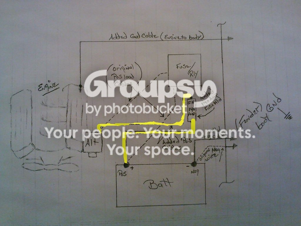

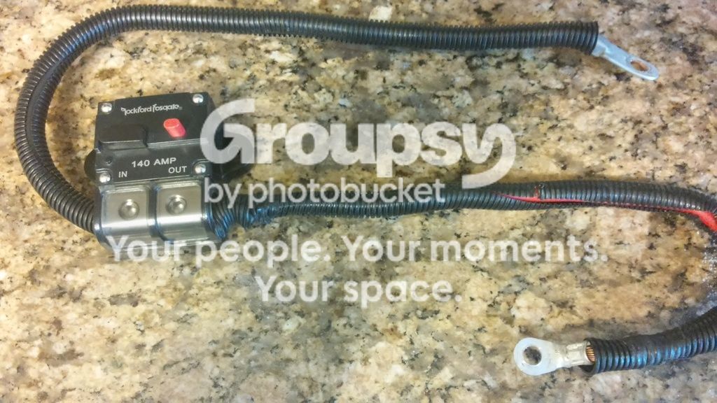

Why 140A fuse on a 270A alt?
Hi Swarty,
All things are just fine here! You've heard correctly, the stock 140A alternator can't keep up when pushed hard e.g., Winch, refrig, special lighting systems... etc (wasn't designed to); you can actually watch the voltage sag to battery voltage when using a 'cigarette lighter adaptable' volt meter with a serious load on... "found that out when I still only had one power amp on-board"! And you know when using a dual battery set-up, you've got to have something to feed them or there's no point in having them both. I would definitely recommend the DC Power Engineering XP-270 to charge that dual batt set-up, "Here's a test video to check out: https://youtu.be/1J9SkmprZm8 Best of success Swarty!
This thing got a little long and I gave up looking for this answer.
The oreig equipment had a 130A alt so 140A fuse makes sense. How does the 140a fuse not blow with the 270 A alt? Is it because you have two returns to the battery so the current is split? Should the path to the accessories bypass the fuse? In other words from my pic does the fuse go in position A or B? and why? I'm an ME so a little of this stuff is outside my normal realm but instinctively I feel like it should be in position A on the circuit. I feel like this is where you move it to when you replaced the fuse with a circuit breaker albeit for seemingly unrelated reasons.
I see your concern but think of it this way... There are Two separate circuits. There's the stock electrical system circuit having a 140A fuse that will never see a load more than that which was assigned to it by Toyota/factory. Then, there's an auxiliary accessory circuit that comes straight off of the battery using parallel HOT and GND 4ga feed lines which help to average the full load. It too has a 140A in-line safety Brkr which feeds the battery, winch, special lighting, refrigerator, 120V inverter... etc. Plus each accessory has it's own appropriately sized In-line fuse... Hence the need for the 'High output' alternator which handles both loads; stock and auxiliary. But you NEVER impose any additional accessories on the truck's stock electrical system by not tapping into the truck's fuse/Rly boxes. Make more sense? I'm sure that I'm not consuming more than 160A TOTAL at any time, but the stock 130A alternator couldn't do that by itself so I didn't wanna push it that hard.

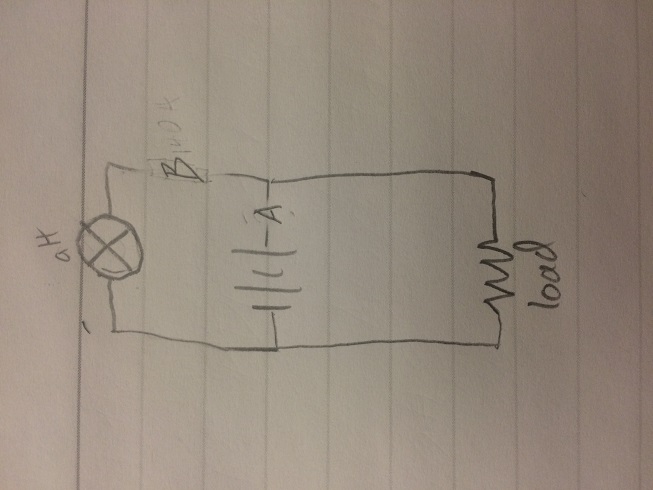

I understand as far as power to the battery.
I had to draw it out and look at all the directions current flowed depending on the situation before it sunk in but I've got it now.

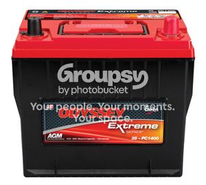

As some of you folks may have observed from this thread, I've OVER-BUILT this 4Runner's electrical system platform to a reasonable extent; giving particular attention to the area of 'Stiff voltage mains & Fast Recovery'; as opposed to the higher amperage availability of a Dual battery system. Last week I located and ordered a suitable AGM dry cell battery (850-CCA), and when it arrived (this week) I installed it. The one that I choose was the "Odyssey EXTREME" '35-PC1400'
ODYSSEY Batteries - 35-PC1400T-A

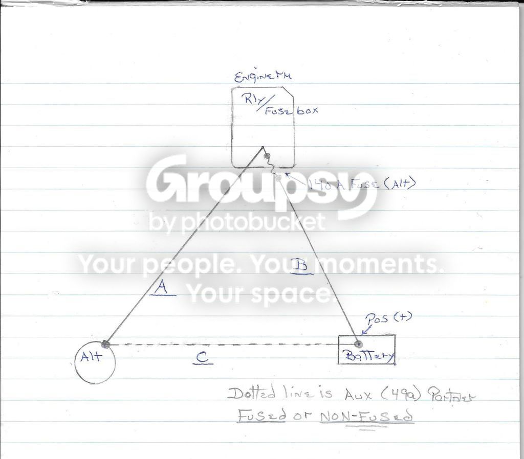

At this point however, I have no future goals or plans for any 'foreseeable' electrical system development. I did however, make a necessary 'schematic change' to the alternator output triangle. I discovered this potential electrical flaw purely by accident while re-analyzing the truck's electrical (fuse) protection strategies; take a look at the first diagram below:
The circuit in question is traced in yellow. When I first drafted this circuit I thought to protect it; not the alternator or battery, but the wiring itself. Theory is... should the main electrical output conductor (everything connected to the B Term at the alternator output lug), become severed in a catastrophic front-end collision, an In-line fuse would then offer the heavy gauge wiring an opportunity to 'Disconnect' should the positive and negative poles become united. This was Toyota's approach when they schemed the 140A Main fuse at the "Engine room" Rly/fuse panel. Well... who was I to (in effect) install a "Hard Jumper-wire" across this important safety feature. But what I realized the other day was (to me) FAR more important; see the Auxiliary triangle below:
PROBLEM: IF by chance... my 140A auxiliary fuse were to "Blow" for any reason when I'm running the 'VERY HIGH AMPERE' auxiliary loads... what will happen is: The load that was on the aux circuit at the time of the breaker trip will attempt to 'Reconnect with the alternator' (FEED BACK) through the "Main Rly/Fuse-box" under the hood, and directly through the 140A 'Alternator fuse'; taking it out without question! Today... while installing my odyssey 850-CCA agm, I removed the 'rockford*fosgate in-line 140A circuit Brkr and replaced the entire auxiliary line with a 21 inch, 4 gauge Hardwire! As long as that aux line stays where it belongs everything will be fine: ...Just to be safe!
