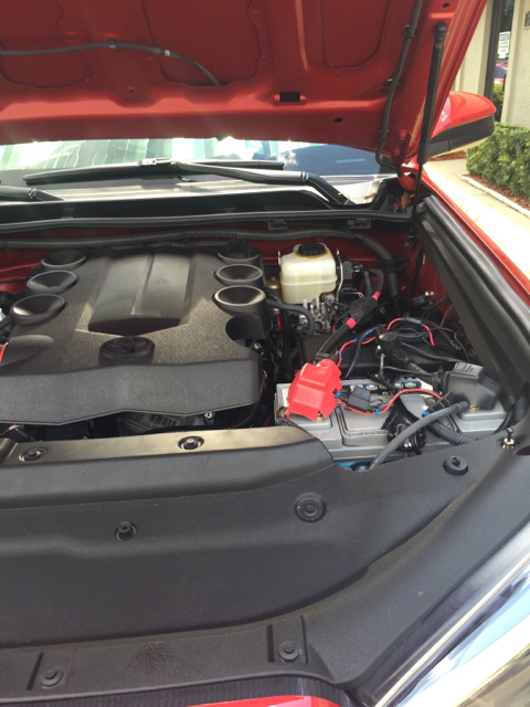

You're doing things the The RIGHT way! Myself (OTOH) discovered that I needed a generator upgrade after seeing the symptoms of an alternator that just couldn't keep up e.g. headlight pulsation, temperature control blower and wiper motors slowing down...etc. I'm very much looking fwd to seeing (reading about) your finished product!
Because you're adding approximately 100A to your existing main electrical system cables, I would strongly recommend adding an additional (POS) Alternator output (B+ term) to positive battery terminal post and (NEG) battery cables; main negative battery post to body, and an engine to body cable:

The dotted lines represent the existing factory cables, which I've left in place. The solid lines illustrate the new, heavier 4ga cables that were installed.
Don't worry about the body to frame (chassis) cable; there will be no additional or excessive loads added to that circuit!

Thanks [MENTION=83083]rigtec[/MENTION]! Alternator is in and working flawlessly. I did exactly as your schematic illustrates with a ground from engine to chassis and a secondary positive. The Northstar Group 31 is a beast and now is getting charged when I am just idling. I put the battery on a charger last evening to be sure it was 100% prior to alt install.

PS: You didn't mention the Negative battery post to body cable; ALL of the current that leaves the positive battery post & alternator B+ term has to come back through that neg battery cable/post; potentially over 200A! So i would definitely add an additional 4ga cable along side the factory negative! GOOD JOB!

Oh I did add that as well. It's all good. It is amazing how well everything works with an abundance of charge. The engine starts up so quickly.

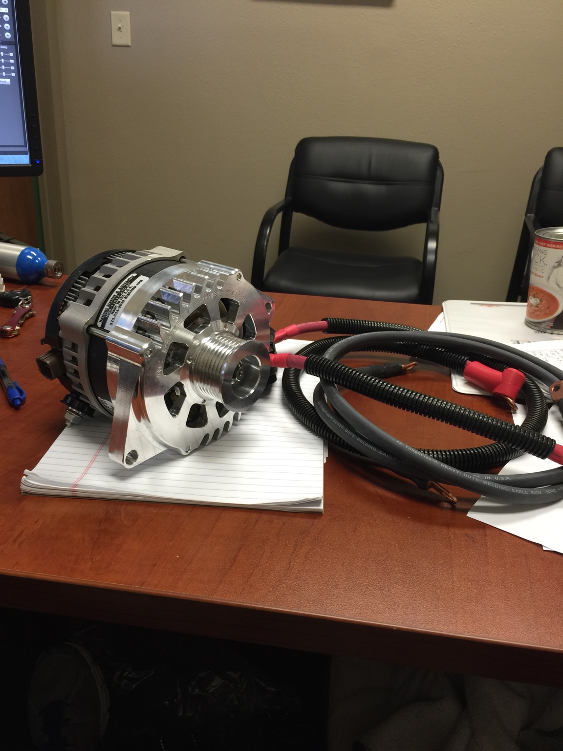

Hi [MENTION=144249]SFNMRunner[/MENTION],
I've already spoken to the CSR, Holly about that fitment issue. Here's the Model# for the GEN-5 4Runner: NSA-11517-270XP The Phone# is: 573-334-2632 You can speak to Holly or Adam and you'll be very satisfied with the way they handle your order!

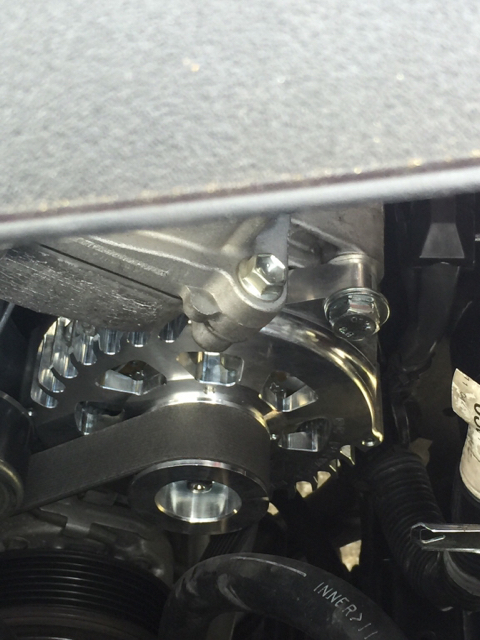

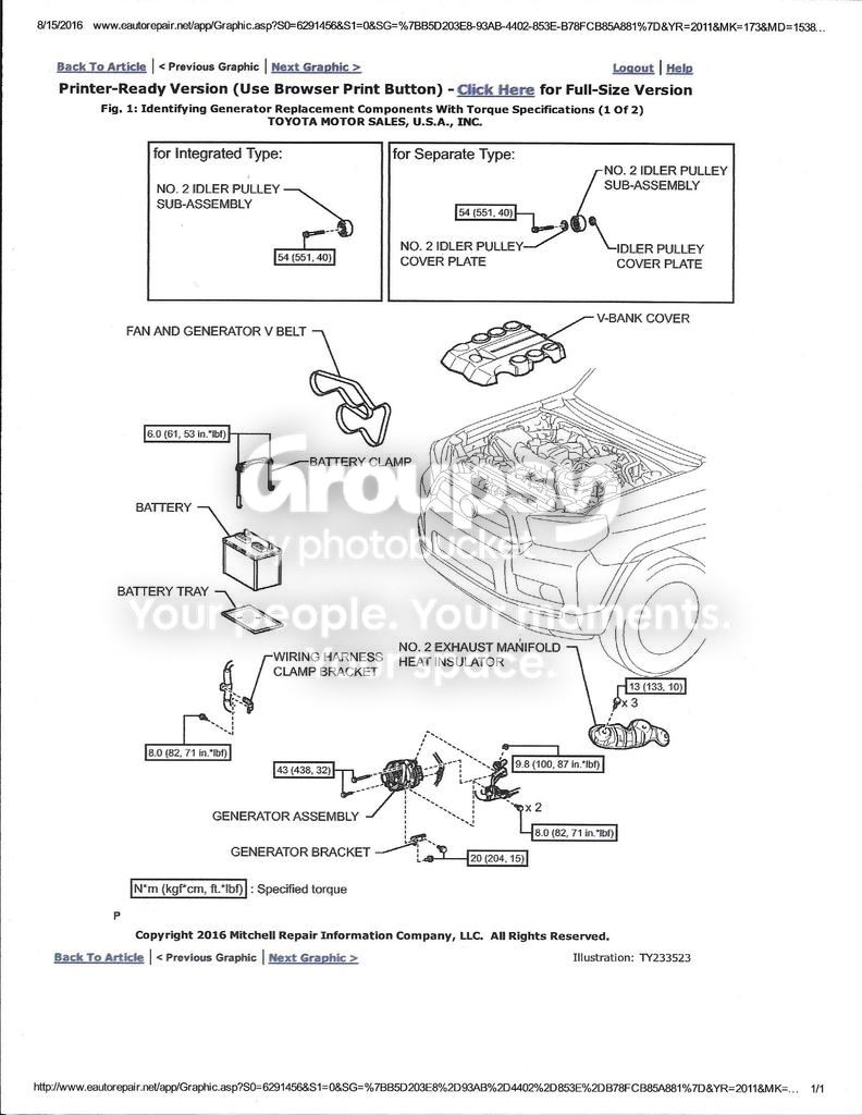

I thought that it might be helpful to those of you who will be installing the new 270-XP's in the very near future, so I'm putting up a few help sheets to make finding the GEN-5 alternator bolt location and other generator related intel a little easier; "See below":
There are three bolts that anchor the alternator to the engine; the two up top that go through the 'ears' on the frame, but then there's the third bolt underneath which is impossible to see from up top. For that one you'll have to turn the wheel and get at it through the left front wheelwell using a long ratchet extension! This job may take two to three hours depending on your tools, the space that you're working with, and your own comfort level with the truck!
Above is a picture of that bastard bolt through the bracket which anchors to the exhaust manifold! Just remove it and throw it away; there's no provision for it in your new 270-XP, it's just not necessary!

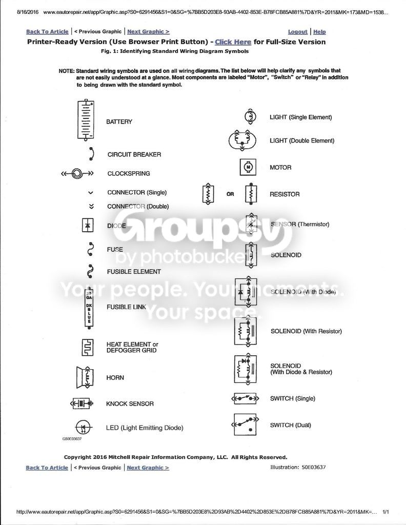

Hey folks,
Here, I'm posting an Electrical Symbol guide! I realize that some of you are just being introduced to the auto-electrical field due to so many mods and opportunities that have become available now. So I want to provide any tools that I find helpful to you so you won't become squeamish or start to shy away from the electrical aspect of working on your trucks! Please allow me to be the first to tell you... you need never be intimidated or afraid of electrical systems; only respect it because if you become careless, electricity can do damage to the equipment, the wiring, and if the voltage is high enough it can ruin your day... ask me how I know lol! Here are some standard electrical symbols for you to familiarize yourself with so when you look at some of these wiring diagrams that are floating around this forum, you won't be alarmed at their (sometimes) complexity:
rig, 'Best!
