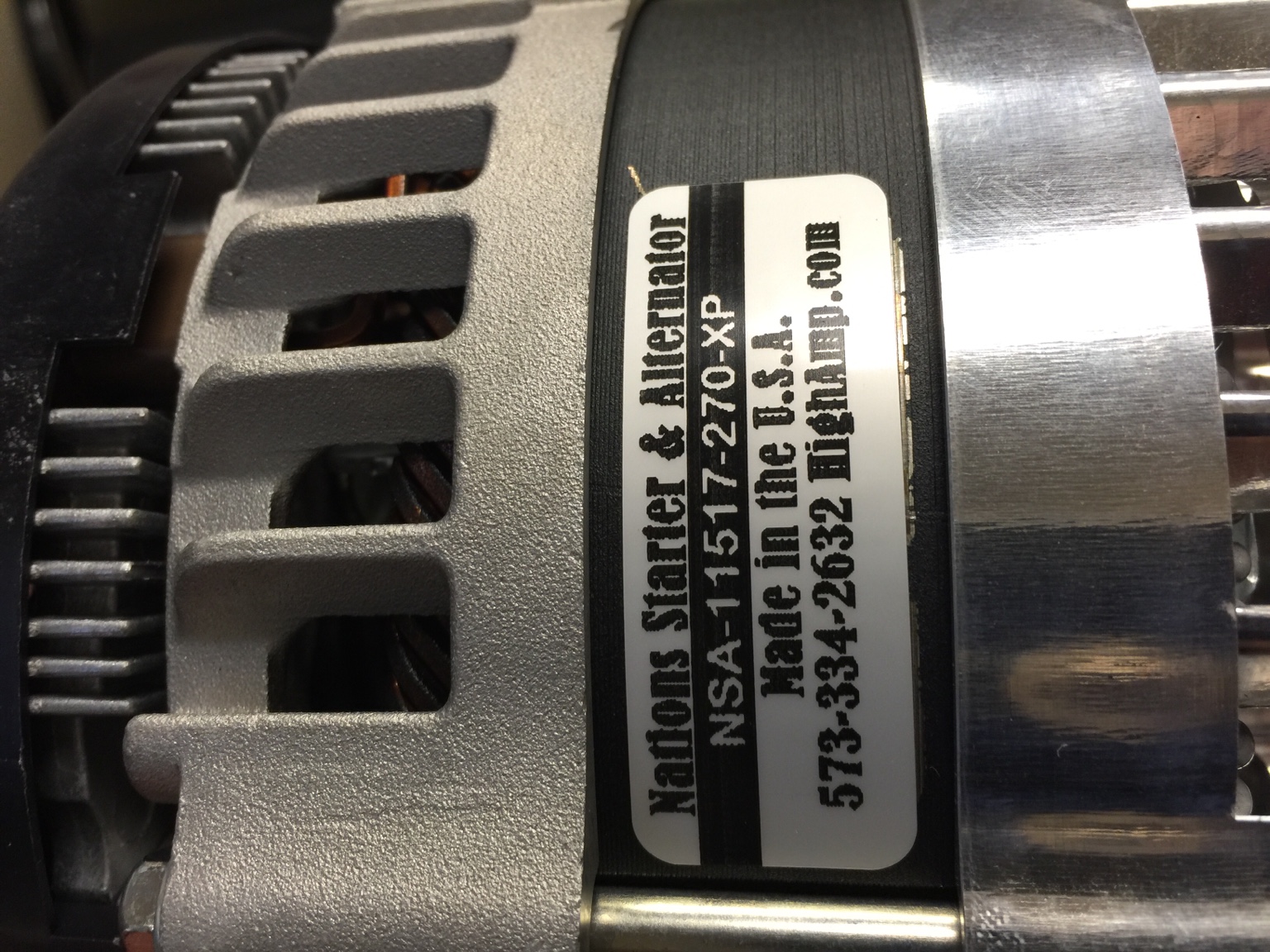

This is my alternator pictured below:

I neglected to mention one important detail about the 270-XP. You can order yours with an 'adjustable external voltage regulator'; but this has to be done at the manufacturer's facility, not a 'plug-&-play' add-on! My internal regulator is set @14V which is what I've wanted; especially with the "Odyssey extreme" AGM 900 CCA, 125 min res battery! But some here may have concerns about battery life span, or having ECU issues (which shouldn't be a concern because the alternator is ecu compliant/compatible)...and mine has been in for two years w/o issue! Rgds!
Thanks to [MENTION=83083]rigtec[/MENTION] my 270xp will be here in two days! He went above and beyond helping me out to ensure I got exactly the right alternator and even called a vendor on my behalf. I owe you a solid brother! Thanks again
Thanks Adam,
...But no favors asked except to keep us posted when you do receive your 270! The c/s person 'Holly' told me that they are now stocking the NSA-11517-270XP because of our communication (T4R.org) with them and the time we spent to explain to them the problem that they had with their fitment catalog; only going up to the 2009 4Runner. Apparently they weren't aware of the problem so they're going to make some changes because of our huge forum community... perhaps in the future, we can work-out a 'Group buy' of some sort; as a matter of fact I know we can if enough of us show an interest in ordering them.
I seem to have struck up a "friendship" with them because I spoke so highly of them and their products while on the phone earlier today(I've been extremely satisfied with mine over the last two years), so... who knows! I'm so glad things worked out so well for you [MENTION=133836]adam.friedman.33[/MENTION] . I had to wait about seven weeks for them to build mine cuz they're made to order; or they were before now lol!
Cheers!

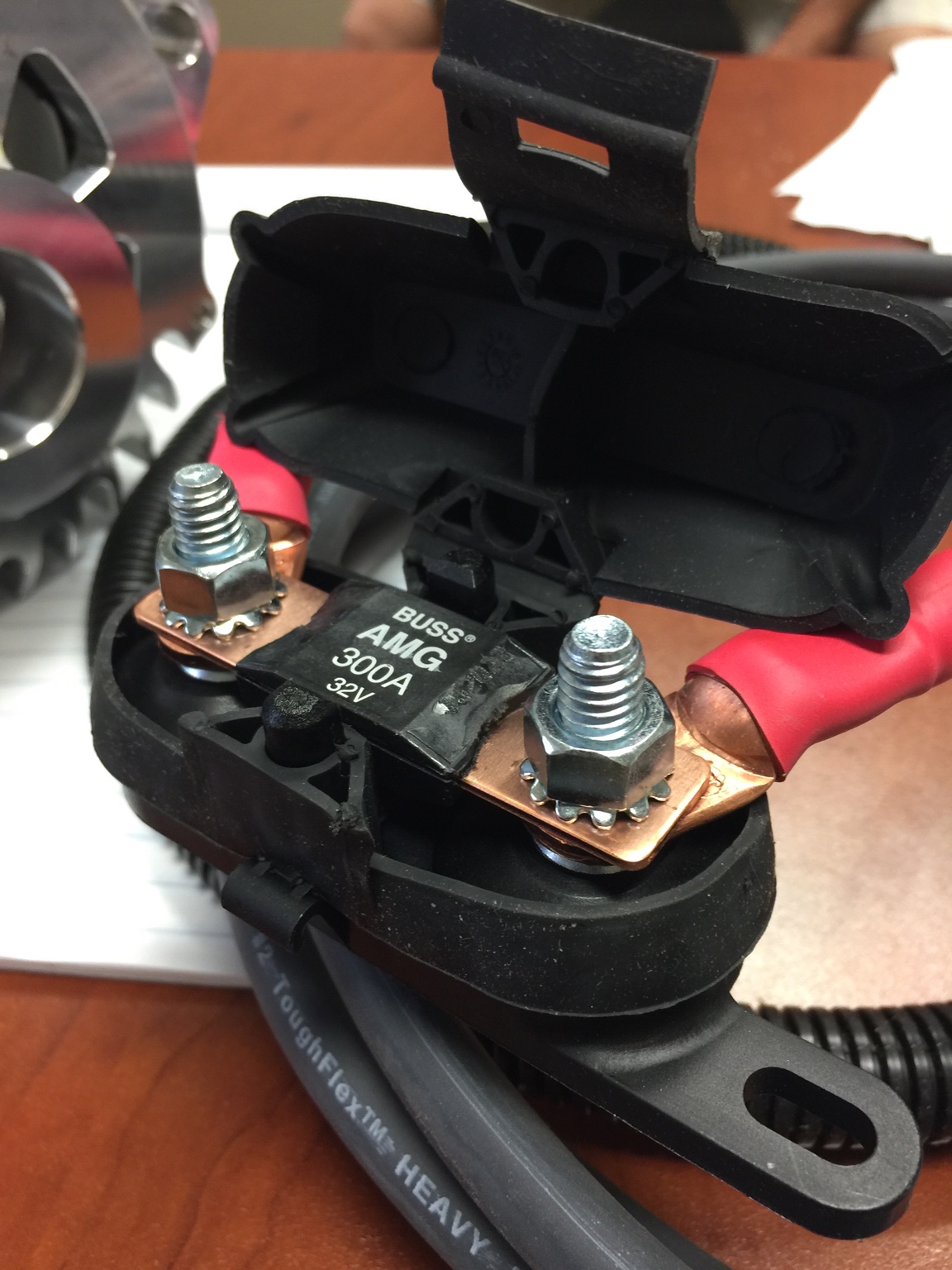

Hi Adam,
You're doing things the The RIGHT way! Myself (OTOH) discovered that I needed a generator upgrade after seeing the symptoms of an alternator that just couldn't keep up e.g. headlight pulsation, temperature control blower and wiper motors slowing down...etc. I'm very much looking fwd to seeing (reading about) your finished product!
Because you're adding approximately 100A to your existing main electrical system cables, I would strongly recommend adding an additional (POS) Alternator output (B+ term) to positive battery terminal post and (NEG) battery cables; main negative battery post to body, and an engine to body cable:
rigtec-albums-%26quot%3Bgentilmen+prefer+redheads%26quot%3B-picture26784-all-cell-pix-june-2014-012.jpg
The dotted lines represent the existing factory cables, which I've left in place. The solid lines illustrate the new, heavier 4ga cables that were installed.
Don't worry about the body to frame (chassis) cable; there will be no additional or excessive loads added to that circuit!
'Best to you'!
