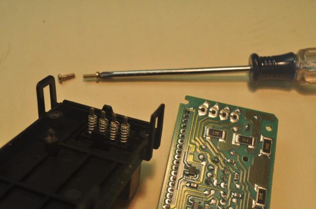

Solved: 3rd generation Toyota 4Runner digital clock repair DIY (aka tooth surgery)
Standing on your shoulders, I rewired my digital clock circuit board and wrote up a DIY with diagnostic, removal, and rewiring details as payback for your help, and so everyone benefits from all our efforts.
Please let me know what you think of it:
- Solved: 3rd generation Toyota 4Runner digital clock repair DIY
