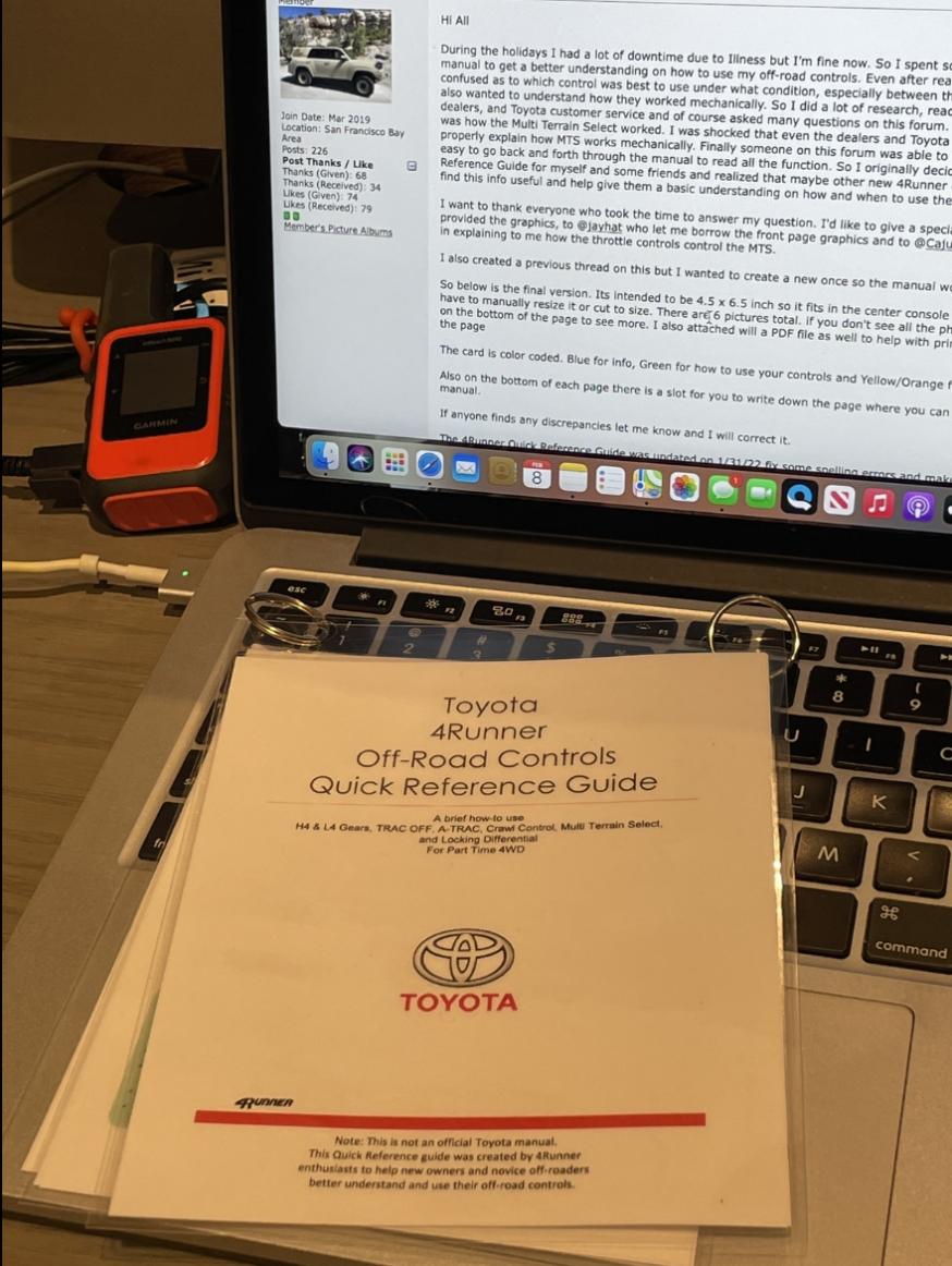

Thank you! I copied, reduced and laminated the guide. I'll keep in my side door pocket for quick reference!

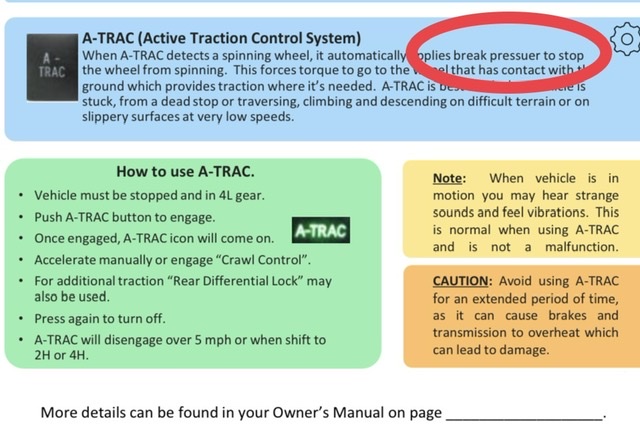

Still need to run a spell check. “Break pressuer”
Someone else had already reported it and I already made the correction but it looks like I uploaded the wrong file by mistake. Sorry about that. I’ll fix this later today. Thanks for letting me know.
I’m glad you liked it. The PDF files are much smaller if you want it to fit your center console or glove compartment. Many printers by default will automatically adjust the size to fit a 8-1/2 x 11 paper. You may have to manually uncheck that in your printer preview setting to print the original size. I put the actual size description in the original links. There are two sizes. The one that is 4.8 x 6.5 is designed to fit the tissue holder slot in the center console or the case for for your manuals that are in the glove compartment. I figured this size would be more handy to keep in your car.

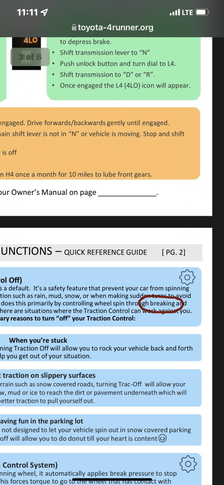

Also look for “breaks”. Should be “brakes”. Otherwise, good job. :thumb:
Perfect is the enemy of good. ;). Nicely done! You put alot of effort into this.
I see what I did. I updated the PDF but not the pictures. Anyway I made a slight revision to the Trac-Off. Everything should be good now. Let me know if you find anything else.
The 2 versions posted as of about 1030 EST 10 Feb have breaking in the TRAC section. Should be braking.
