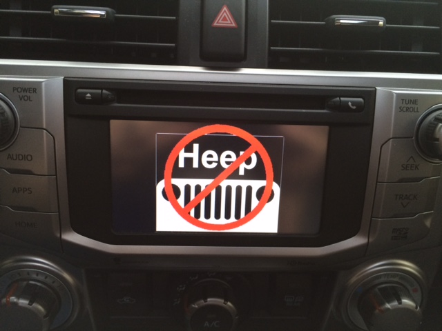

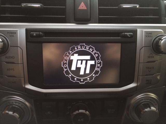

I redid my No_Heep image, and did a T4R.ORG Badge image
The No_Heep is included for your copying pleasure!

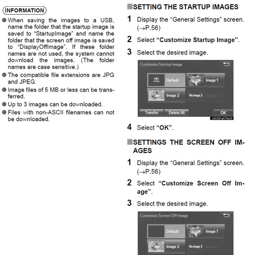

Refer to post 44 for instructions found "In the Manual"!
Hope this helps

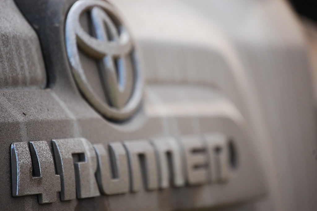

Good info. I had to select "transfer" a few times to get it to take, but it did. I used the same image (saved in two different folders) for my startup and off screens:
If anyone wants it, I took the shot so feel free to use it:
